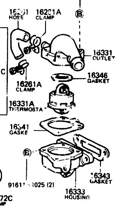

My cruiser temp gauge would barely get above the C when I first got it. The thermostat was bad. As a result, the heater could barely put out hot air. I replaced the thermostat and after that my truck got up to “normal” operating temperature and the heater worked much better.
Replacing the thermostat was much easier than the water pump, so you guys should be able to manage it fine. I did break one of the 4 studs that hold the thermostat housing together. I think this is fairly common due to the studs getting a bit corroded over time. So be careful there and consider just buying new ones ahead of time.
This just sounds like a big air pocket with a case of MOTS (MUD Over Thinking Syndrome). I would echo to replace the thermostat if condition is unknown. Make sure to get/install the rubber gasket that sits on top of it which seals it against the upper thermostat housing.
