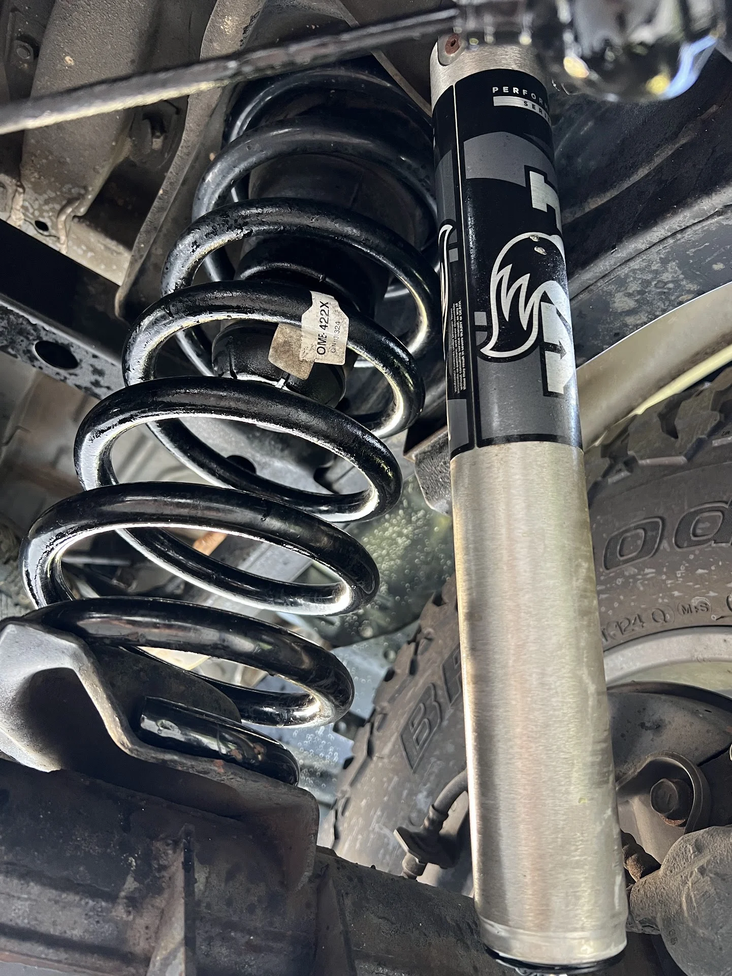

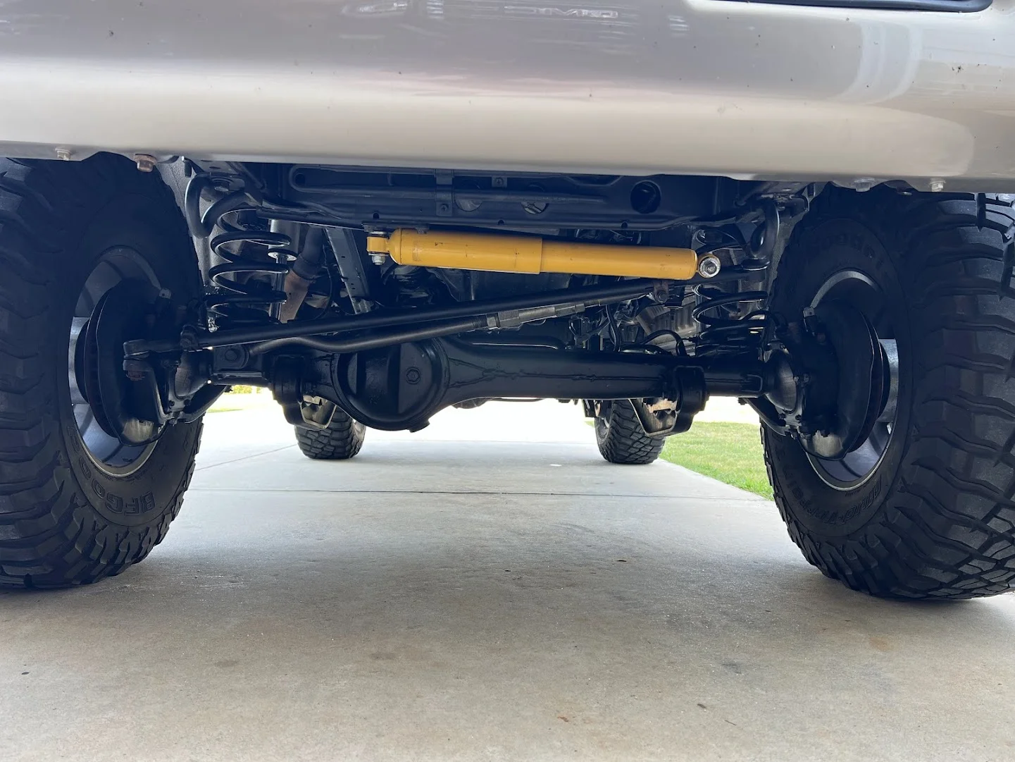

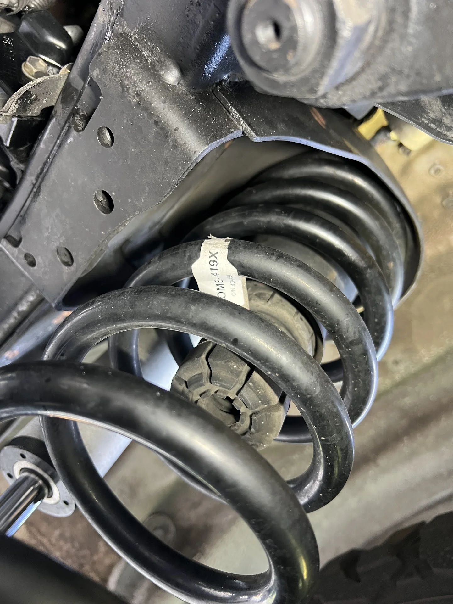

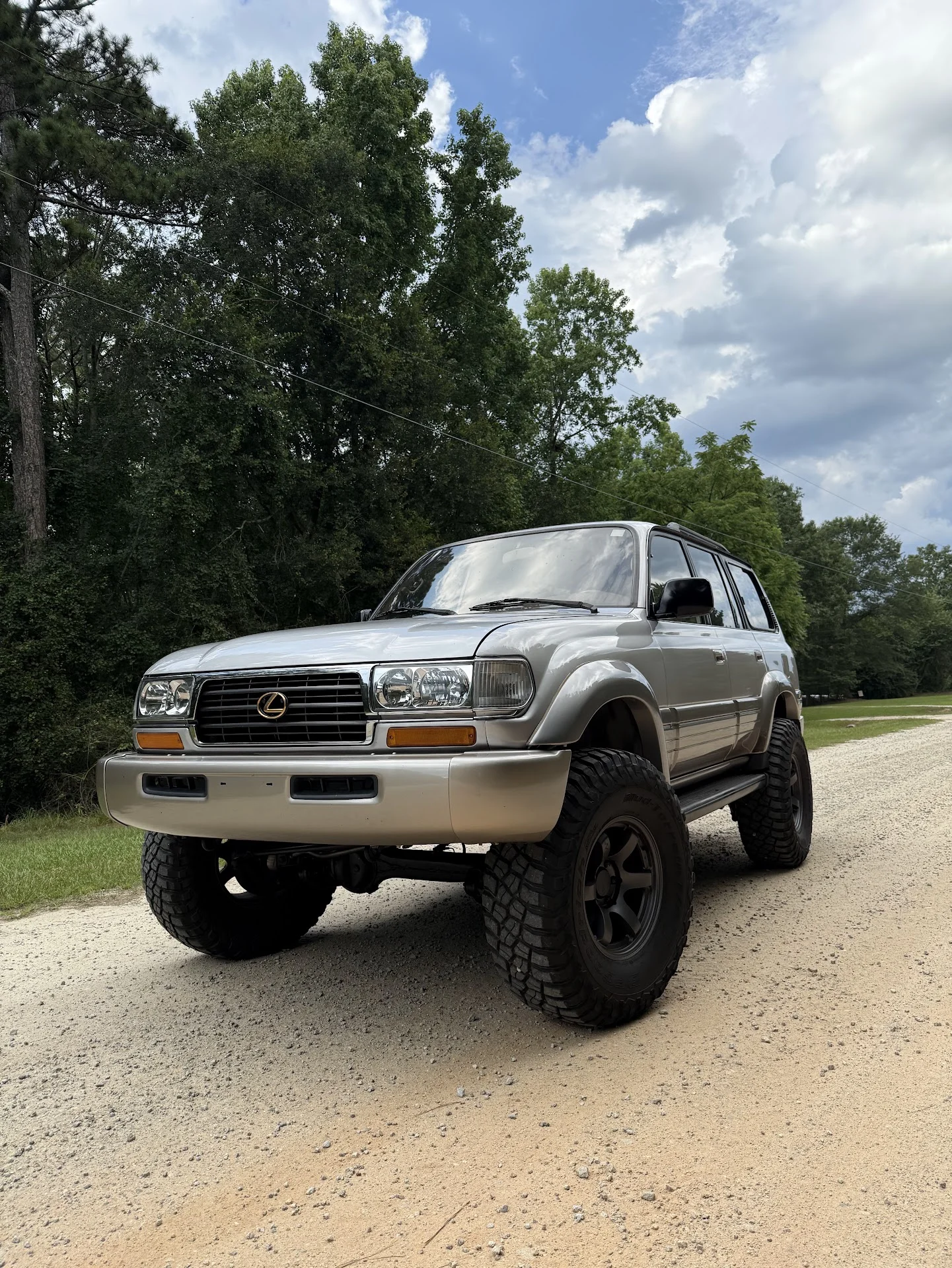

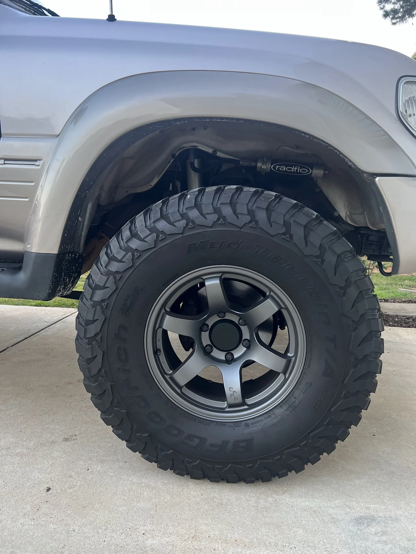

I purchased a beautiful 96 LX450 and have been enjoying every minute of it! It came with a 4" lift and 37s KM3s. While it looks cool, it's not practical for our use (98% on road). I'm looking at lowering it to 2-3" lift and 35s on OEM wheels. However, I would consider other options as well. I just need a better understanding of what I currently have, and what could stay and/or work. I've read several threads about upgrading, but not necessarily down sizing.
Currently Installed (from my inspection as no receipts were provided during purchase):
BFGOODRICH® Mud-Terrain T/A KM3 37x12.50R17/D 124Q
Circuit Offroad Steller Matte Gunmetal 17×8.5 6×139.7, -10mm Offset, 4.36 Backspace
2in Wheel Spacers (unable to find brand/link)
OME 419X Front (100mm / 4in)
OME 422X Rear (100mm / 4in)
Radflo OE Replacement 2.5 Front With Remote Reservoir
Fox 2.0 Performance Series Smooth Body IFP Shocks - Rear
Front Radius Arm drop brackets (uncertain if correct brand)

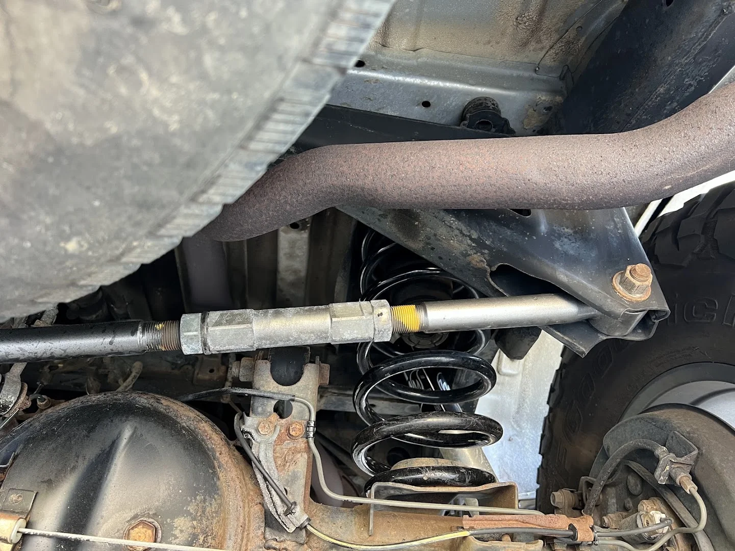

Front & Rear Adjustable Panhard Bar (unable to find brand/link)
Front Swaybar Drop Bracket (unable to find brand/link)
OME Steering Damper
Questions:
What 2-3" springs should I buy? (We will rarely be underload, no plan of future armor)
What equipment will need to be removed when lowering, if any?
Can I remove that 2in Wheel Spacer now and not rub? What about when lowering? (I hate that it's on there, rubs now in reverse on pass side)
If I lower before finding a set of OEM wheels, will the 37s fit without cutting? What about 35s on the current wheels?
Thank you in advance!

  • My measurements on all 4 corners are around 25.5-26in from hub to fender. From my understanding that's around a 5in lift.

It looks to me like everything that is currently installed could be retained. If it was my truck I'd start here:
  1. Select the springs you want based on your target ride height.
  2. Select the wheels and tires you want.
  3. Purchase and mount the wheels and tires you want.
  4. Install the springs.
  5. Adjust the panhard bars (track bars) to center the axles at the new ride height.
  6. Adjust the drag link to center the steering wheel at the new ride height.
  7. Test drive.
  8. Measure new castor angle at the new ride height. If your castor correction radius arm drop brackets are 2" drop then they are not enough castor correction for your 5" lift, but they are perfect for a 2-3" lift. You may find that the truck works great and has perfect castor after you lower it.
  9. Edit to add: loosen and re-torque suspension radius arm frame side bushing bolts and rear control arm bolts at the new ride height, rubber bushings twist and torque throughout the suspension travel and should be "zeroed" at ride height by torquing the bolts are ride height.
Most of the mods don't need to be undone, the last suspension installer didn't really go far enough with the corrections for how tall they lifted it.

This is fantastic information! I ended up with the 3” Dobinson Flexi Coil (C59-612V and 613V).
For the panhards, is there a proper way to measure? From the looks of it, it looks to be correct after the drop.
Couple things that are good notes are the drag links and radius arms. I’ll take a look at those this weekend.
Cheers!
For panhard adjustment, measure from the wheel or tire to a reference on the body or frame on both left and right sides and center the axle under the truck. It’s not critical that they’re perfect. Measure at ride height after the coils settle in (after a test drive).
