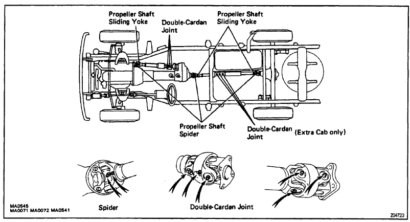

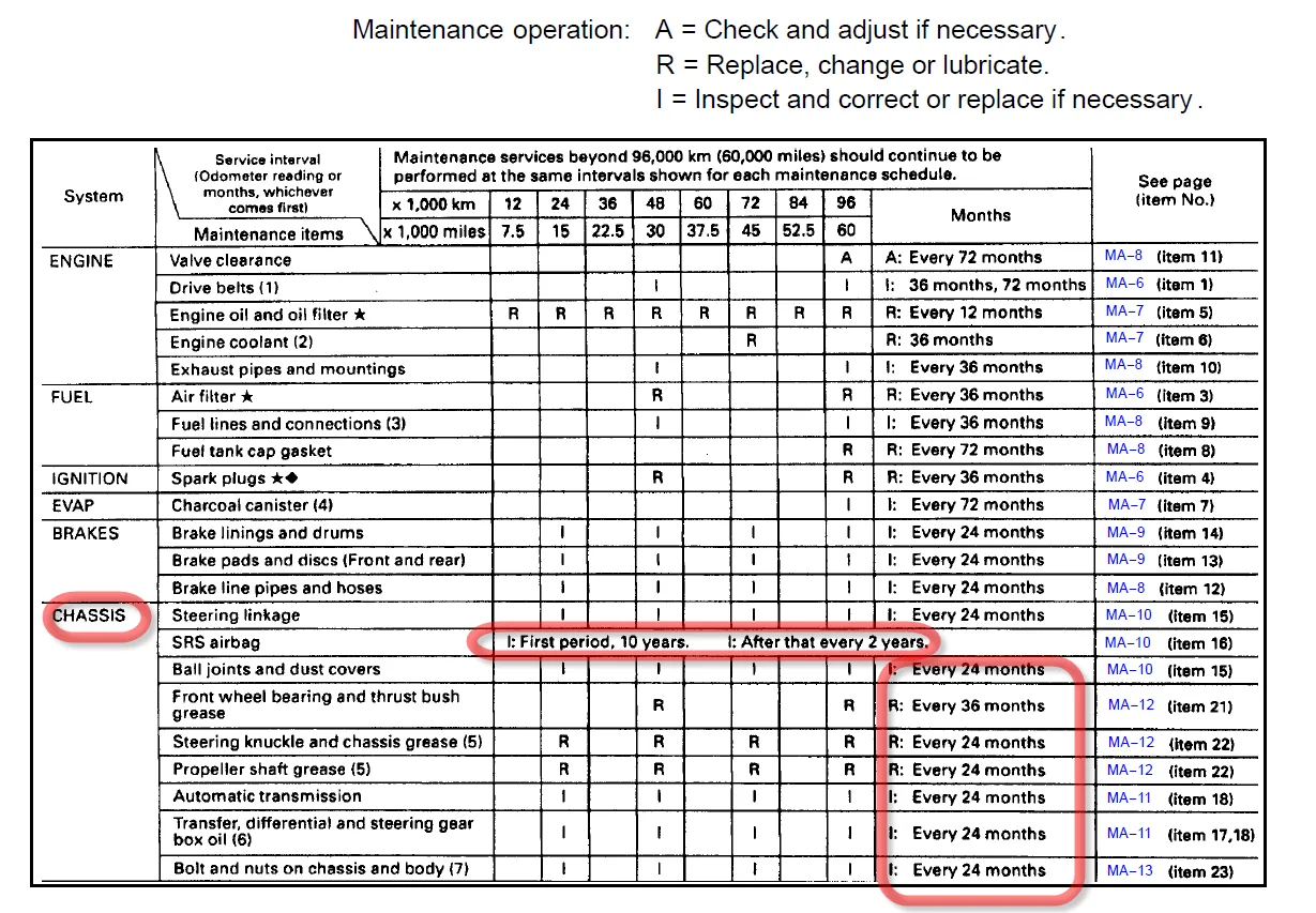

Hi all, I did a quick search and checked the FAQ thread, and perhaps I've missed it.. but is there a thread or guide about maintenance pertaining to checking, greasing, retorquing the suspension/chassis/drivetrain components?
So far, all I have is greasing/lubricating the propellor shaft and checking the steering linake for from the FSM.
Lubricate all grease fittings:
  • Sliding yoke
  • U-joints
  • Double–Cardan joint (moly grease)
What does everyone here do? I have so far, replaced my steering damper and swaybar mount bushes. One of my swaybar end links look like it might be on borrowed time too (one of the boots looks like it may be leaking grease). Is there any way to test these before going to the expense of replacing them? Car has only 151,000km on the odometer.
I want to ensure I check, tighten and lubricate all necessary steering, suspension and chassis components at determined intervals.
It looks like dad had some grease nipples tapped into the rear shock absorbers too. I am yet to attempt to pump any grease into those. It looks like he's been doing the front propellor shaft as I can see the excess grease has flown up onto parts of the underbody.

Pete, the 80 doesn't require anything other than what's listed in the manual, but age has an effect on rubber components that isn't listed in the manual's service intervals. Remember, it was written for dealership service during the model's life. That's why the service intervals stop at 60,000 miles.
You're about at the service interval for replacing the sliding yoke seal on the propeller shaft. Overfilling the yoke can cause this seal to fail. If you repalce it, don't fill it until after you install the shaft, or you won't get it in (the grease will cause the yoke slide outward).

  • Sliding yoke
  • U-joints
For the sliding yokes ive always used castrol LMM moly - i'd recommend removing the shafts and cleaning all of the old grease from the internals of the slip joint if you do not know what has been used previously (be sure to mark the splines with paint before separating). My reason for cleaning the old stuff is some greases do not mix and can harden up and cause excessive binding
U-joints - ive always used Castrol HTB
I use 2 grease guns for this as its more convenient rather than swapping over etc and making a mess :)
Double - cardan - mine doesnt have one - are you sure yours has one as the image posted shows wishbone suspension parts at the front?
Double - cardan - mine doesnt have one - are you sure yours has one as the image posted shows wishbbone suspension parts at the front?
