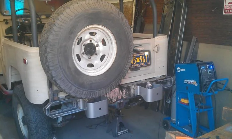

you will likely not be disappointed, they are great little machines. i have had mine a few years now and pretty much built this 40 with it. i weld for a living and found the auto set to be spot on in it's settings. so much so that it's all i use, i dont even bother trying to fine tune the settings because you just do not need to, its that good.
now i have not messed around with running it on 110v so i do not know how it runs on that voltage, but 220v is more than enough fire for it.
75/25 gas with .030 er70 wire and it's good to go from 16ga sheet metal to 1/4" and beyond.
I got mine a few years ago for $900 which you can still do if you shop around and combine that with Millers 10% rebate. $1,375 is too much unless its coming with a bunch of accessories like cart and spoolgun.
I have run both flux core and solid wire through it and am very happy with it.

Brian .. you made that blue cart .?
no, no i did not.
Where did you get it at?
I love my M211. I got it for similar reason, no 220 currently but works great on 110 for misc stuff I have been fiddling with. I got the Miller bolt together cart, but I would much rather have something similar to the one you have.
I have been using flux core .030 wire and have been pretty pleased with it so far. I want to get a small tank to see how I can do with solid wire.
