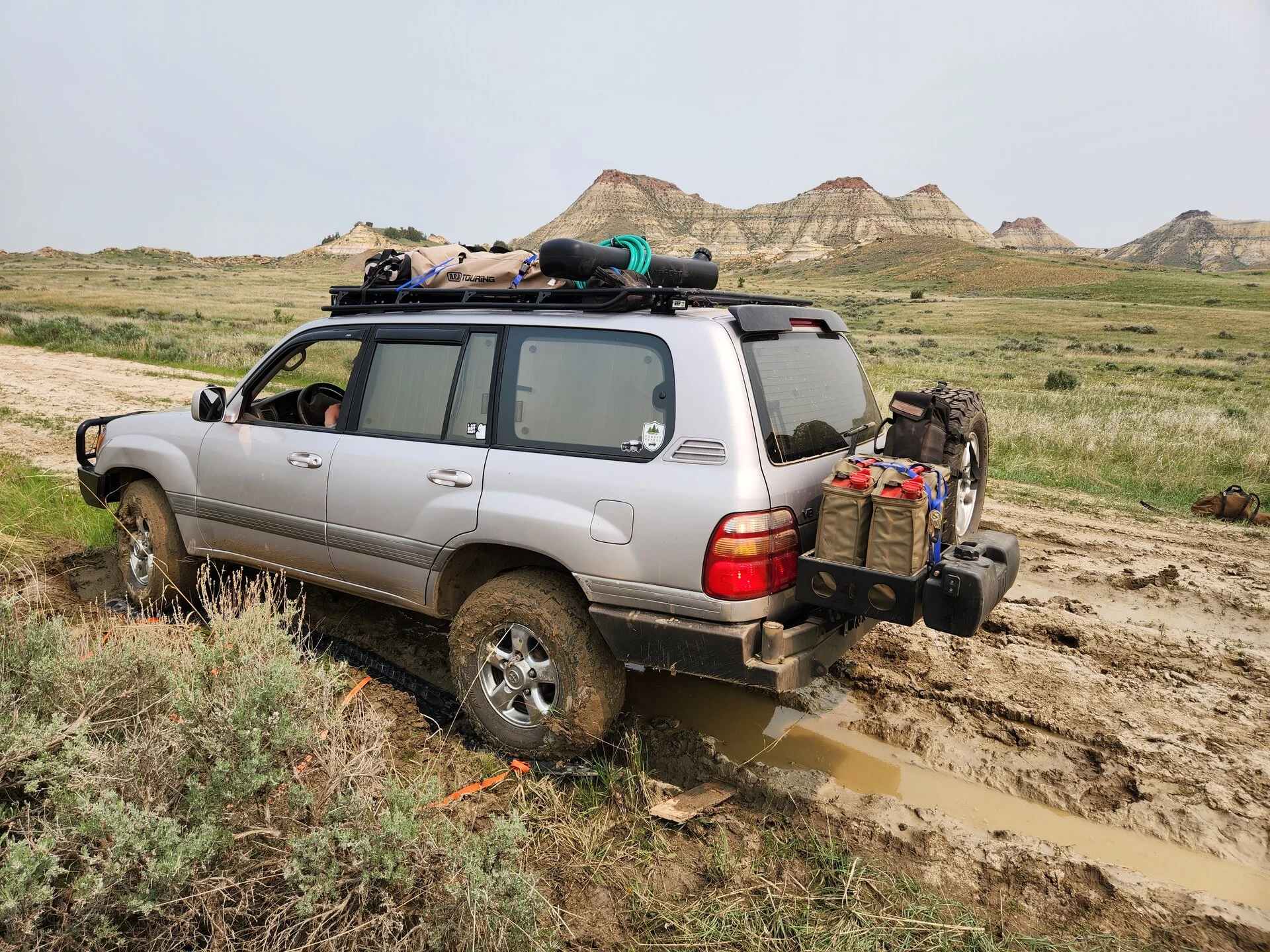

Looking at your picture, I don't like the additional weight you have overhanging the rear with the jerry cans.
If yuo always use them, better look at adding a long range tank which sits under the car, lowering ceter of gravity as well.

I agree with your remark about the tank hanging off the backside, I'm thinking of just relying on the tank on the roof and refilling when possible. The tank out back on the swing out holds about 4 gallons of water ~ approx 33lbs...... Add that with approx 9 gallons of fuel ( 2 jerrys filled almost all the way ) so another 55-60 lbs. I don't always run with extra fuel but I do always have the water tanks on the rear and roof
