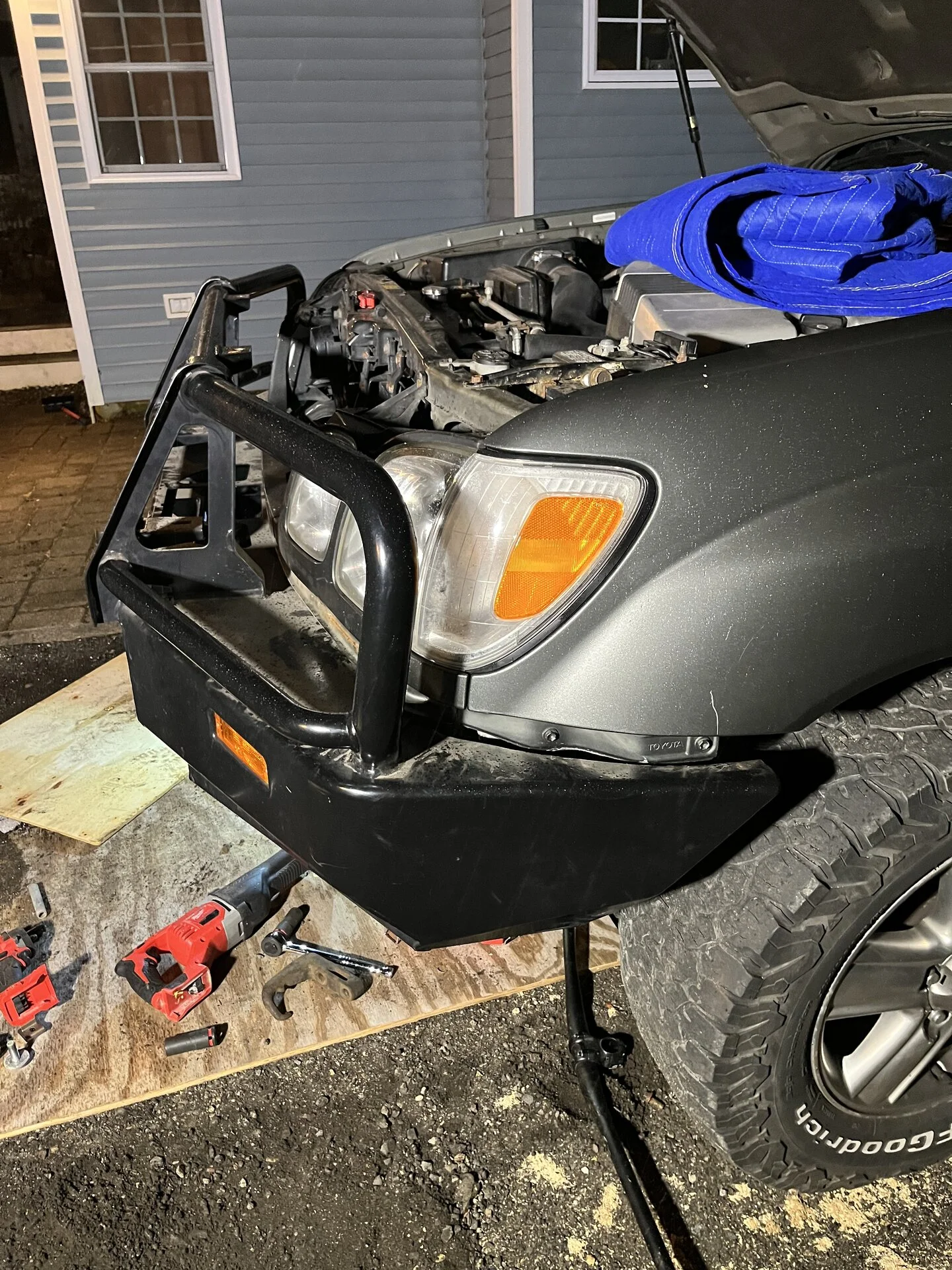

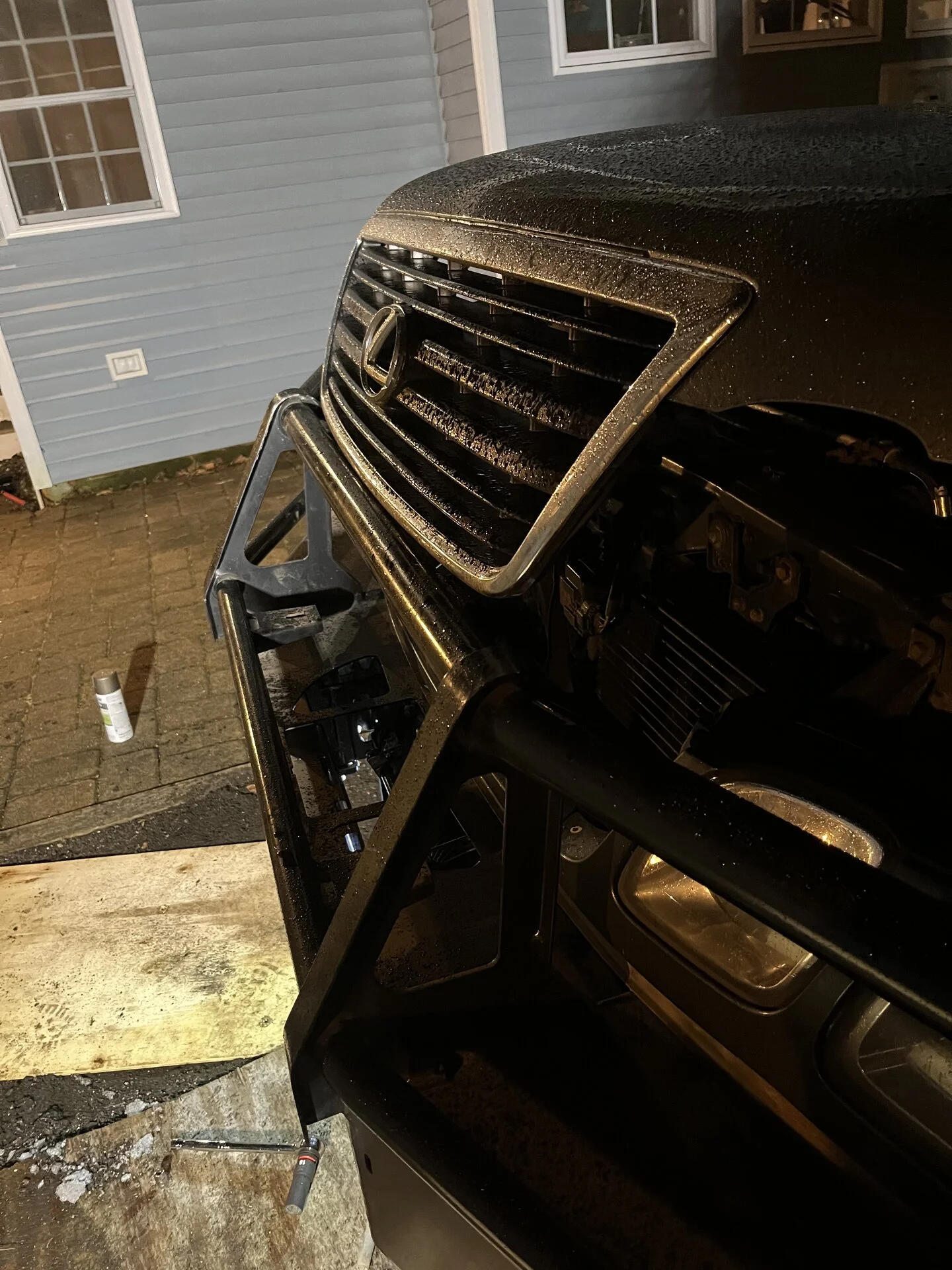

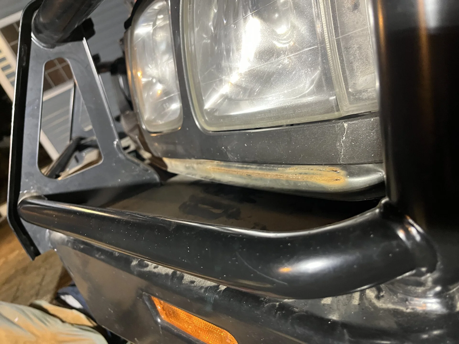

Hi! I just got a lx470 a few weeks ago. First thing I tried to do is install an Arb bumper. I’ve read I think every thread on here of people successfully installing arbs on lx470s and I’m confused what I am doing so wrong. I am aware the light tabs need to be cut for the hood to close but the hood is getting caught on the bull bar once every bolt is lined up. There is so much body gap. There is metal/body under the headlights between them that is unmentioned in every persons install I’ve read and watched. The bumper is physically unable to get up higher because it gets caught on the metal. Attached are some photos. Please cruiser experts help me!! I bought this bumper off a guy who was parting out his 100 series so I don’t have a manual either which doesn’t help. :./
Did you get the type that sits on a cradle that mounts to the frame or the kind that mounts right to the frame (frame horn trimming required)?
From the parking lights, w/o fog lights, I’d bet early model “cradle”..
Can the bumper tilt at all? It looks to me like the gap is bigger at the back of the fender. If the bumper can rotate a bit to close that gap then the top of the bullbars should move away from the hood.

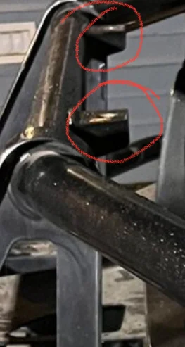

The upper “antenna tabs”, that interfere with the LX grill, seem to still be there?
your truck probably has a 1" body lift on it. if it does, you'll need to re-tool the mounting brackets
No 1 inch body lift. AHC removed and emu 1.5 lift
Edited as you have done everything I could recommend. I've only seen 03+ ARB's mounted to LX's, never the 98-02 Bar. I hope you get it sorted.
I have determined it doesn’t work at all. defeated, and factory bumper is back on. I’m going to probably order the 03+ one but I can not figure out the difference of that one between the 98-03 other than the lights.

03+ indeed sits higher, also bend the grill brackets back to clear the antenna tabs.
