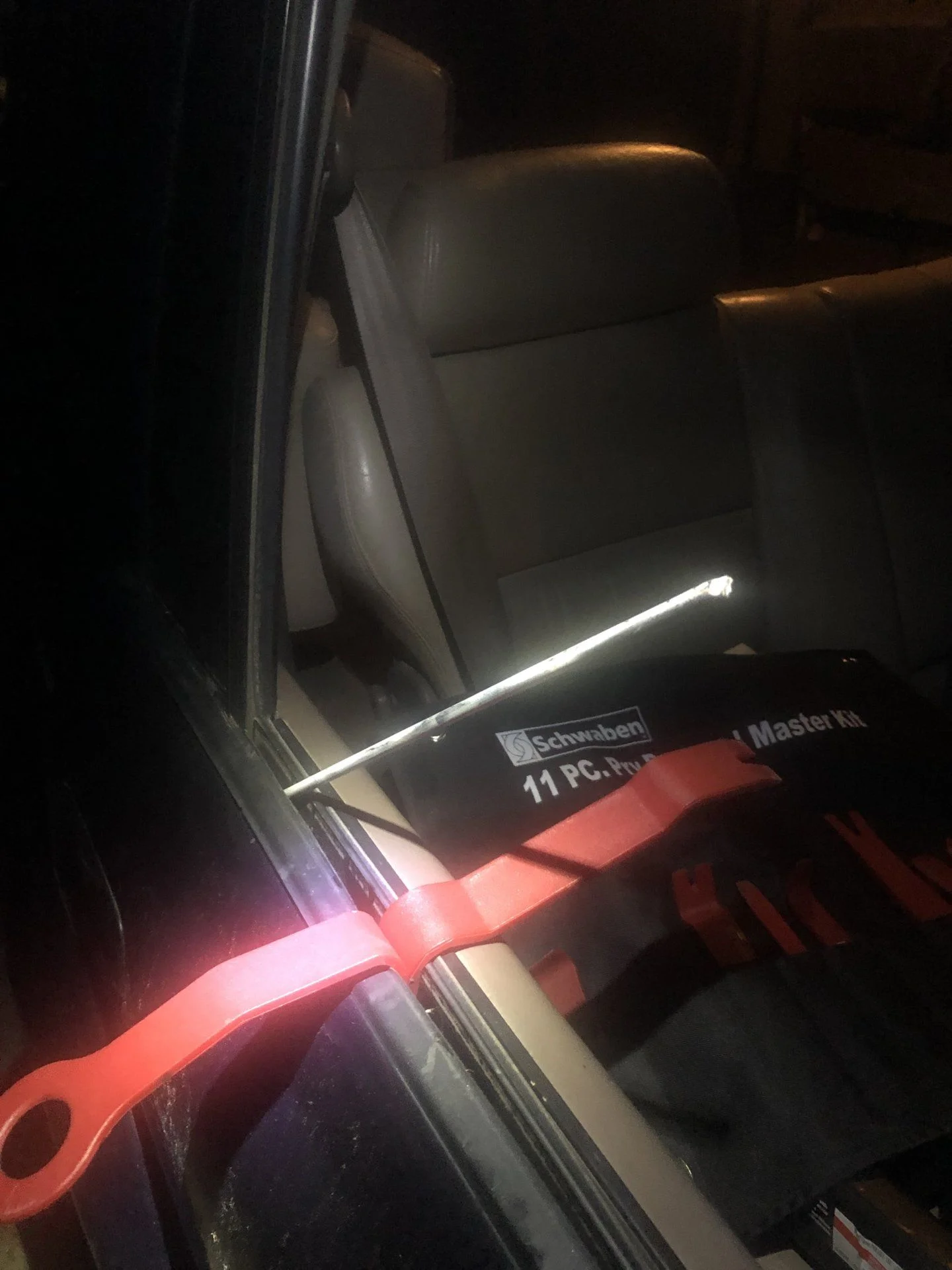

Tools needed for this task:
Panel pry tools, though 1” putty knife will suffice
2 feet of 1/4” round rod, available at any home repair store
Lower window and wedge a gap between exterior window seal and window. You will not need more than 1/4”.

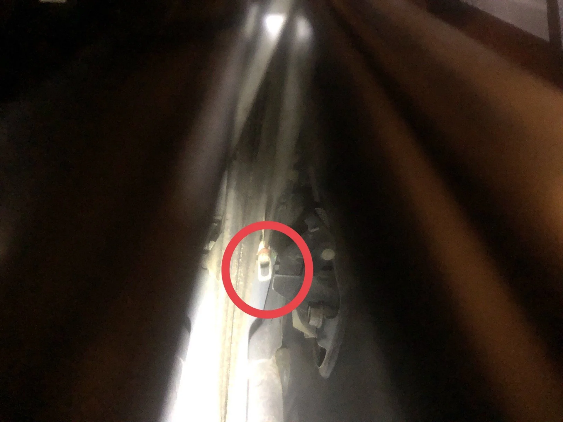

Looking into the newly created gap, shine flashlight into the gap, illuminating the back, or inside portion of the door handle assembly.
Feed the 1/4” rod into the gap and direct it into contact with the latch linkage. The rod will feed in at roughly 45° angle as seen in the picture above.
1979111
Once in contact with the latch linkage, gently push down. Click, door is open.
