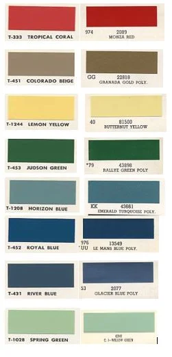

That's a cool color. When doing my research on Toyota colors, I found that they used the same basic color pallet from the USA cars of the same era. I have cheated in the past when unable to find a color mix, I go with American version and its way easier to find.
Example below: Left Column is Toyota, right is American. Some are closer than others. I cheated on my 1976 Spring Green rig, and used the General Motors version and mix... I thought it actually looked better... :)

It's interesting to note that to my eye, all the Toyota colors have a touch more yellow in them than the GM alternatives. The Toyota yellow is more saturated, and the other colors are a bit more muted by the additional yellow in them compared to the GM colors.

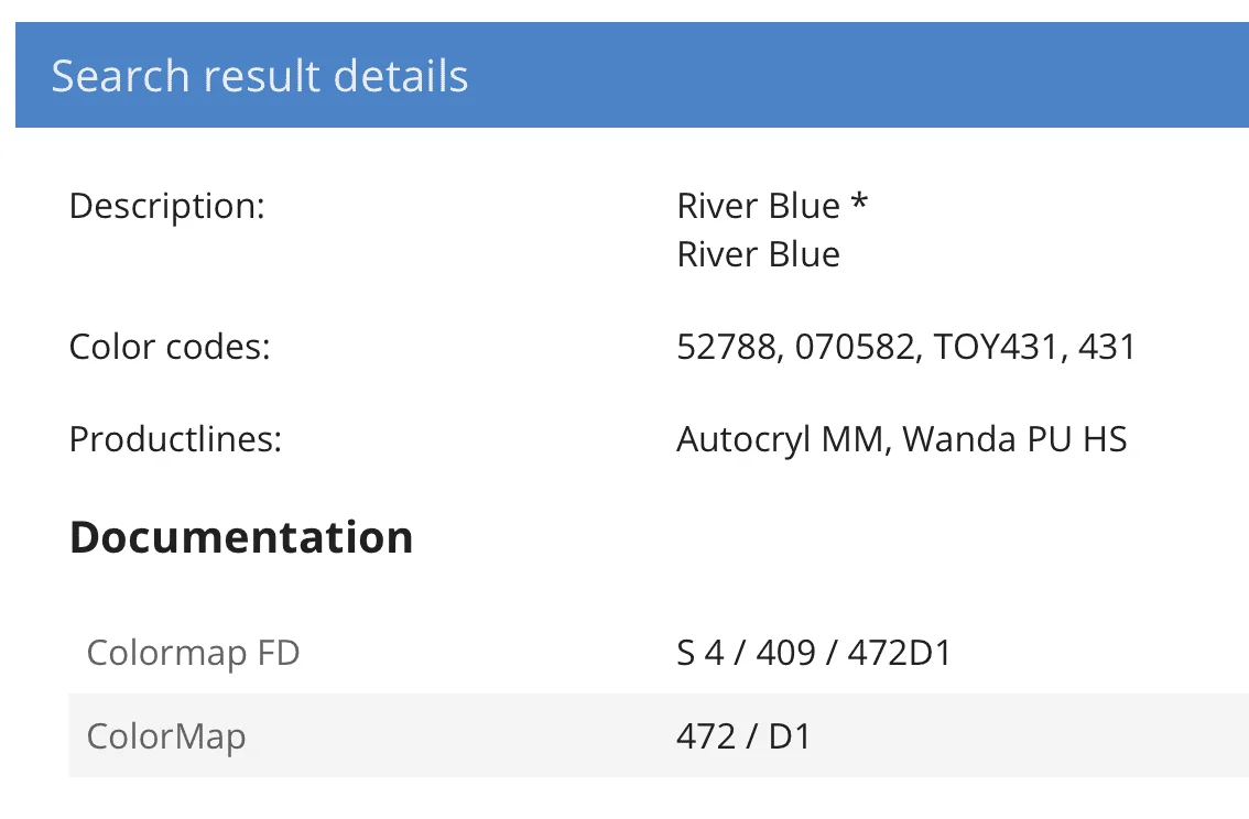

After visiting the jobber with my wife today, we narrowed in on a better match to what we think we were looking for. And then the owner came by, and noticed that my printed notes had a Toyota paint code. He said that most old codes don't come up in his computer cross references, but gave it a try anyway. And when he punched it in, the answer was "River Blue, Toyota, '64-65". It referenced a slightly different chip in the color book than we had gone to, but that chip looked even better to us, so we went with it. Will probably not have anything to show until next week. But I have high hopes.

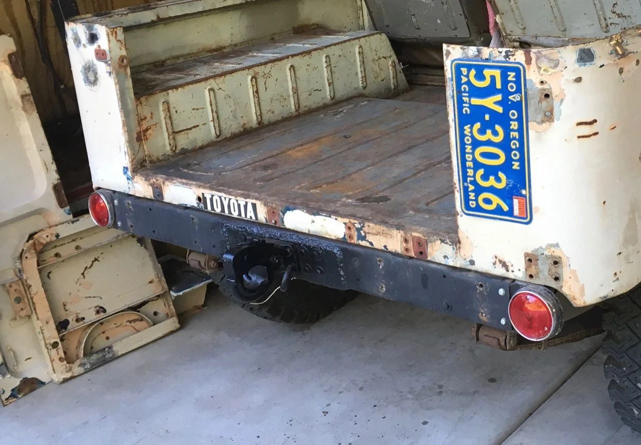

Finally! This has bugged me since the day I bought the rig. Still have to get it all attached, but that's minor. Kevin's work (@Awl_TEQ) is fantastic!
Before:
After:
You plan on riveting or bolting that bad boy on?
After thinking about this new frame rail a bit, I think this may be even more significant an accomplishment than I first thought. I believe this is the last of the fixes for all the indignities the original owner inflicted on this truck. It might be all downhill from here.
I’m interested in what you find and use. @65swb45 has mentioned button head screws iirc in another post. I’ve been looking but haven’t committed. I definitely need load bearing, that rear rail probably does also especially if towing. I don’t like the square plug going into round hole in steel, maybe ok structurally?
I looked at button head, but didn't want to have to fill an Allen or torx head before painting. Easier to smooth the head of a carriage bolt. I used a triangle file to square up the holes a bit for a better fit.

Yes, it is. Kevin's part is the only one I found with the recesses in the top where the rivets go. All the holes are exactly where they should be, and the ones that had captive nuts originally have them in his part as well, with correct metric threads. Much heavier gauge metal, too.
Wow, I didn’t even know this part existed.
As if the quality of the part wasn’t news enough, there’s more!
I think it is safe to say you have found the bottom of the rabbit hole! Your chances of seeing daylight again are now much more certain.
It didn't exist until now. I reached out to Kevin and provided copious amounts of measurements, he did the magic. Now that the first one has been field tested, he can turn these out on demand. This one is correct for '61-67. He should have most of what is needed to do the '68-only and '69-73 rear rails too. Contact him about those.
