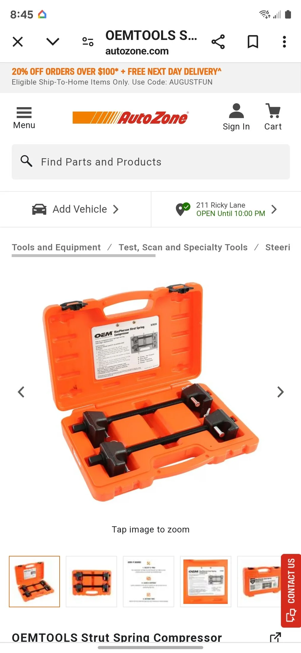

If you're just talking springs a couple of hours with a helper. Strut compressor tool from orielly makes it easy. I also have a lift.
Strut compressor for working on an '80?

Yes, strut compressor allows you to install springs with only removing one end of each shock and nothing else. Will sometimes use a bottle jack to get a bit more room especially with dobinson but OME are shorter. Easiest on a lift but have done numerous times with floor jack. Just like to work standing better than laying on back.
In my experience, when installing OMEs I have never needed to do anything other than disconnect the shock to simply throw the spring in. Never seen any reason to put the spring in before the shock is out either. Trying to work around the shock to put the spring in is a little bit of a PITA. Maybe if you are swapping to heavier or lighter springs of the same basic height and keeping the shocks that you have?
Bigger springs, like the Dobinson 6 inchers don't slip in as easily. But if you are installing those without other mods that will call for the disconnecting of various links and lines anyway... ya be wrong. ;)
Of course I too am spoiled by having a floor hoist and matching 6 foot tranny jack, air and all the usual "shop stuff". Guys doing their own rig at home are always gonna have it a little different. I DO remember what it was like working on my back in the driveway back in the day though. I don't have the motivation for that any more.
I use a strut compressor (for struts) in the shop that is a larger unit that stands in the corner. Some day I will bolt it to the floor properly. MUCH less sketchy than those threaded clamp style ones. I have watched (cheap) threaded clamps like those eat themselves up as they were tightened and have watched them deform and bend. Scary. Won't use them.
