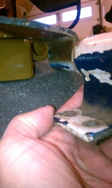

had an issue when I tried to install a rear tire carrier. the original hinges off the 68 were frozen, so I grabbed a set from an early seventy's. the body side of the hinge was identical length; however the tire carrier side is about a half inch off. looks like I'm going to have to fab this up.

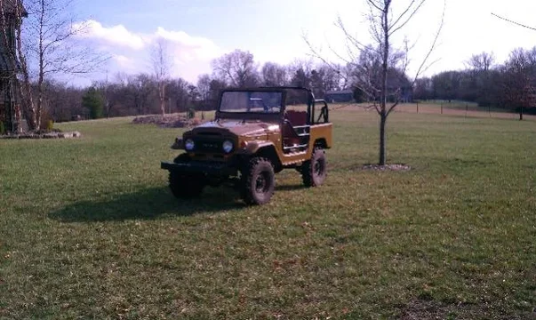

So, here is the list:
Brakes - great.
Clutch - great.
Engine - good. Idle really nice
Tranny - great - (I need practice on column shift)
Only issue is that we had a small gas leak from the bowl, but a little tightening of the screws and it disappeared. Filled with coolant, and no leaks!
Thanks go out to everyone that lent a hand over the past couple years putting her together. I know that I will forget some, but special thanks to my main bud, Rob for all the time he showed up after a call for a "quick" project. All this would not of happened without Erik, Colin, Rob, and my family for supporting my addiction.
Lots of little things to do still; however, I guess Ol' Blue needs a new name now!
Shakedown this next week with a trip over to get it legal!

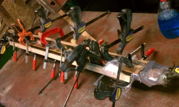

somewhere under all those clamps my dash pad. bought a cover from cruiser corp.
Not saran wrap, but that packing wrap you use for palletizing stuff. We called it stretch wrap years ago. That is what you see on the ends. You can pick up 4" wide rolls at home depot back in their packing stuff for $5.
If I were to do it again, I would tape up and protect the edges from overflowing glue and glue the inside of the form, not the old dash.
It is 4 days later now, and still have not unwrapped it yet. Giving it plenty of time to firm up, as almost everyone warned me on MUD.
