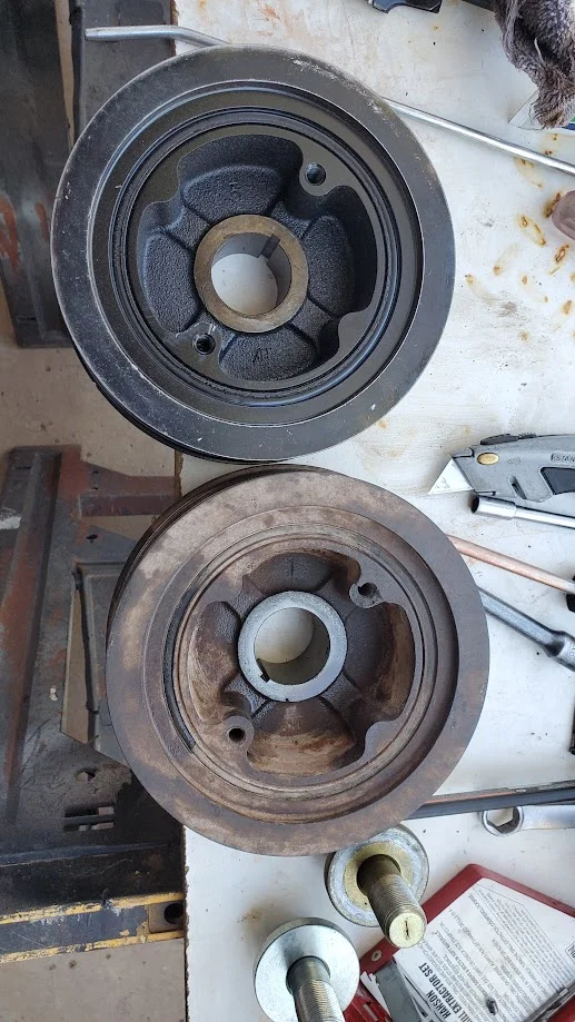

I stopped by my nearby Harbor Freight after collecting the new HB. Pittsburgh is in my budget, but WOW the selection of ICON tools is stunning! I have not been there for a month and all of a sudden the place is loads with tools.
I've got the Icon ratchets and extensions. They are a lot nicer than my old Craftsman Professionals.

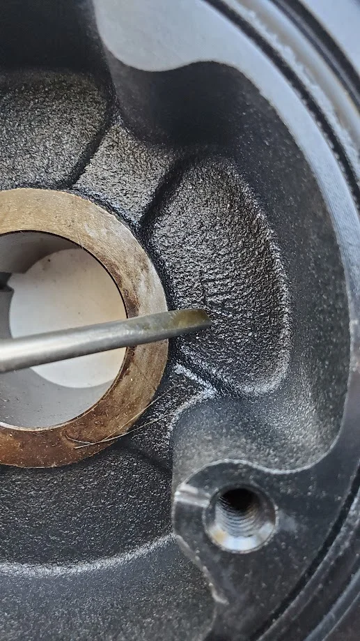

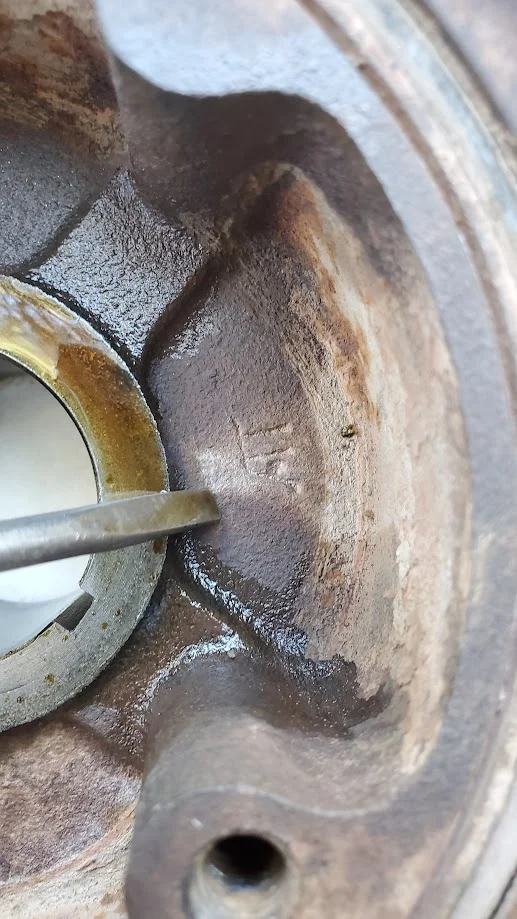

There's a writeup on OME harmonic balancer vs another brand and they both display the same manufacturing stamping. I bought the alternate one and it was in fact identical to the OEM that I replaced.
