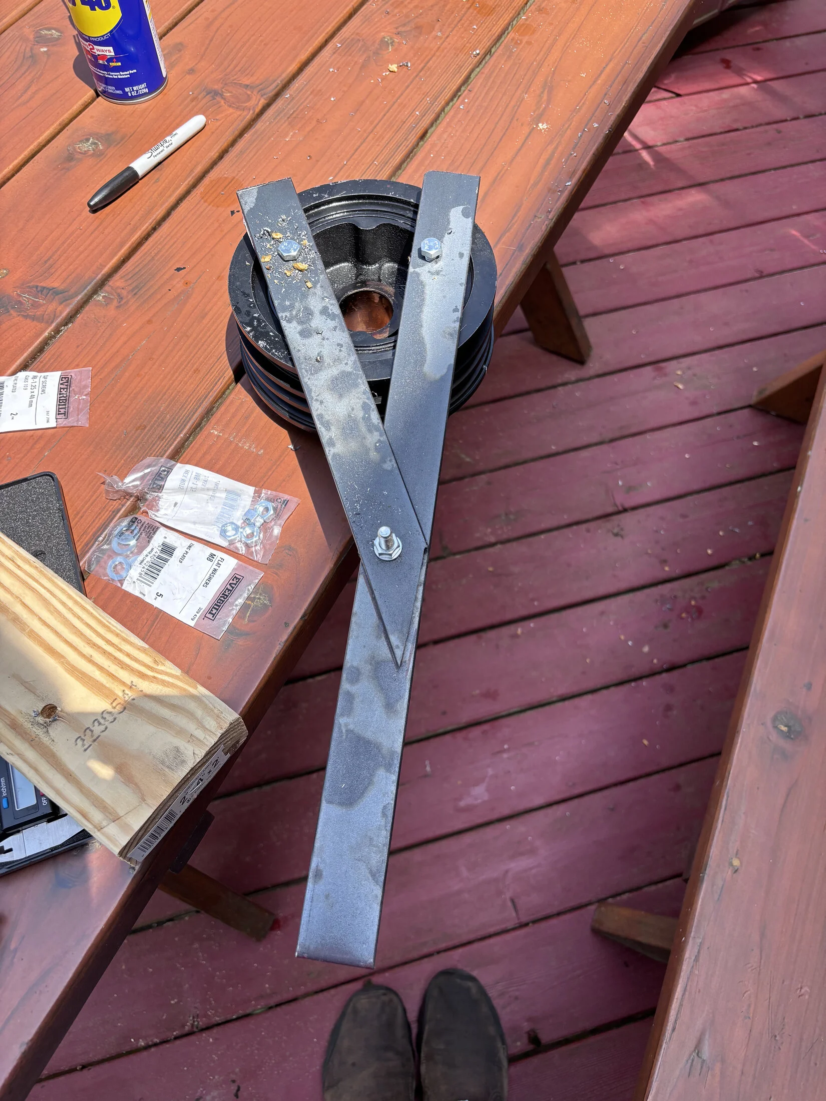

Ok, I cobbled together this crude holder for the crank bolt. In elegant by the standards of this group, but it actually got the job done. 4' black iron pipe on my breaker bar and the thing yielded with a bit of effort. My torque wrench only goes to 250 ft. pounds, so I got it there and used the breaker bar and pipe to go a bit more.

congratulations and nice holder, simple yet effective!!!

It was fine with the new one - I filled the gap between the flat steel and the M8 holes with washers. Bent the snot out of the bolts I used on the old one. Should have put some sort of spacer in that gap. But, I got away with it this time.

Looks pretty damn elegant to me.
Very simple solution. Way to think outside the box

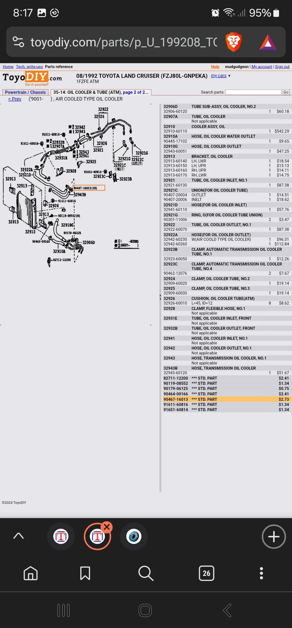

I am ordering 32941-60110 which is the inlet side hose
The outlet side is discontinued, but nothing special. Any recommendations from experience?

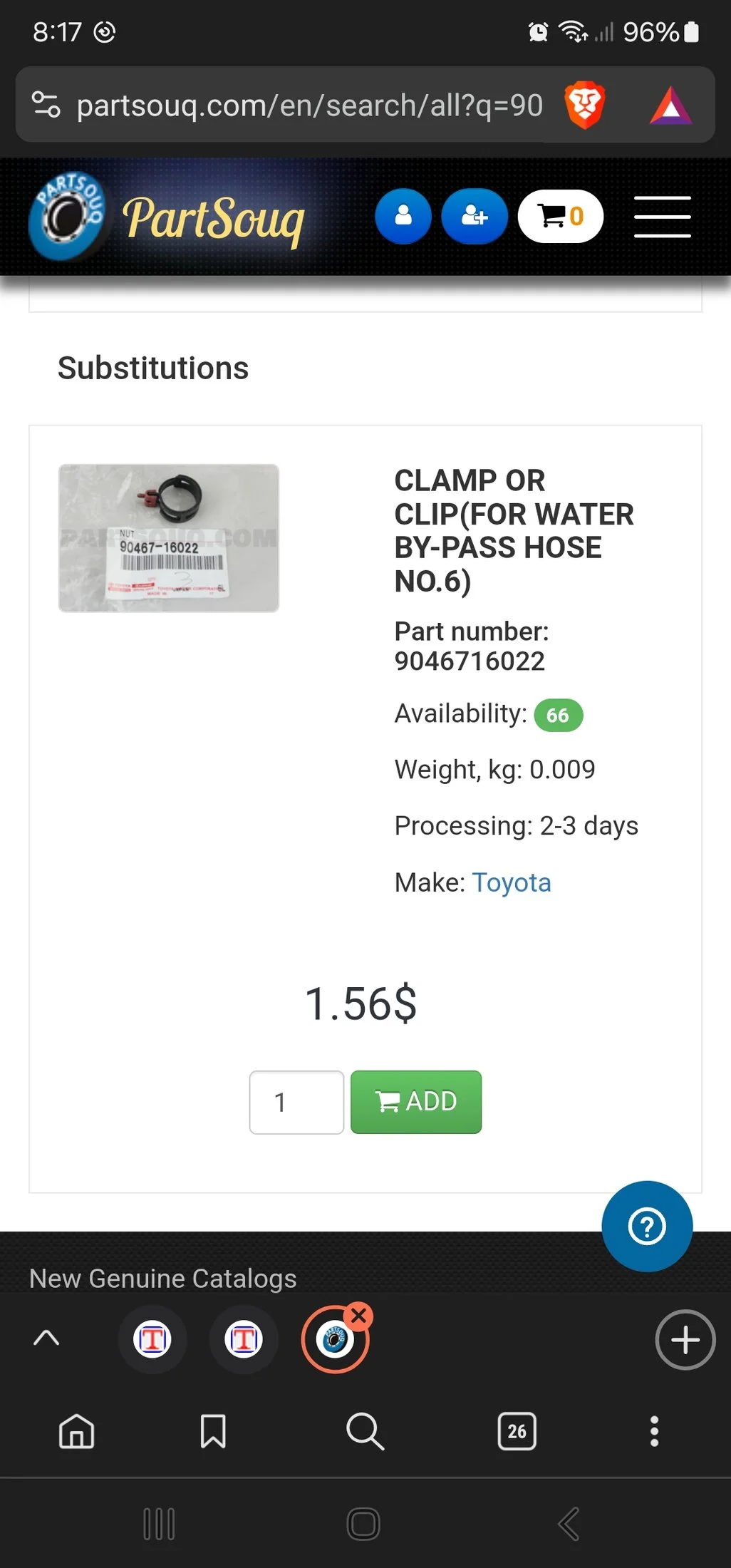

Also, how do I get the correct clamps?

I have been reading this as a reference on the transmission lines.... Need to see which lines are available from Toyota though, the one I was dealing with is not.

The critical dimension is the OD of the hose, otherwise the stock clamp may not give enough squeeze for a good seal. There are however multiple sizes of OEM hose clamps, the hard part, if you want to stick with a Toyota clamp, is finding the one that will work with the aftermarket hose you use.
