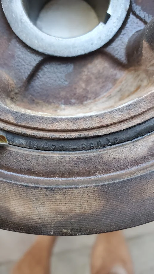

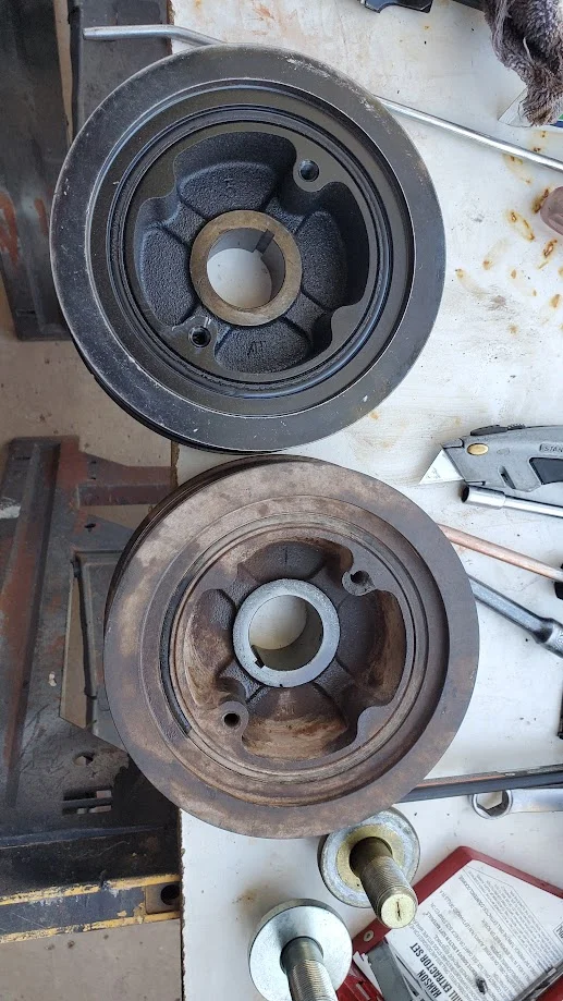

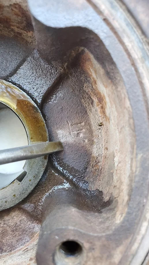

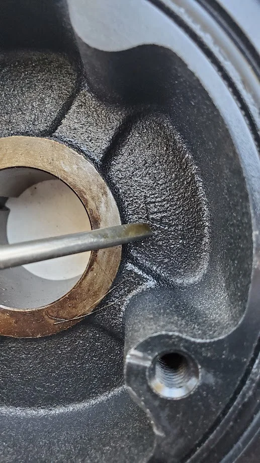

There's a writeup on OME harmonic balancer vs another brand and they both display the same manufacturing stamping. I bought the alternate one and it was in fact identical to the OEM that I replaced.

Any chance it is the Febest TDS-1FZFE? That is an alternative Amayama offers. It is also readily available in the US for under $100 and sometimes even with free shipping. Shipping from Japan or UAE is in the $100 range...

I would remove the radiator it is easy to damage, and you will be thankful for the extra room. You can use a m8 bolt for the tranny lines as plugs. just remove the headlights to get to the 2 bolts for the radiator. The other HB is a dorman not febest and is the same part but i found it was more expensive than toyota when i was searching.

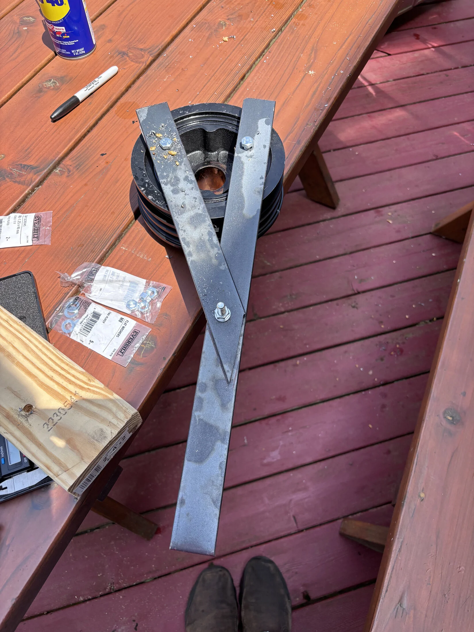

Since I do not have the elegant holder tool you guys make, I am going with using a deep 14mm in the transmission window. Home Depot looks like they have a Memorial Day Sale on for a big impact gun....

Ok, I cobbled together this crude holder for the crank bolt. In elegant by the standards of this group, but it actually got the job done. 4' black iron pipe on my breaker bar and the thing yielded with a bit of effort. My torque wrench only goes to 250 ft. pounds, so I got it there and used the breaker bar and pipe to go a bit more.
