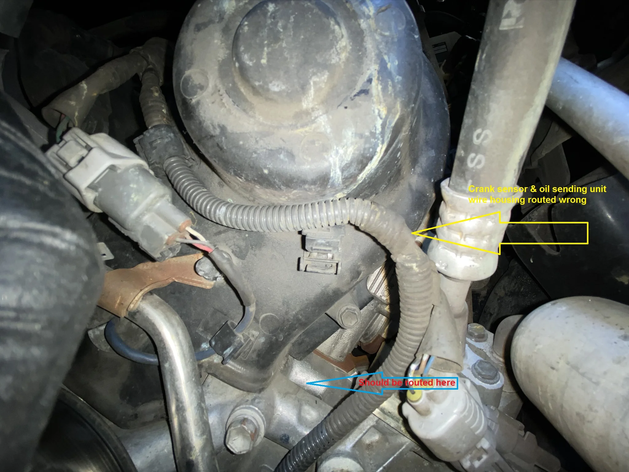

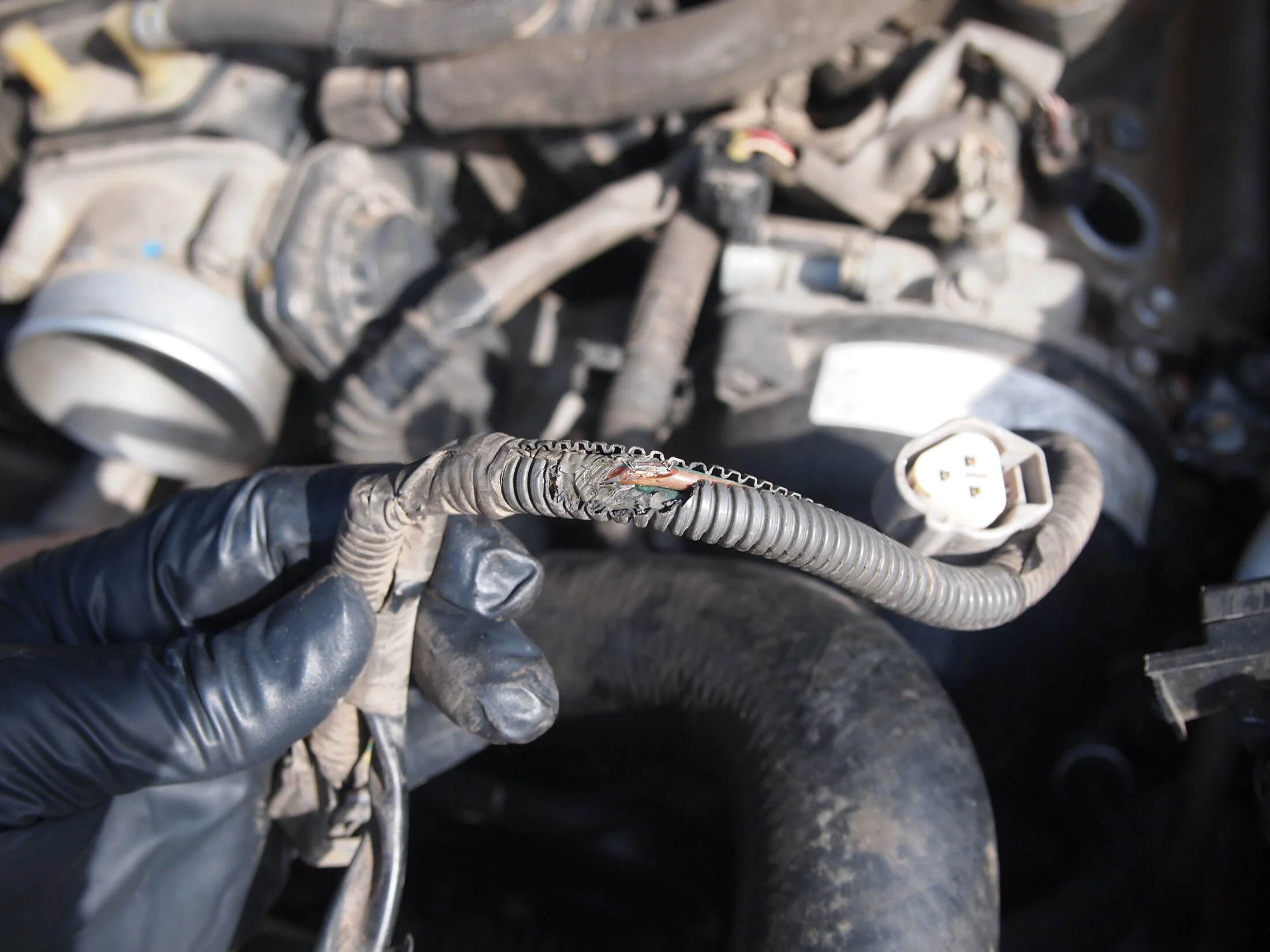

I see now working. But still, I'd take a look to see if: Wires to crank sensor & oil sending unit routed wrong and rubbing on fan belt. Drivers fog, check bulb if not working, also check wires to it, for rodent chew marks. I assume, all fuses looked at first.
Ouch
