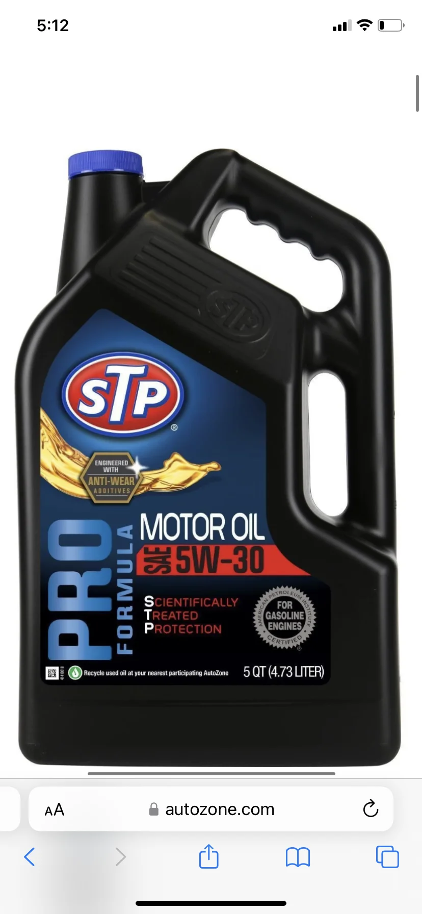

Just hit 1,000 miles on rebuilt 1FZFE with a brand new short block from Japan.
Only “conventional” 5w30 I could find was STP Pro Formula. I put conventional in parentheses because it was the only one in all of Autozone and on the back it says “STP conventional motor oil contains a premium additive package scientifically formulated to help insulate your engine from the damaging effects of wear.”
“Conventional” and “premium additive package” in the same sentence is weird to me.
Any one have any thoughts on using this for my first couple oil changes until synthetic? I called the shop who rebuilt the motor and they recommended I look for Castrol, but I don’t see any conventional 5w30 they sell. Someone above mentioned Toyota conventional oil, but again all I find is synthetic.
Pic is of the conventional oil at Autozone.
TIA

Any thoughts on the STP Pro Formula posted above? Thanks
No, other than I'm sure it won't make a lick of difference year 2023 which major brand engine oil you decide to use. Off topic, but Americans regularly stuff processed junk down their throats without giving a 2nd thought. If peopled fretted about food intake as much as engine oil decisions, the world may be a healthier place.
