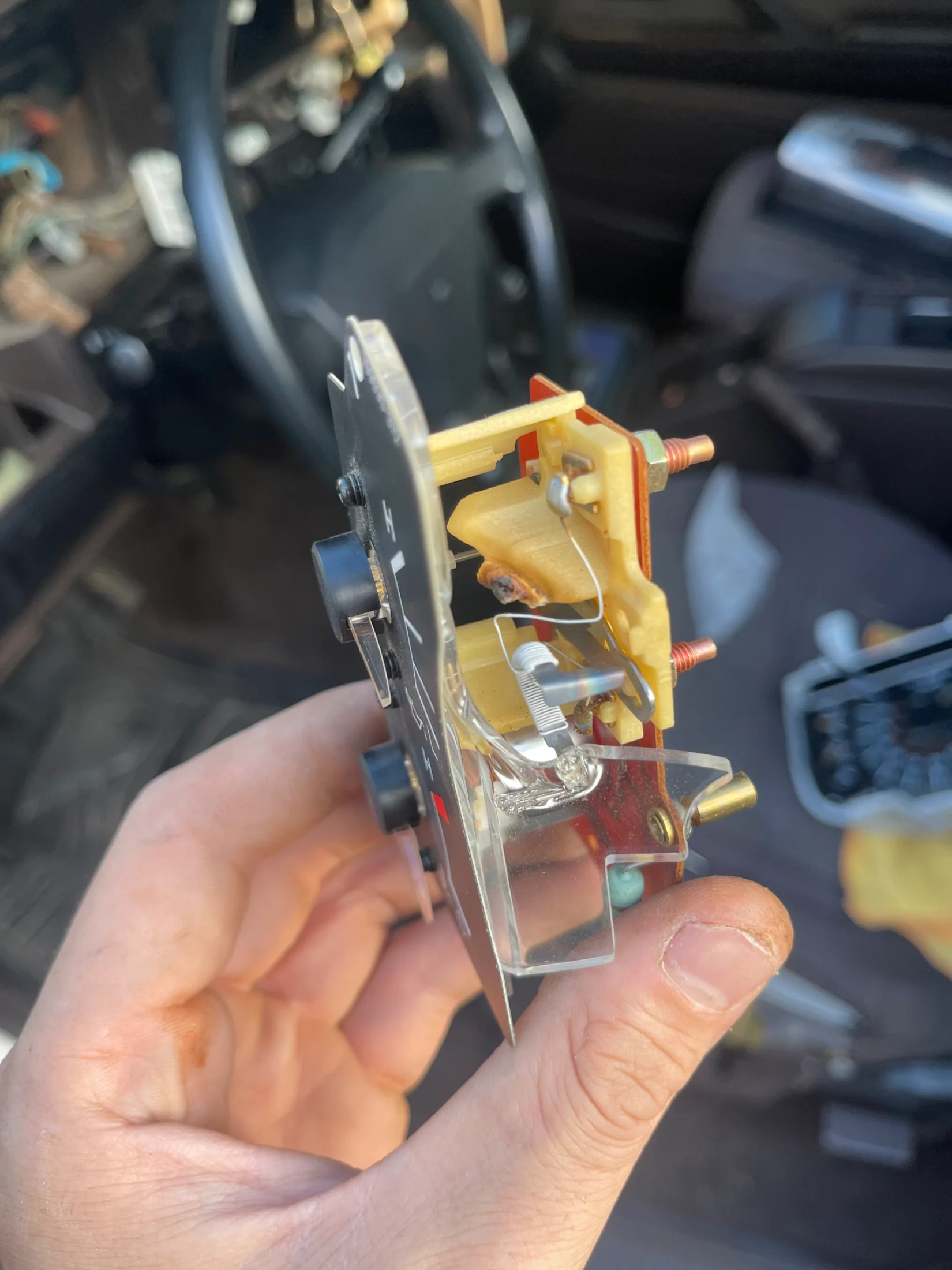

finally decided to dive back into this project this weekend ( stereo install so figured I’d dive into this as well since the trim pieces would be off ) and wanted to rule out if my gauge was no good or simply just a wiring/ ground mishap. Turns out the gauge itself shorted and got super hot resulting in major discoloration and even melted plastic (explains why the gauge was unresponsive) so a new gauge will have to be in order.

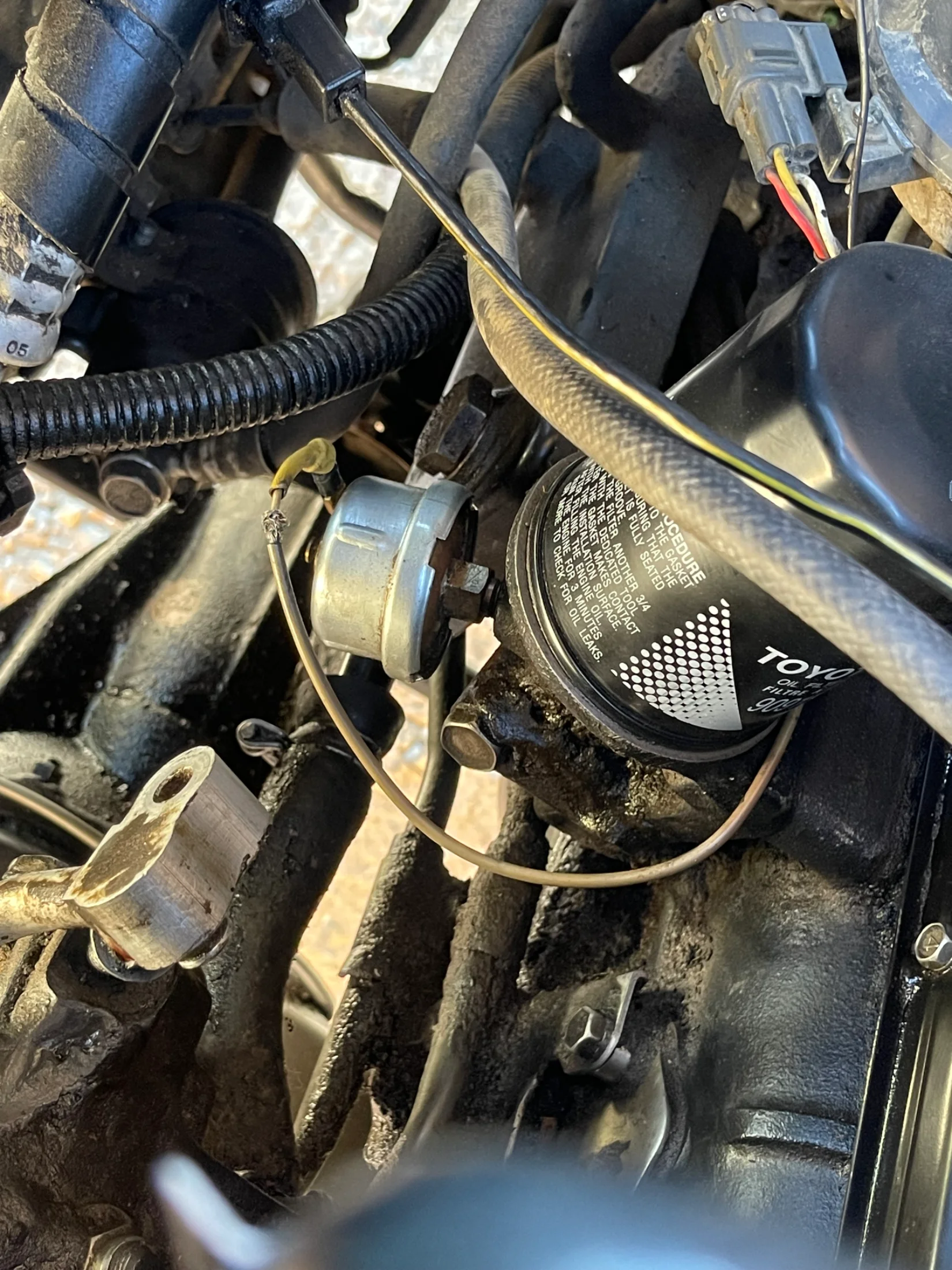

As far as troubleshooting should I start with continuity testing? I also have some concerns with how the connection is established to the sender gauge, does this look normal or potentially something missing? Any reference photos of you guys with a 3FE would be killer!!
