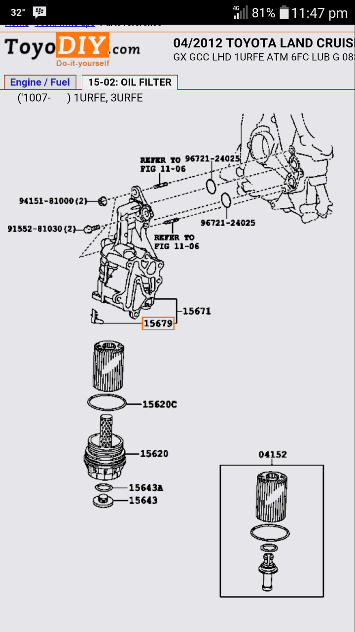

So I broke my tab off accidentally awhile ago, conscious of this I have been giving the filter a bit more torque in the end as a precaution. Has anyone come up with a fix without losing a limb or two worth the cash???
I can't be the only tab master!
Not sure but i think this is the clip/tab?
Hope @beno chimes in.
P/N: 15679-37010
