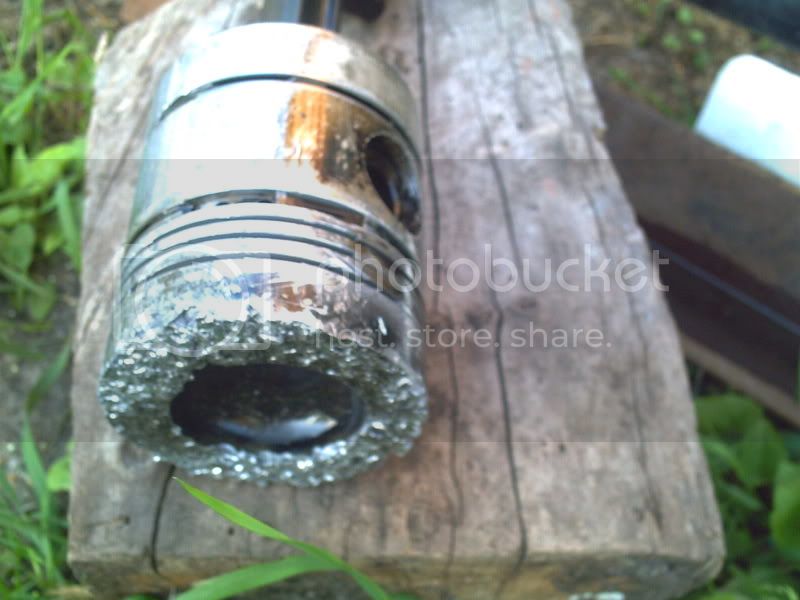

I'm not real familiar with Toyota diesels, but most diesels are sleeved inside the cyclinder. Is there any chance that it could be sleeve material? Have you done a compression check?
Ask me how I know: This is the sleeve out of my diesel. I didn't catch it in time, and lost the whole sleeve and completely trashed the block. The only indicator of this problem was it keep smoking real bad. Cycliner was firing, just not burning completely. Hope you solve your problem.
Pam
Compression is good, 390-400 all cylinders, if I remember correctly.
Its not sleeve material, I put a propane torch on it and it melted in seconds - that means its definitely not steel like the sleeves would be.
Also, @ your picture: HOLY s***! :eek::eek:
This out of my original 4-236 Perkins. The Sleeves were straight without a flange, so it worked lose and slowly got ate up with the crank. This was discovered after replacing the injection pump and injectors trying to fix the problem. Hope you find your source.
Here is the top of the piston:
