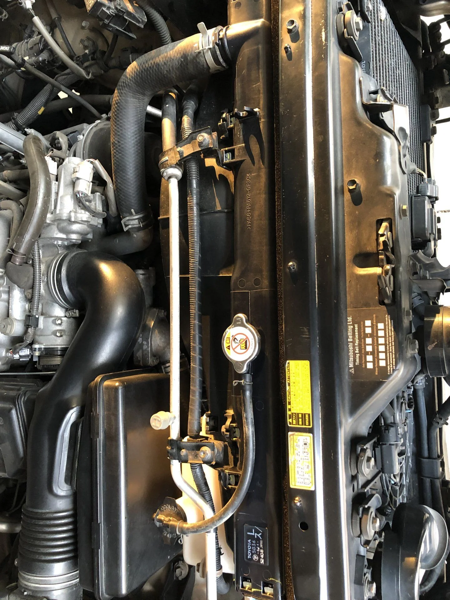

As for the radiator, mine is original and in fair shape. However, I have noticed that there is a decent size area of fins that have been bent over, seemingly impeding airflow. I surmise that this damage occurred when the TB service was completed. Would it be worth the time going through and "unbending" the damaged fins.

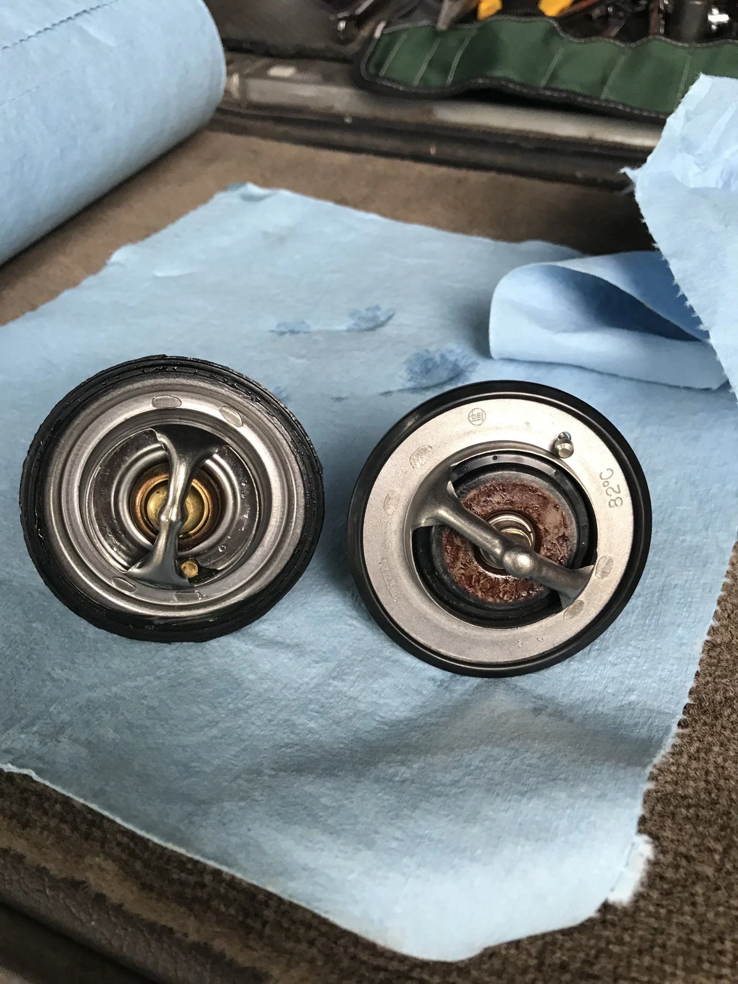

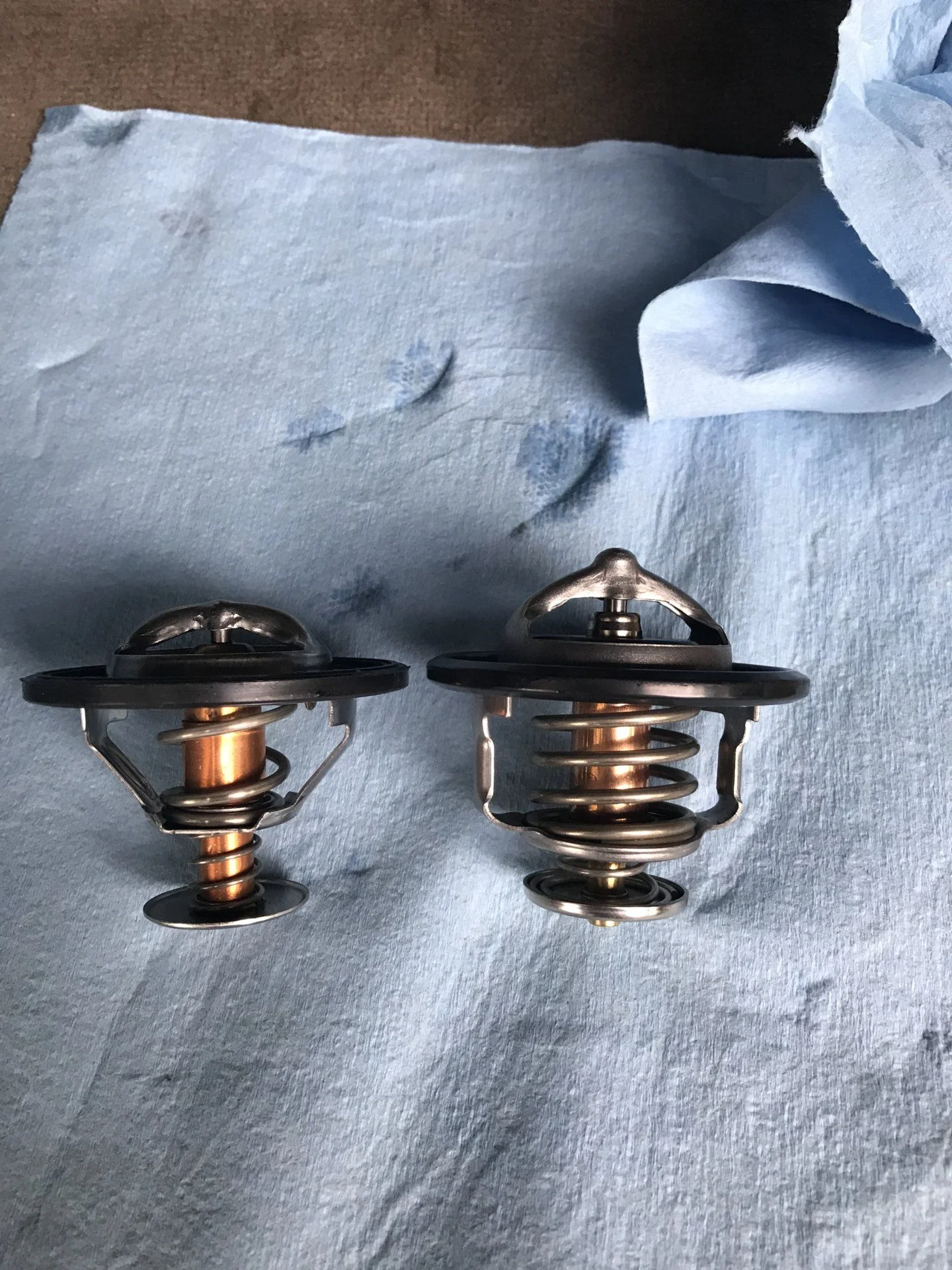

This evening I pulled the Napa thermostat and installed the OEM thermostat. I’ve included pictures below to compare the two. Napa on the left and OEM on the right. Quite a difference in design IMO.

I went for a nice long drive to test out the newly installed OEM thermostat. No highway driving, but about a dozen miles of stop and go city driving. I am now getting ScanGauge coolant temps of between 188 and 193*. I am cautiously optimistic. We'll turn some highway miles tomorrow and see how temps look.
I had an aftermarket thermostat in mine and had temps at 197-207 and occasionally 211 with the scan-gauge. I noticed my radiator was filthy and weeping along the side tank and decided to replace it with a new Denso along with a new radiator cap. Didn't see any change in temps. I finally replaced the aftermarket thermostat with a new Toyota one and my temps in the winter ran a consistent 184. Now with summer temps & humidity in NC, it's running around 188 with high of 197 in stop & go traffic.

My radiator appears to be an OEM original. It has not discolored and Aside from the bent fins (which I will post up pictures of later) I think the radiator I in good condition.
