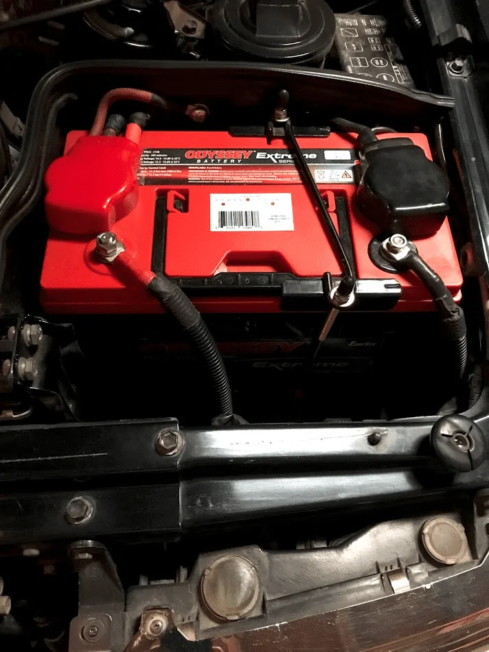

That battery has the terminals on the wrong sides. I do run there group 31 battery, really like that it has a second set of terminals that I use to power the winch.
You could compare your battery to the spec's they post
I have a 31 as well. As broski mentioned the terminals are on the wrong side for that battery you show but either way even with the 31 plan on having to extend your battery/ ground wires to reach the terminals unless you find a model I’m unaware if but likely didn’t search enough.The factory wiring will be short, the battery is huge so plan on modifying your battery hold down at minimum. I don’t see the spacer being needed if you go with that battery but for $2.00 I would get it. These batteries are way heavy and fill every bit of the factory tray and expensive as hell but well worth it. I had an optima before and it was garbage compared to the Odyssey.
The only thing I had to extend was the power to the fusible links. (Land Cruiser Phil, fusible link relocator.) You well need to cut a small bit out of the in side corner of the battery box.

The only mod is the plastic tray that comes with the battery to raise it up slightly. No modification to the cables needed.

I picked up the group 31 X2 Power marine version for the extra terminals. Fit the battery tray fine after trimming off a couple of the plastic ribs on one corner of the battery. I used the group 31 kit to extend the fusible link.
That looks very similar to the X2 Power (X2Power Premium AGM BCI Group 27F Car and Truck Battery - SLI27FAGMDP at Batteries Plus Bulbs - https://www.batteriesplus.com/product-details/auto_light-truck/battery/x2power/sli27fagmdp) or Northstar. The specs are identical and the price is similar as well. I think you'd be better off getting the X2 Power or Northstar 27F since the terminals will be on the correct side.

For single battery set ups I like the 31, but that may require more configuring than you prefer with the updated top.
If not, I like the 27, which comes in multiple post configurations and is rated higher than the 34 in almost every category.
I went with dual 27’s in my dual batteried 80 to save 20 lbs from a dual 31 set up.

If you can accommodate the size of a 31 I would recommend going that route, either a 31P-MHD or 31-MHD. 31P is automotive post the other one is marine post.
I am running two Northstar AGM-27F batteries in my 80 series. I opted for the identical terminal config for both sides. They are about 10 kg heavier each than standard lead acid 27 series batteries but have given me absolutely no trouble over the 4 years they've been in use.
