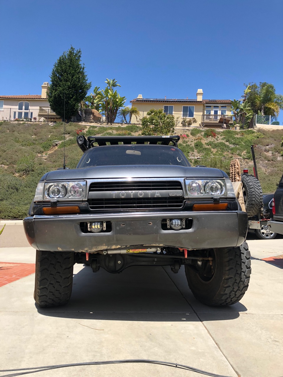

Not wanting to let that factory "fog" light harness go unused, I pulled apart an old 30" light bar I bought from @2000UZJ a few years ago and mounted a couple pieces of it behind the bumper for some stealth off-road lighting.
Used slotted angle brackets I had in the garage and the lights bolted right up to a tab behind the bumper
Should work until I get a new bumper...wait...I'm trying not to fall down that slippery slope!

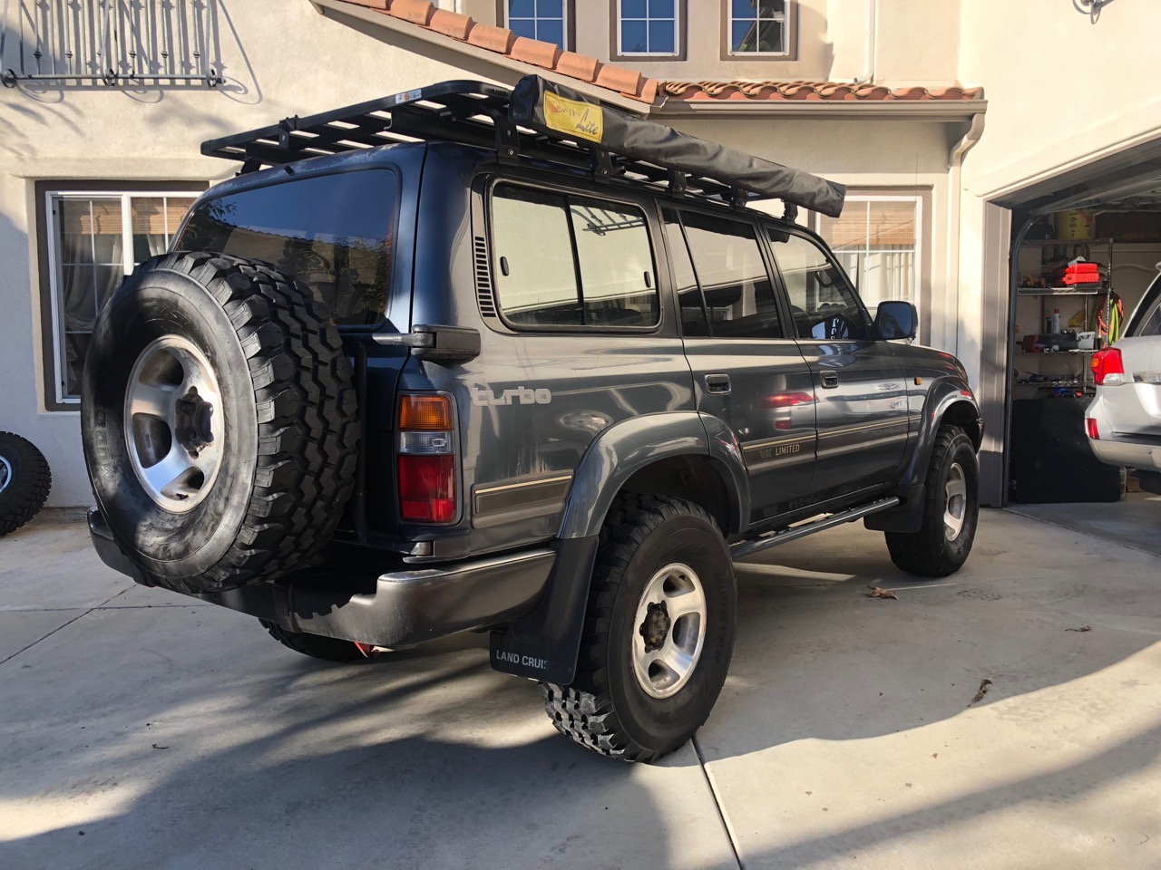

Added an Eezi Awn K9 rack and awning after a quick call to @Equipt

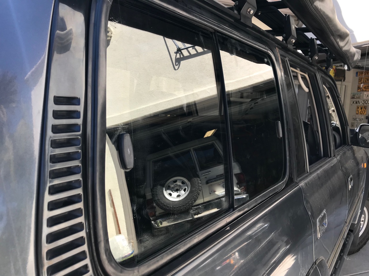

Picked up sliding rear windows for $50 off CL. New seals and couple hours of finger busting work, et voilà!

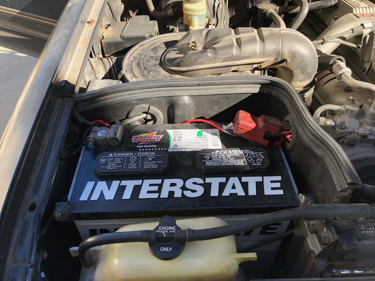

Had to get a jump start from @Dan2722 in one of those "middle of nowhere" locations a couple weeks ago and decided it was time for new batteries. Added a pair of Interstate group 27s and all has been good since.

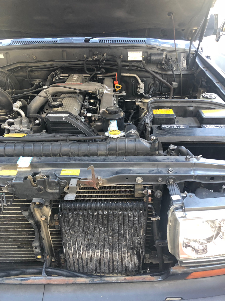

Found an OEM transmission cooler at a local wrecking yard. Seems to be helping keep temps under control better than the aftermarket one I'd installed a few months back.

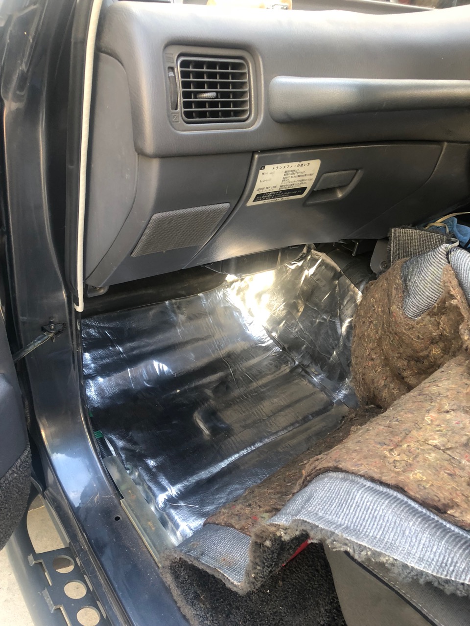

Had been wondering why my feet would get so hot driving the 80 and stumbled across this thread and instructions for replacing the upper steering shaft seal posted by @LandCruiserPhil . Gotta love $15 fixes that take less than a half hour. Thanks, Phil!
Here's the before shot. Pretty clear why heat and dust would get into the truck.
While I was at it, I put down a bunch of QuietCrap. Awesome stuff!

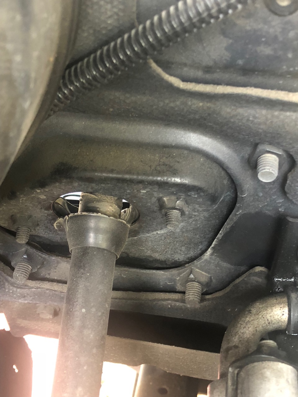

As if dripping/pouring transmission fluid all over the garage floor, on my clothes, in my hair, and everywhere else wasn't enough, I decided to take on the classically messy knuckle rebuild project not even a week after replacing the transmission valve body. After a quick call to Bryce @cruiseroutfit for a rebuild kit and a stop at the hardware store for some ABS pipe and 12 pack of shop towel rolls, I was ready.
Yuck. Not a moment too soon.
Ran into a challenge seating the longer axle shaft and trashed the inner axle seal. No solution for that on a Saturday evening. @bushdoctor was over to help, which he did, but his decision to quit working on the truck and go get some beverages was his most appreciated contribution.
