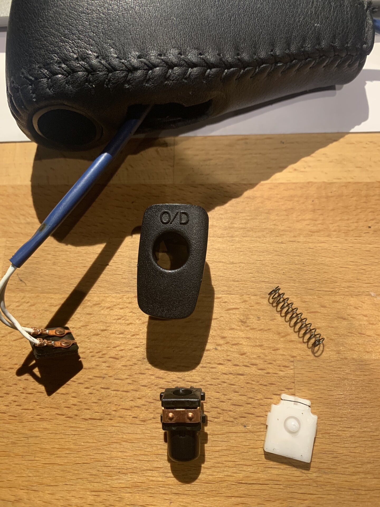

Have any of you guys taken apart the O/D switch on the shifter handle? Am I missing any pieces? My O/D button fails to stay latched when pressed causing my O/D OFF light to be on all the time.
From the pics, you're missing a wire form peice that's about .4" (11mm) long that looks like a staple.
I found it! 😁took me a good minute to figure out how it all goes back into the switch but I figured it out. Thanks for the info!
You are most very welcome.
Took me a minute or two to figure that out as well when I recovered the gear shifter.
