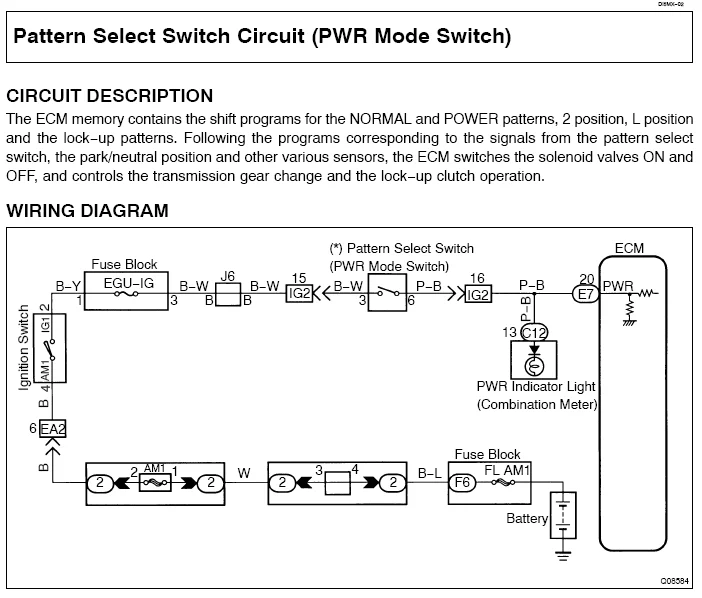

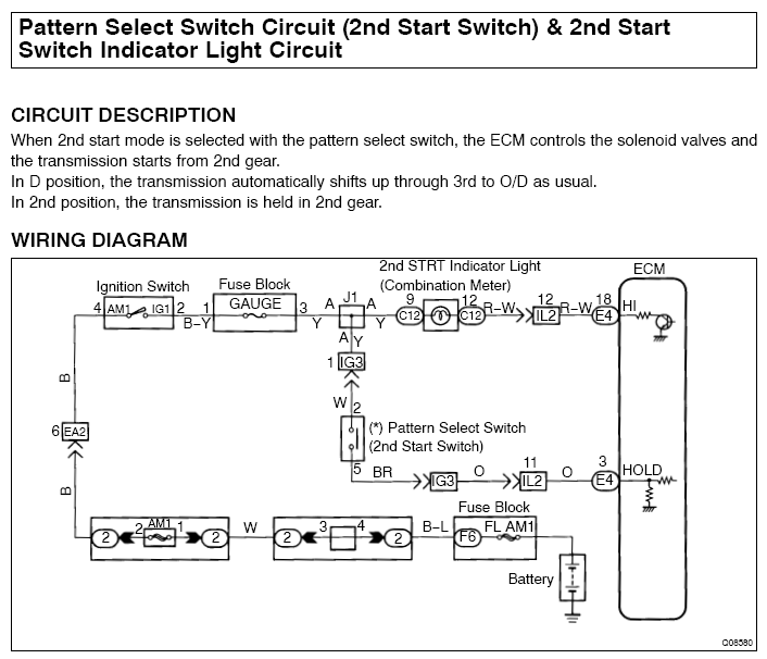

There isn't much to the circuit. If the light on the dash is on all the time then the switch is always getting power to the dash light.
For both conditions, power and 2nd, the switch is connecting directly to the ECM. If the switch isn't bad then the problem may be the ECM.

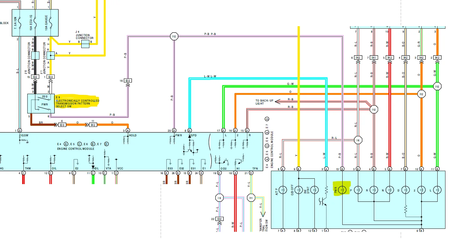

This is the diagram for a 1996 US model Land Cruiser. E 9 (highlighted) is the switch and PWR (highlighted) is the dash light.

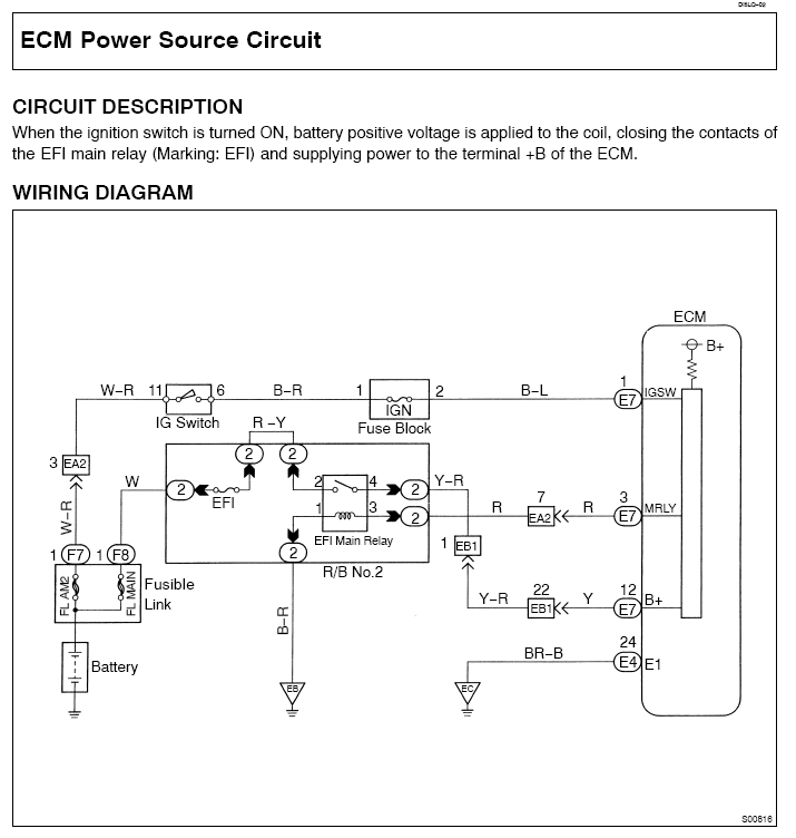

The EFI fuse in in the engine bay. On my 1996 LX450, it is on the driver's inner fender.
Here are the power circuits for the ECM, PWR and 2nd switch.
