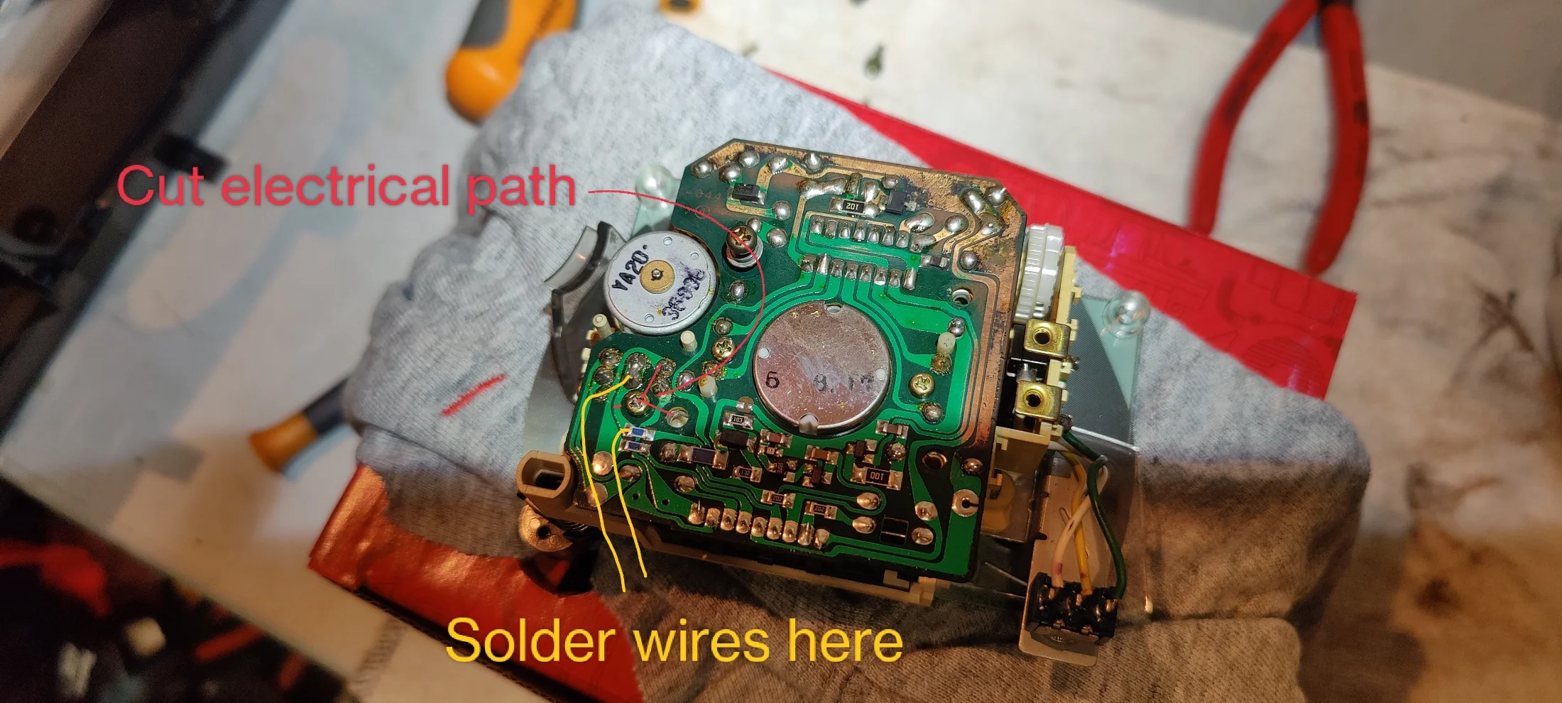

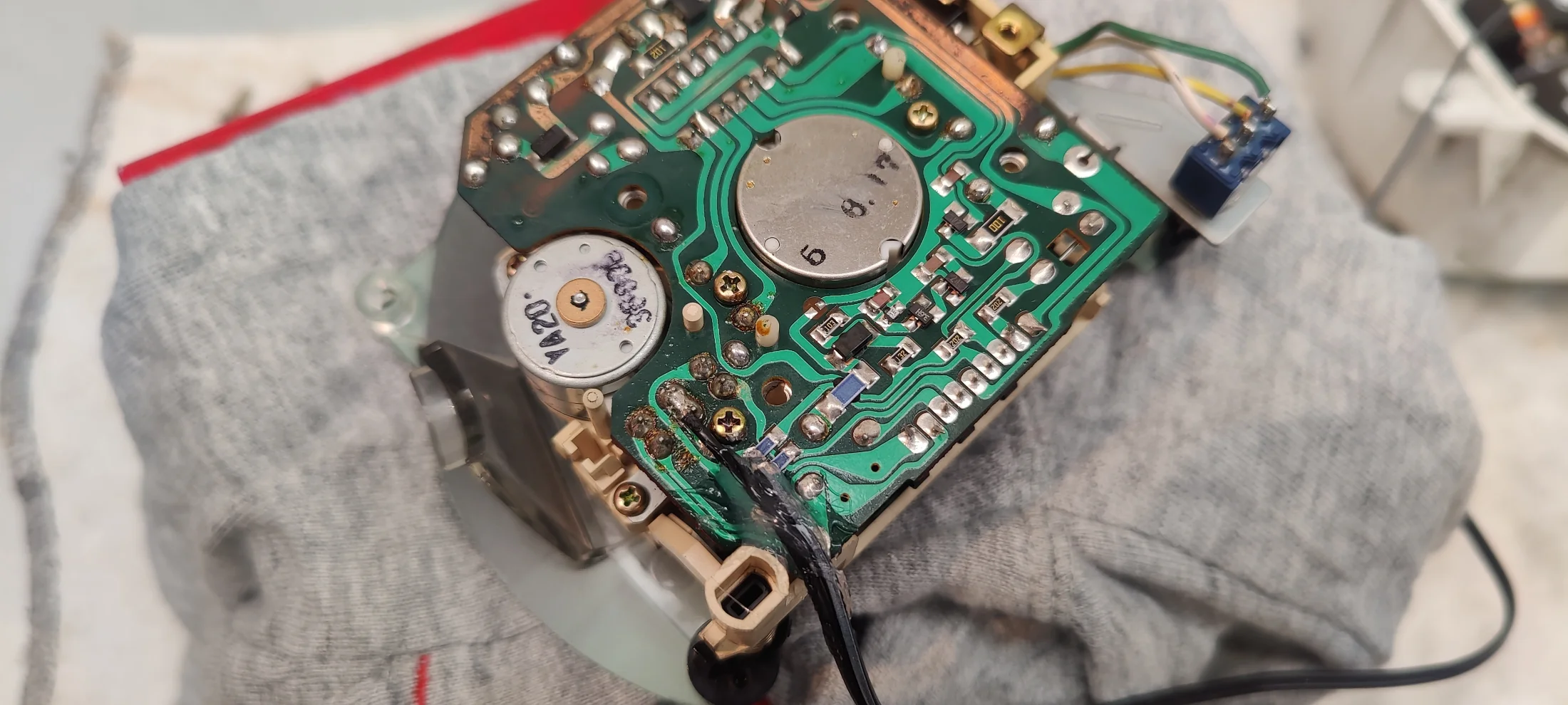

Remove the instrument cluster then remove the speedo gauge. Flip upside down and locate the 6 pins for the stepper motor, It runs the odometer/trip counter.
Cut the electrical path between the middle set of pins and the resistor. Sharp craft knife works well.

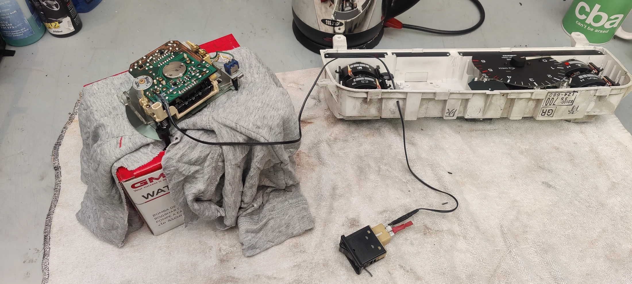

Next solder 1 wire to the resistor and another to the middle 2 pins. I wired this to a small toggle switch on the dash as I have upgraded to aftermarket shocks and no longer needed.
With a dab of silicone to hold the wires in place on the circuit board the gauge can be reinstated and cluster/dash put back together .
Photos to show where to cut and solder.

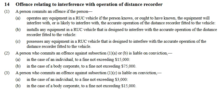

However, I decided to look up NZ laws.
This is the relevant section of the New Zealand Road User Charges Act 2012 as it pertains to the odometer, or as they call it the "Distance Recorder".
OP is risking $15K fine x 3, since he has admitted to doing it on 3 vehicles. There are no exceptions in the law to disable the odometer for off-road use.
