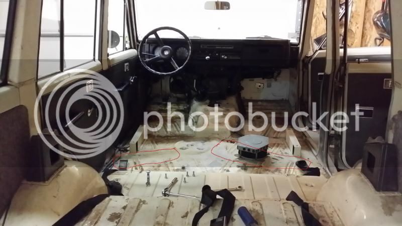

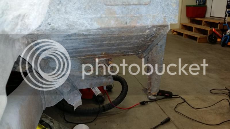

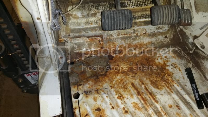

Stupid/Nervous question. Does the FJ55 floor have an angled bend to it right behind the driver seat? I added a picture. Never really paid attention to it until today while cutting and sitting flush with the floor. (attached picture of location)

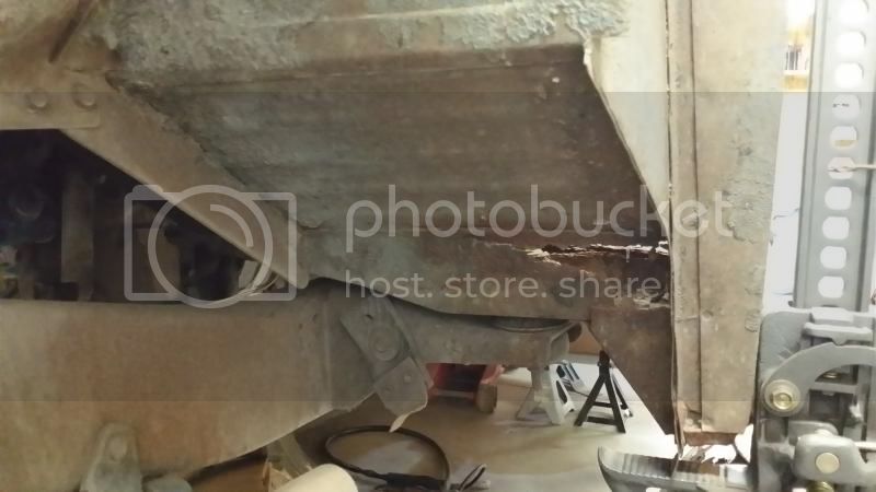

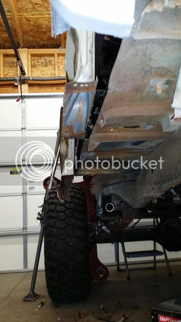

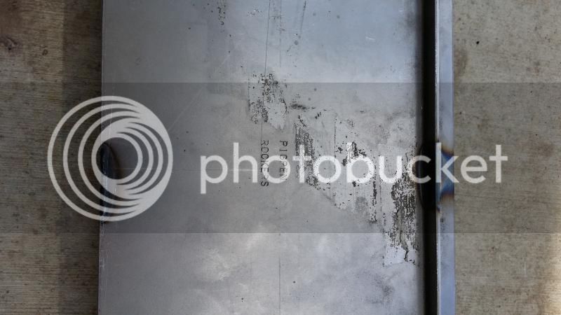

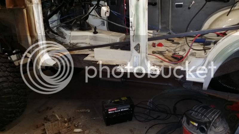

Started putting part of it back together, not really 100% happy with how it went together. Decided to stop working about that section for now and come back to it once the rocker is about to go on. The one front corner kept blowing through when I was spot welding because it was so thin on the original part of the panel. Ended up bending up a piece and putting it behind to reinforce it and be able to weld it. Either my welder sucks (which it does. Craftsman 110 with only a high/low and fast/slow settings.) Or I suck at welding (I do....lol). Either way, It's much better than a giant hole.

You might know this trick, but I use an old piece of copper tubing and smash it flat to use as a backing, when welding holes. It works really good, if you can get to the back of the area. Hold it tight against it or even clamp it, etc.
Good luck with it.
Did not know that! Will be trying that for sure!
Just did some reading on the subject. Apparently you can use copper or aluminum, which is good because I have some old aluminum intercooler piping laying around I can cut up. Thanks Ron for the welding lesson!
discarded computer heat sinks work great, most are copper with a coating, I have a copper spoon also for hard to get places made from a piece of copper pipe...

Sadly to say, around all the curved parts i was doing tacks and it was still blowing through. Then i started chasing the blow through (stupid me). Luckily im pretty good at learning from my mistakes and other people. The rest of the welding should go smoother.

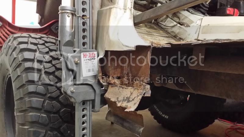

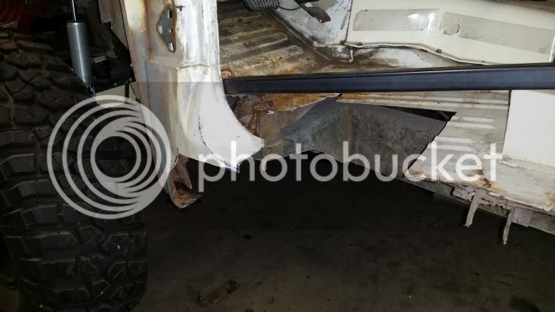

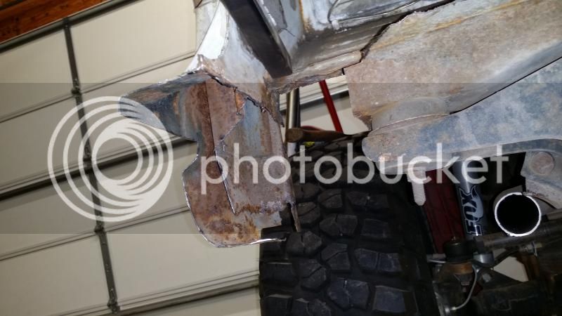

Week ago "More cutting" farther and farther down the rabbit hole...
The more i cut, the more i find i want to cut out. Hence the rabbit hole, im sure most of us have been there.

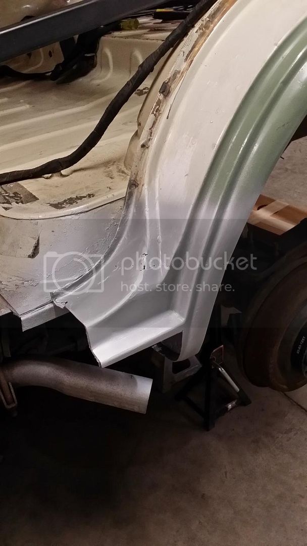

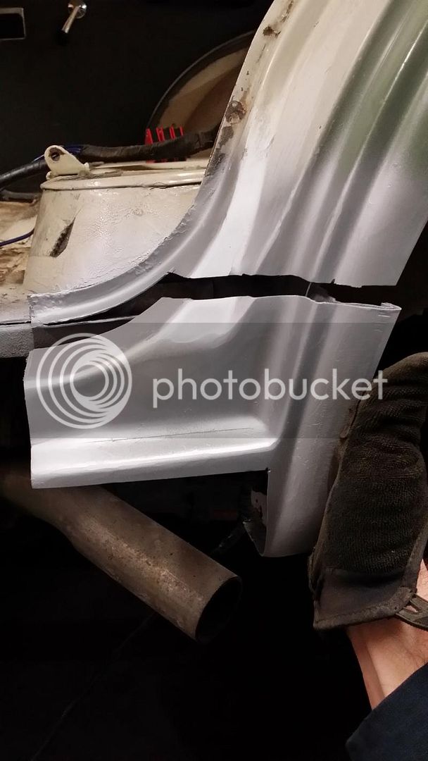

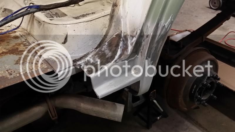

realized the piece that i spliced in towards the back is ever so slightly at the wrong angle (i miscut by about 1/8 inch) errrr.....
Underneath whats left
Put in place, this is when i found my angle was off. Was not happy, and spent the next few nights dreaming about it. Also was not happy that i cut the rear chunk out of the Bobm rocker.

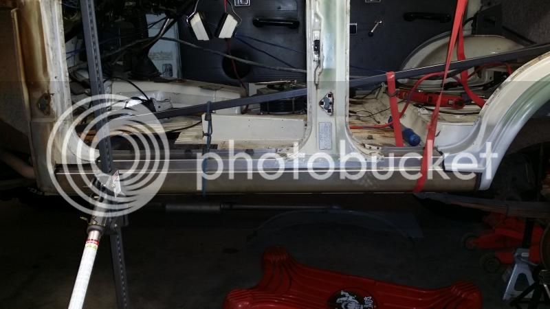

So we are at today, and first order of business was to correct some mistakes. (live and learn)
Welded the Bobm rocker piece back into place.
Also found this little "Easter egg" when i was cleaning up the rocker. Though it was super cool.

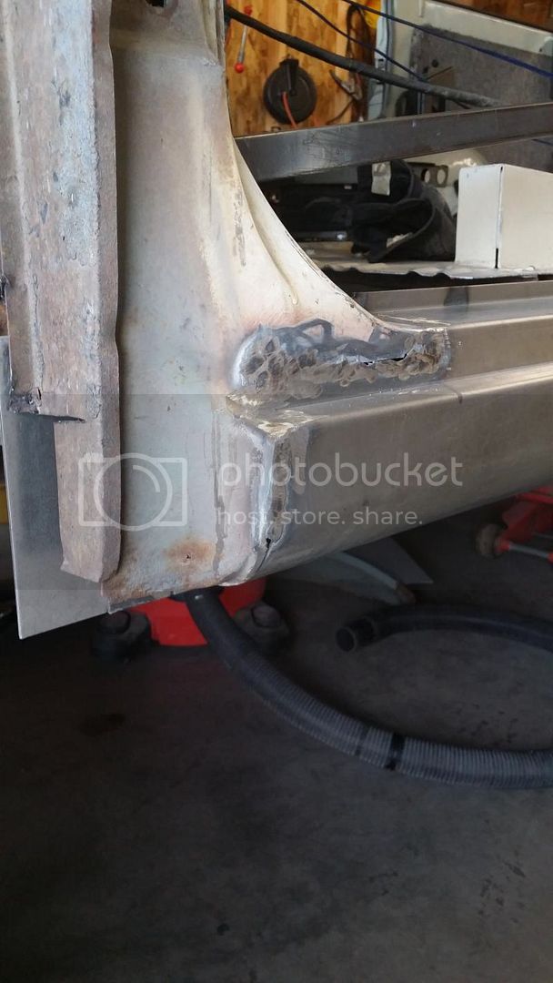

After some mild trimming, its tacked into place! Was so stoked i got the wife and showed her (got the typical woman response...lol)
started welding (dont mind the chicken s*** welds...thats what a grinders for)
Have some welding to finish up, but im done for the day. Back at it another day.
Overall, i know my work is not perfect, However, this has been one heck of a learning experience!
You should be damn proud of that work! Looking back to what you started with and now you have some solid metal. I think it's so cool, to be able to cut out a section of rot and weld in one of Bob's pieces, making it look so good.
