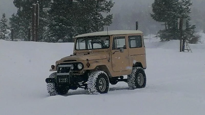

Was out in the trails with my 69 fj the other day. Always fun.
When i got home I realized that my turn signals arent working.
Any Ideas where to start?

PS - love your truck!
