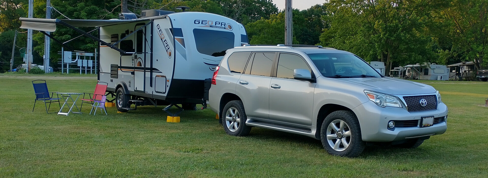

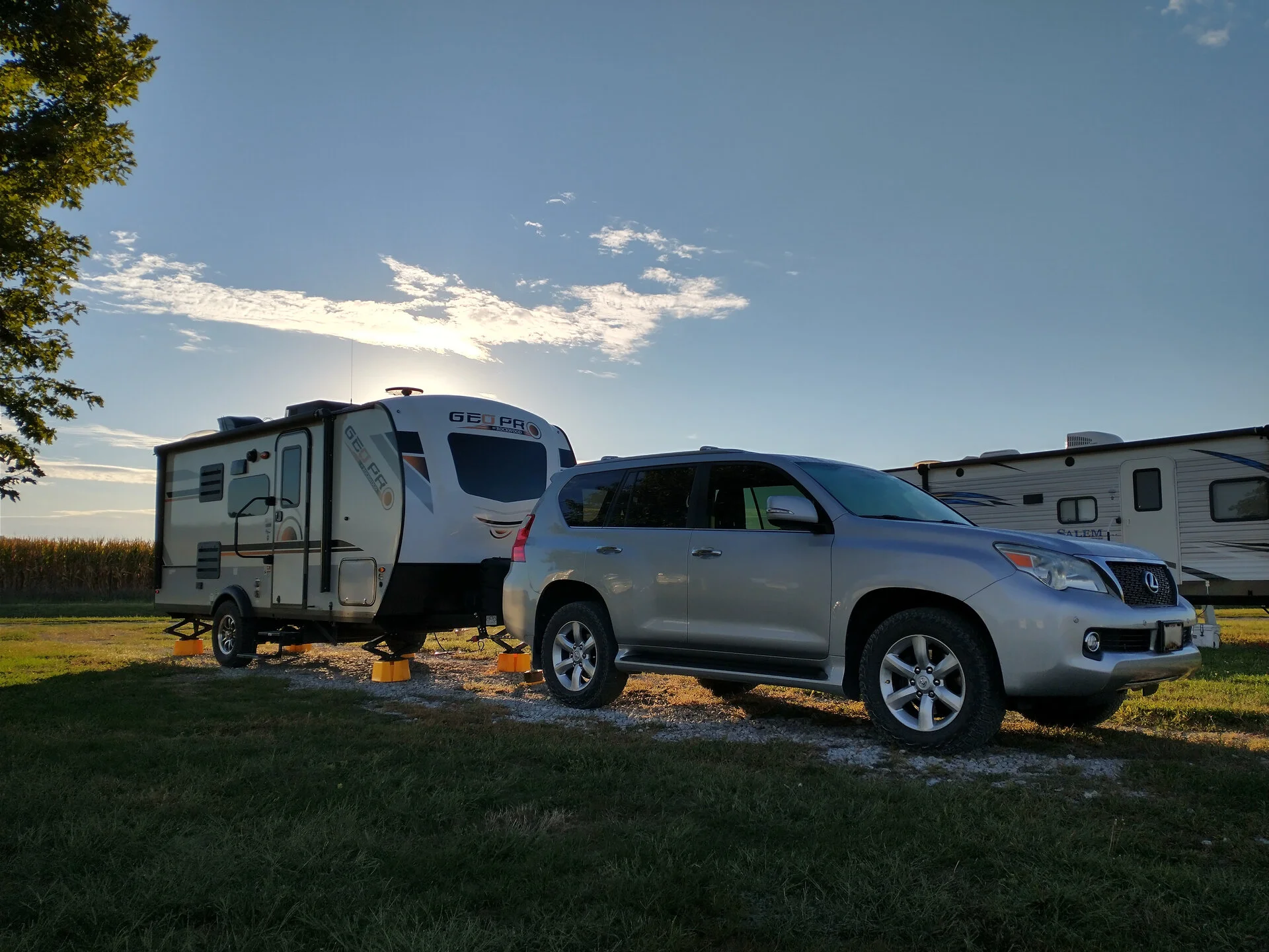

Trailering: Camper is pretty light (4k loaded) and I have the tongue weight down to about 400lbs after relocating the batteries. Still, I utilize sway control and weight distribution (Andersen) to improve handling and safety while on the road.
I pulled my brake controller from the 4Runner and mounted it in the middle so my wife could safely bring us to a halt if I unexpectedly choked to death on a twinkie or handful of skittles. I found a spare console tray on eBay that I could get choppy with and the above photo is the result. Serves its purpose and stays hidden when not in use. I'll pull it out one of these days to fill in my cut marks and refinish but for now is fine.

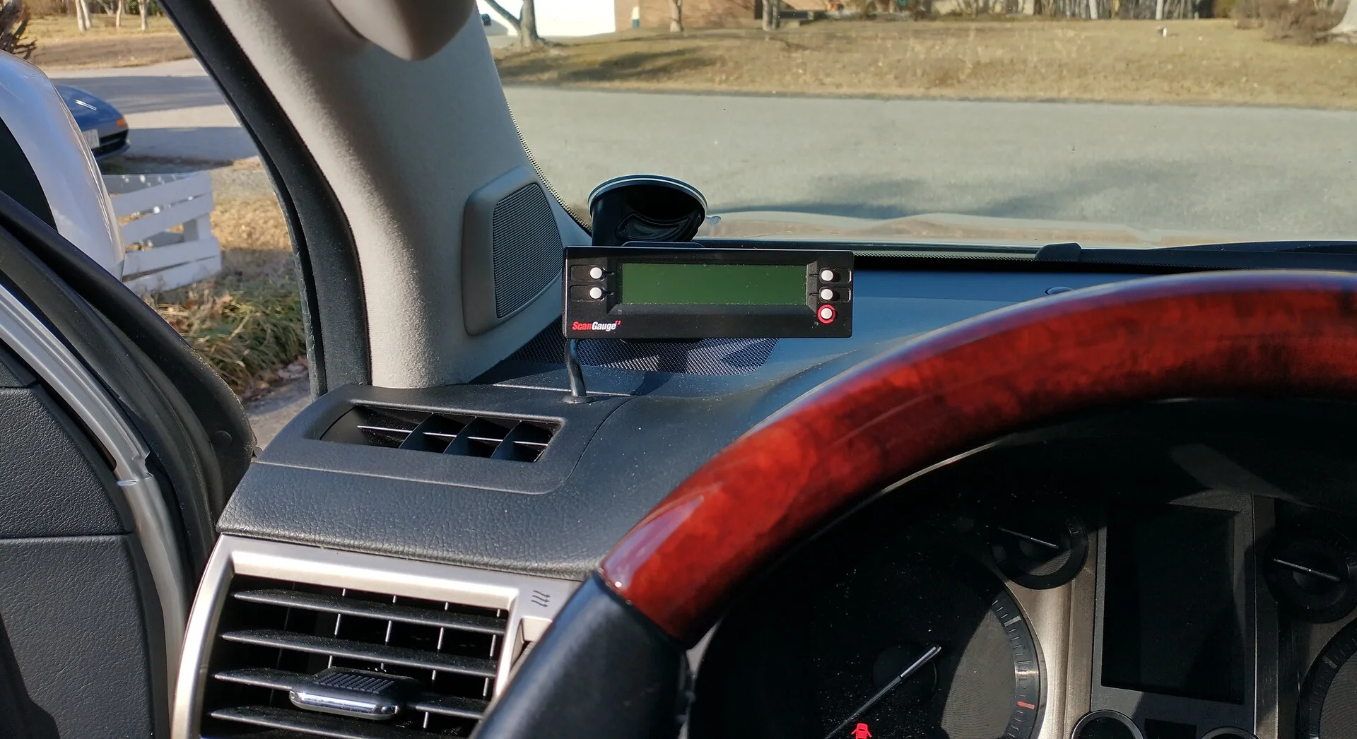

I use the SGII to monitor many things but transmission fluid temp is the primary purpose. It helps when doing drain and fills or when on the road with the trailer so I can adjust my speed/gear selection. I initially had it mounted on my steering wheel collar with velcro but I grew tired of the adhesive giving out on hot days.

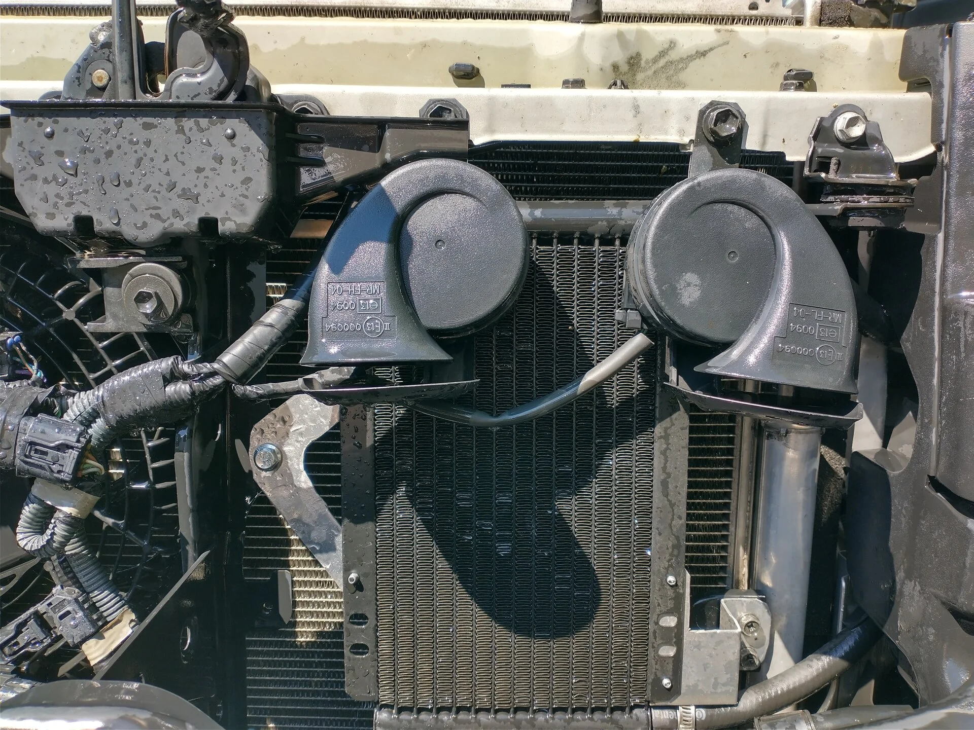

Not yet pictured but I have installed a Derale transmission cooler under my horns and in front of the radiator. This has really helped cooling while pulling the trailer. Highest temps during my last long tow in June reached 212F. Typical temp stays about even with engine coolant.

Coincidentally, I had a bird strike that necessitated further inspection/cleanup this weekend.
Pictured above is the Derale 13502 (Series 8000) cooler. I rough-cut the brackets from aluminum sheet and pop-riveted into the cooler mount flanges, while using existing threaded holes on the vehicle for final install. After 5k miles of use I have no working rivets or looseness in the mounts. I don't think I would try to fit anything larger as it would require more work/creativity to fit.
Since install, the highest transmission fluid temp has been 212F compared to a previous high of 238F while crossing from WY into MT en route to YNP a year or so ago. Personally, I think a cooler about half this size would be suitable for my application.
I would recommend that when you are fitting the hoses to the lower radiator barb, that you loosen or remove the two bolts holding the rigid cooler lines to the bottom frame. That will let you move the hose/clamp to a better working area in an area cramped by KDSS stuff.

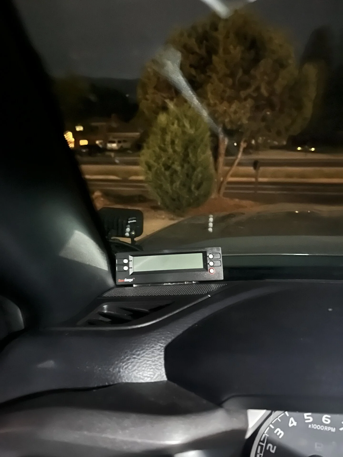

Was browsing the big picture thread (again) and found the OG source of that SGII location (3rd pic down in this post): GX460 / Prado120 pic thread - https://forum.ih8mud.com/threads/gx460-prado120-pic-thread.929092/post-13007759
Thanks @jmanscotch
I couldn't see how you had it mounted or how the cable was routed but it helped me find a solution just the same!
I put some sticky padding on the bottom of mine and then shoved it up against the windshield 😂. The sticky tape wouldn’t hold it from an adhesion standpoint, but the combination of the shoving it up against the windshield AND the sticky tape would hold it (mostly) in place.
Routed the wires two different ways: once I ran it through the dash, snuck the wire into the HVAC vents and had it pop out of the defrost vent (the on you drilled) and once I just ran it up the side of the dash, under the weather stripping/trim and let the wires lay across the corner of the dash.
I’m doing the same thing on my new Tacoma currently, but will buy one of these 3D printed mounts some day (if link doesn’t work, just search ScanGauge mounts on Etsy):
Sold the GX a while back, but here it is shoved into the crevice of the windshield on my Tacoma (like it was on the GX) and the wires are hidden behind the A pillar trim. In that pic you found, it had just slide over on the dash some..that was prior to the sticky tape. You can see the clear sticky tape under it in this pic. It doesn’t move unless I hit a very hard bump when off kilt.

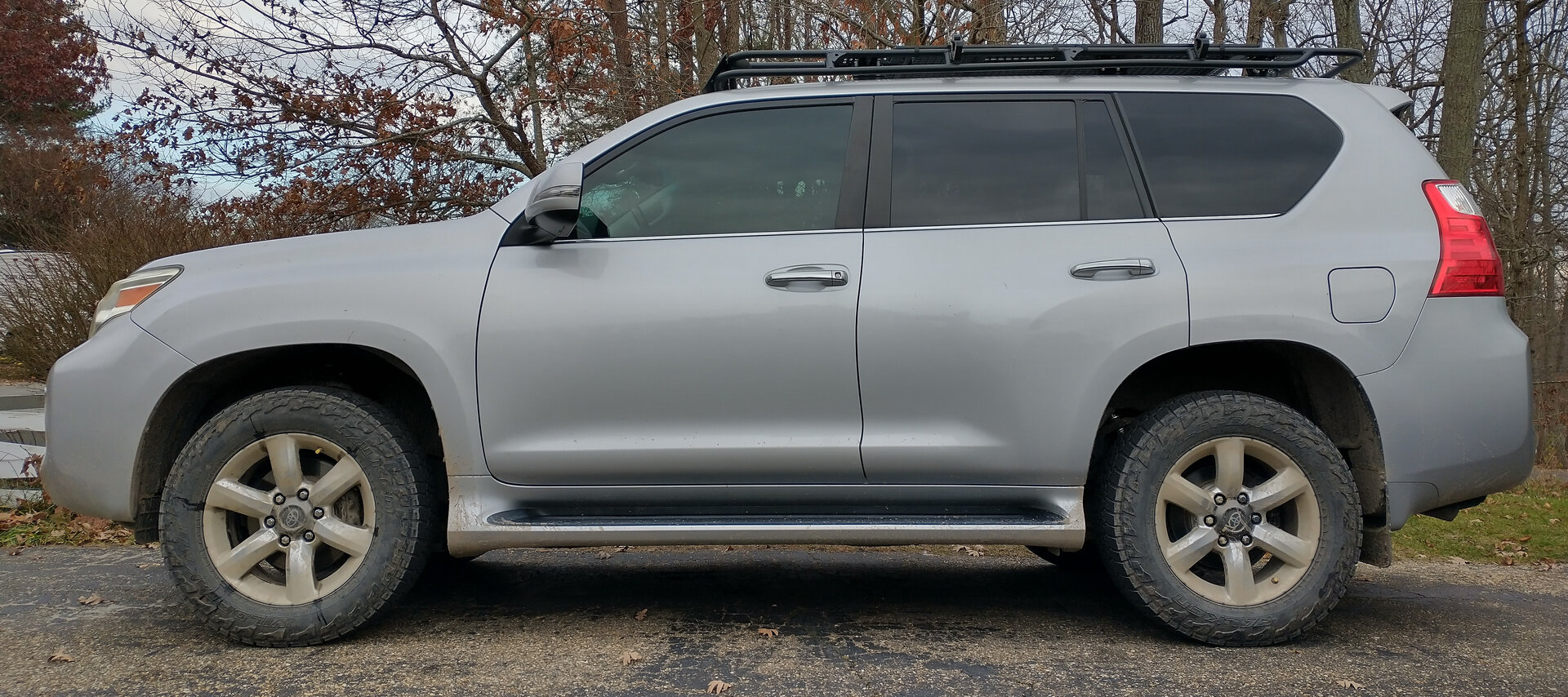

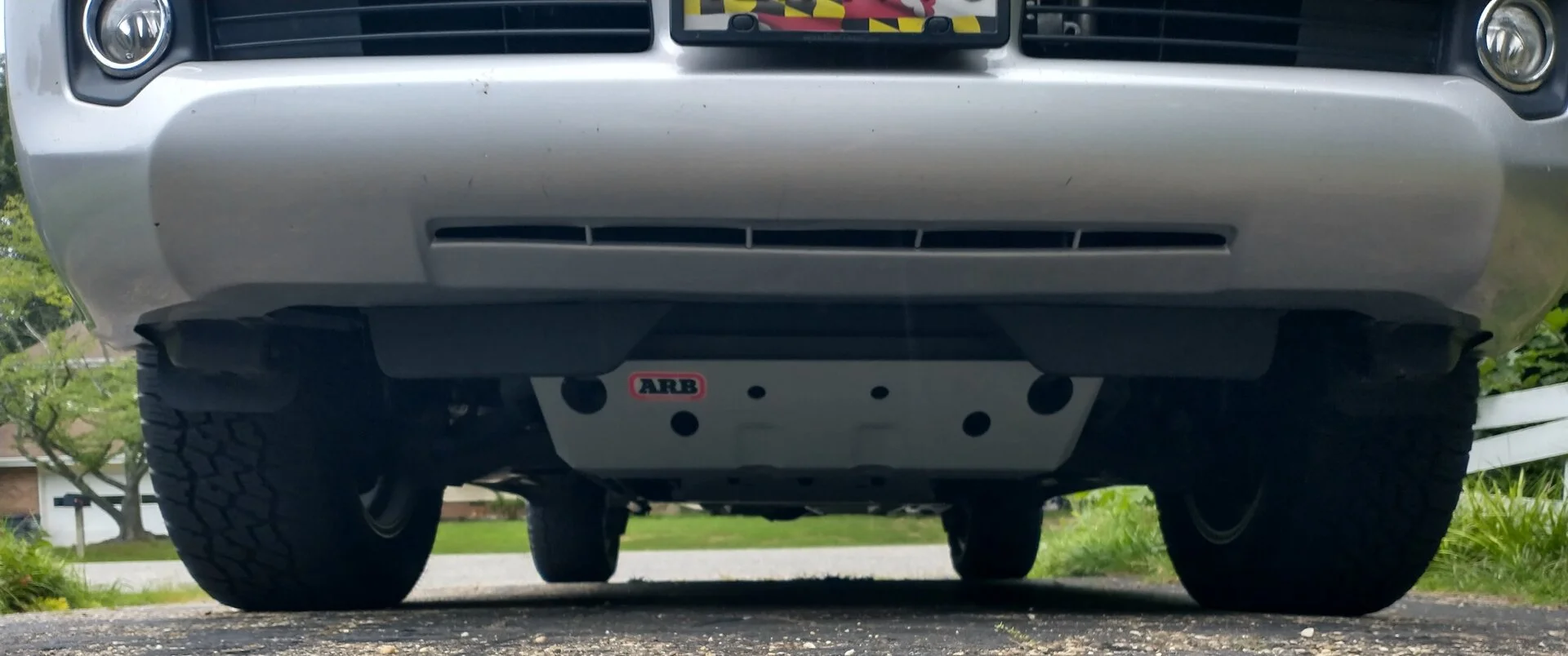

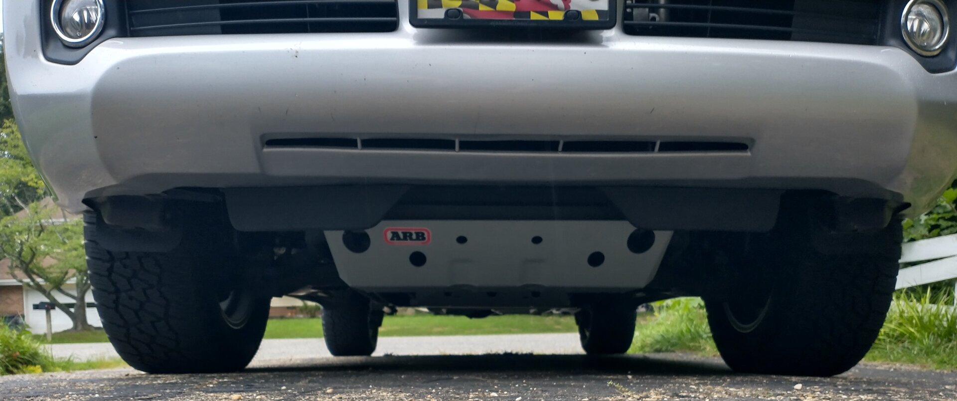

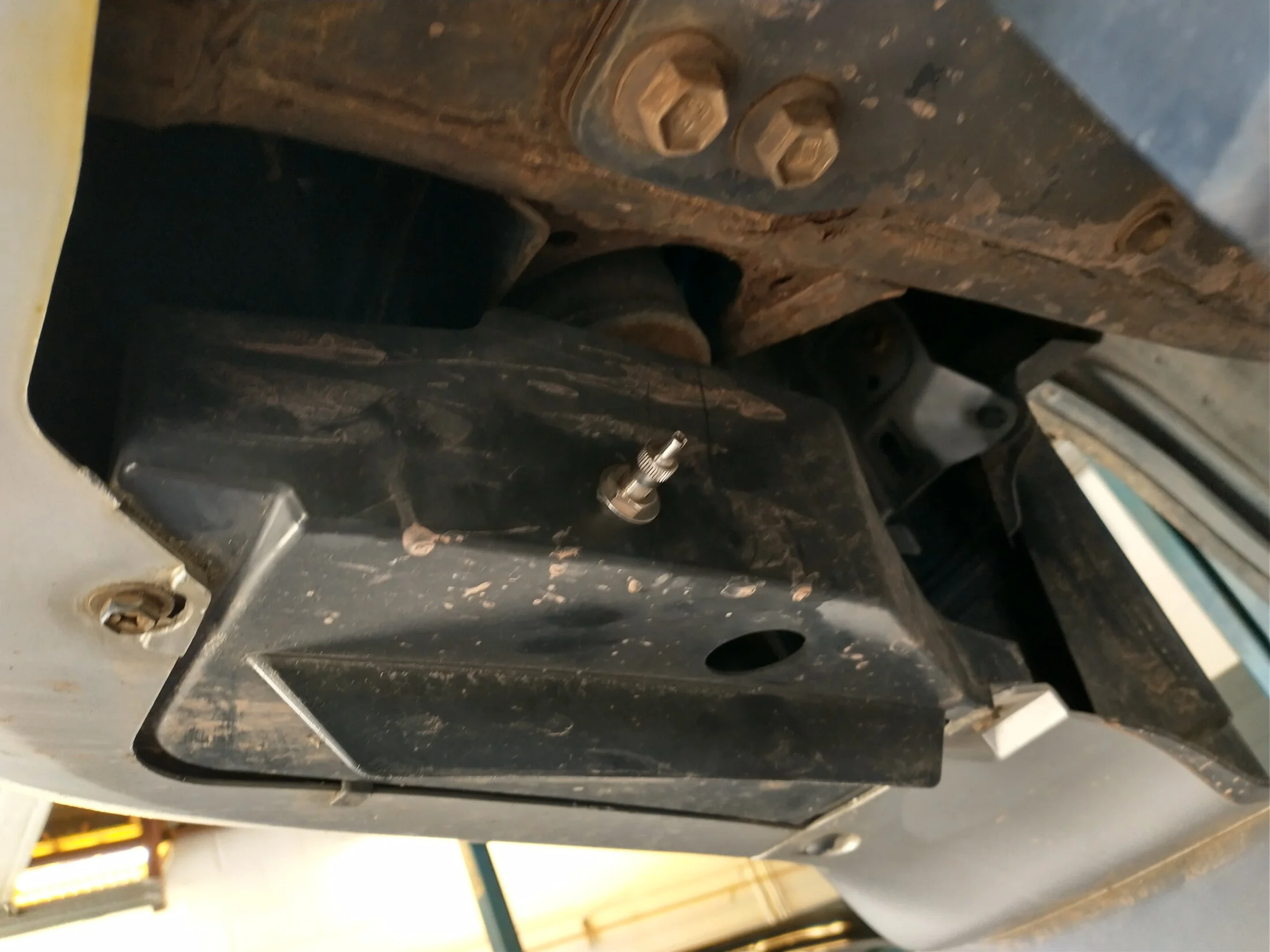

Mods cont'd: Skids done. I had read somewhere that the brackets were sometimes not aligned with the frame holes, so I was extra careful to get all bolts started by hand before tightening. Turns out that I must have got one of the straight ones because everything lined up nicely. Far stronger than stock and more than adequate for my application.
Unrelated but I may have witnessed the demise of a dozen or so Jeepers. Something about getting between a Mama and her babies...squish?
Great point about hand tightening!
Leading in the threads and hand tightening all the nut/bolts of an assembly should always be done first before tightening them all down.
One never wants to torque down the very first nut/bolt and then the next, and next, without having them all threaded on first.

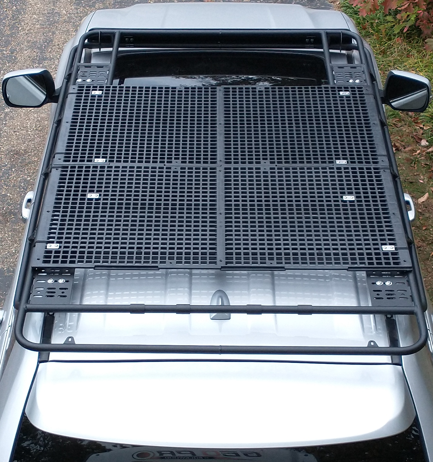

Mods cont'd: Rack installed a few weeks ago. Very impressed with the material/build quality/versatility.
Still have some minor adjustments to do but I have the primary configuration mapped out in my head. When the kayaks/roof box are needed up top, it can be done in about ten minutes. Still unpopulated by gear at this time but the basic layout is there.

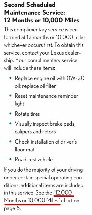

Because I read into things more than I should sometimes, I find it almost irresistible to point out that for us lower-mileage 2010 owners at least...we were not meant to ever see our second service appointment if going by a monthly schedule. 😅
Being the disgusting maggot I am...I waited until 120,120 miles to change my original spark plugs today. Original plugs looked good overall and gapped within spec. Definitely have some leakage in the cover/head seals but nothing I haven't seen before in my other Toyota vehicles and not enough volume to worry about.
The job wasn't terrible either. I tried out one of those GearWrench magnetic spark plug tools in 5/8" that someone here had mentioned I think. Very happy with the results.
I think the biggie on that list you posted was "Check installation of driver's floor mat" 😝

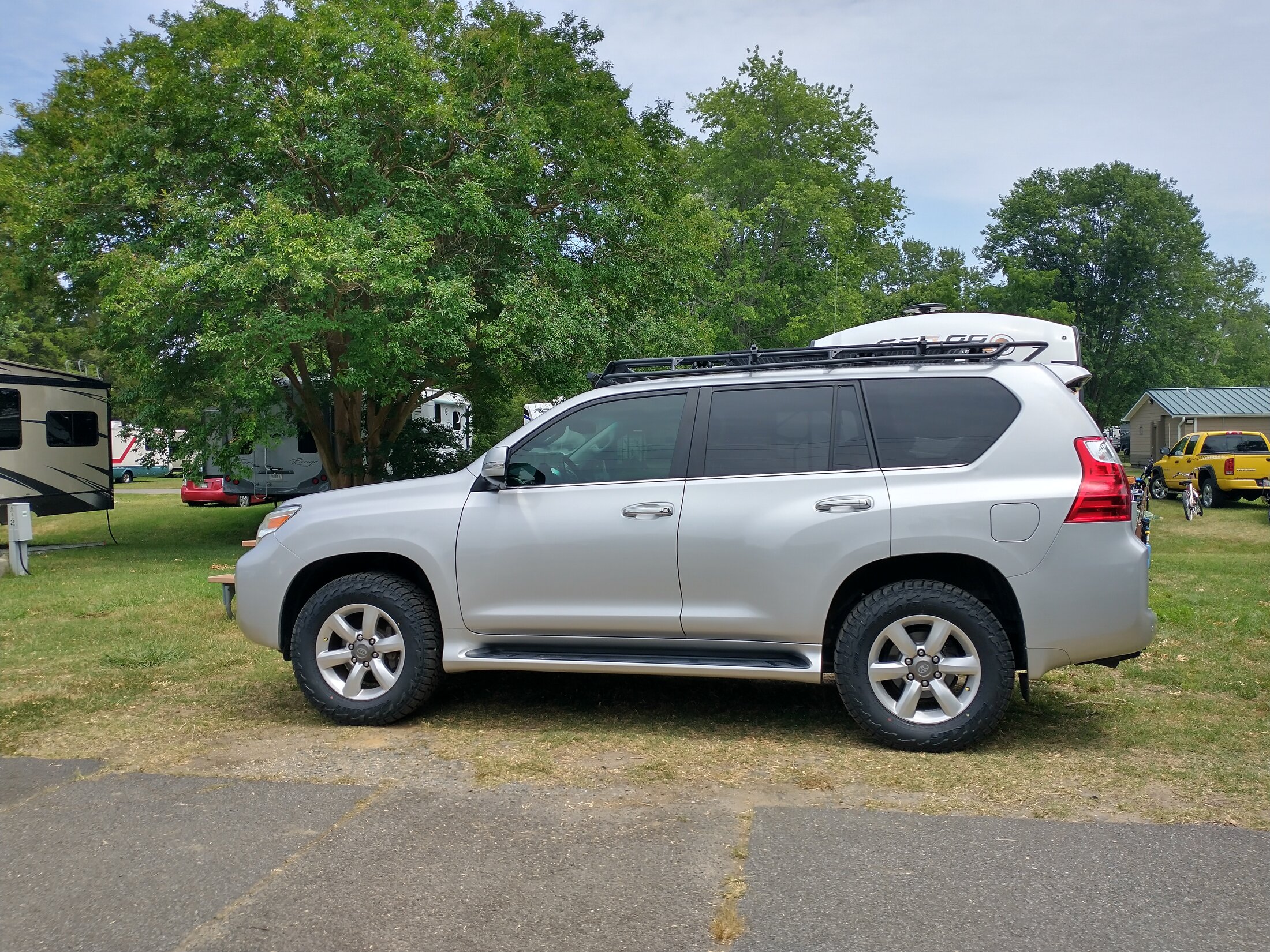

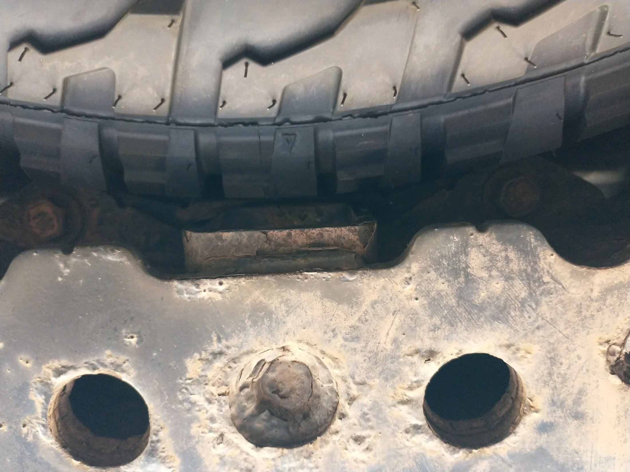

Mods cont'd: Finally installed the 265/65R18 Wildpeak AT3s. Spare fits with factory hitch but you have to adjust position while hoisting for the desired result. Ride is a bit better and the .5-1.0" of added clearance is nice.
We were waiting for fireworks to start near the river. Hot day but lots of fun.

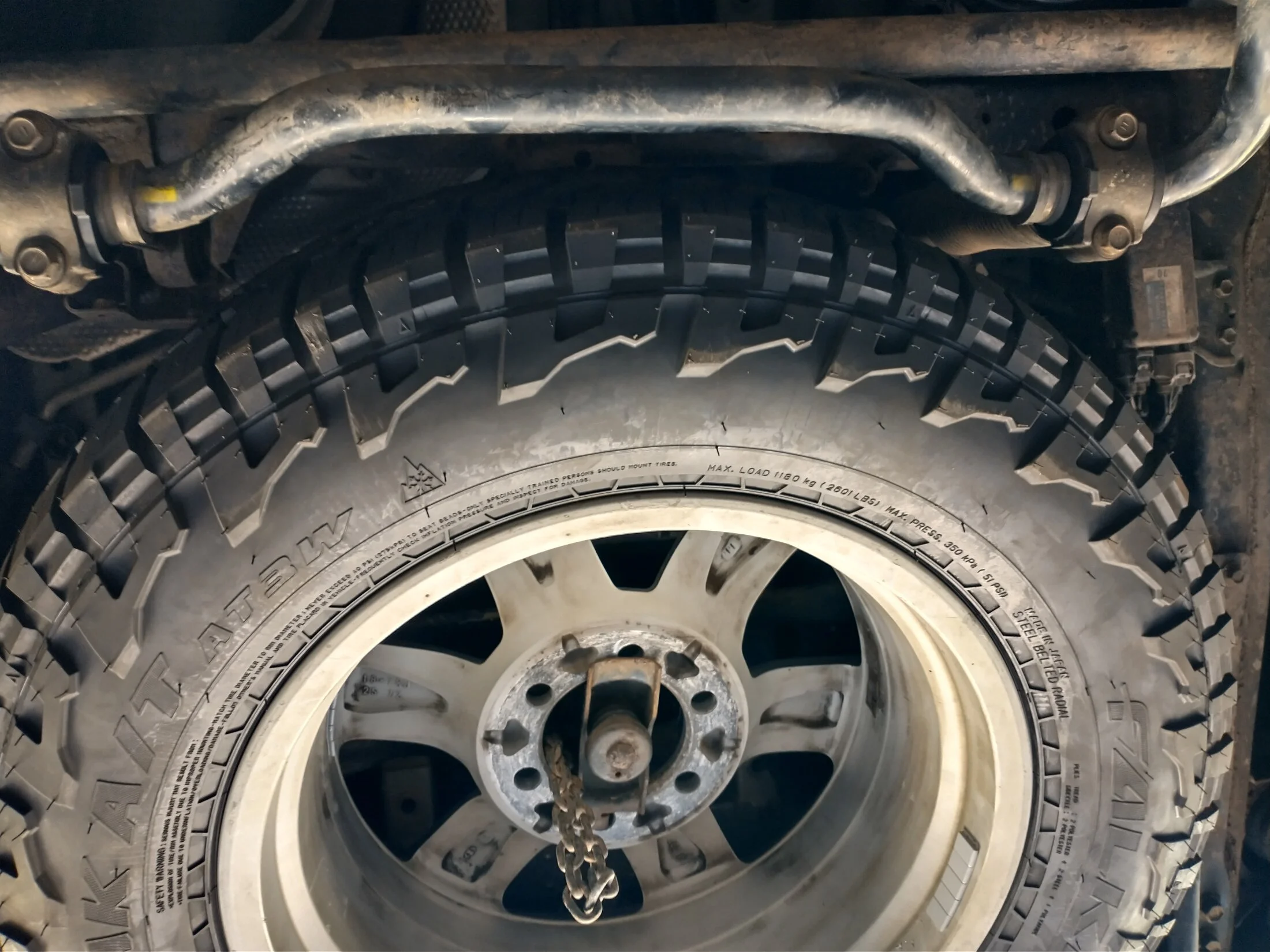

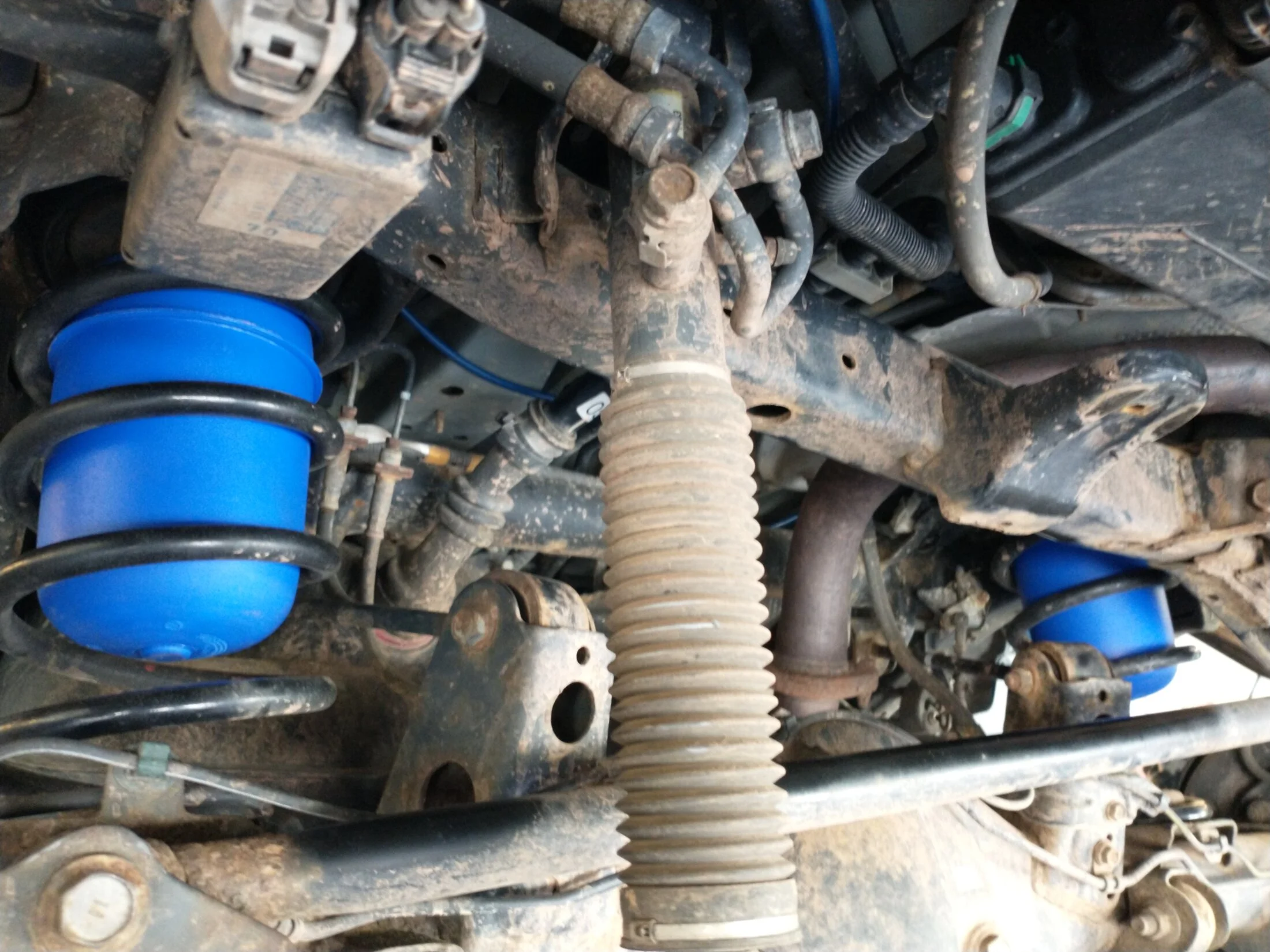

Mods cont'd: Finally installed the Firestone airbags. While I was in there I replaced the rear stabilizer (KDSS) bushings. They were pretty rough. I'll do the fronts in a week or so.
Also, an update on the new tires. I definitely have some rubbing but preventable enough that I haven't investigated yet. I did get a couple clearance photos of the spare (also 265/65R18 Falken WP AT3) to confirm fit with the frame mount hitch. You definitely have to guide it as it goes up.
It's close. 😯
