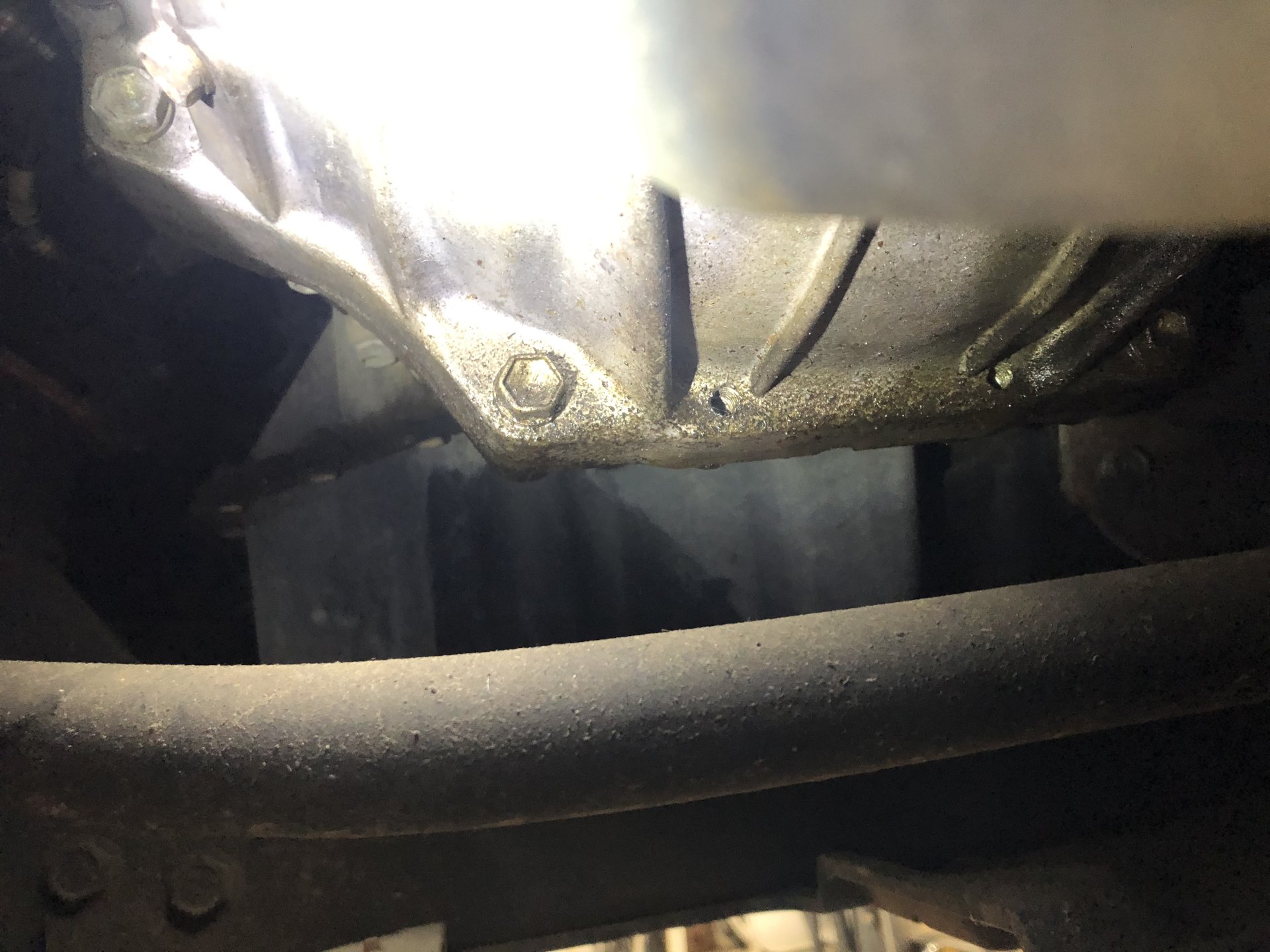

Currently living in the Ozarks and joining the ranks of Series 100 owners with a high mileage 99 LC. Looks like I will have enough left in the budget for some repairs and upgrades. The only leak I see is in the picture and would like to know if it is serious and how hard it is to fix.

Welcome to the forum and the world of Land Cruisers from a fellow Arkansan:) First of all that leak would most likely be your rear main seal. Mine leaks from the same spot. Absolute pain to fix and very expensive if a shop does it as it requires dropping the trans. Just keep your engine oil changed regularly and as long as it’s not dumping an excessive amount I wouldn’t even worry about it.
Clean the engine top to bottom then drive it and monitor for leaks. There's no way to tell where it's coming from when the whole drivetrain is covered in decades of grime.
Earlier this year I had an '03 Sequoia that appeared to have a leak in the exact same spot. It turned out to be originating from up top, leaky valve covers which is common on the 2UZ at this age/mileage. After cleaning the drivetrain well I snugged up the valve cover bolts and the engine was miraculously dry.
Try some AT-205 reseal. It is pretty good at revamping seals and gaskets.
Not to mention, you could put a pile of oil in it for what a fix would cost you.

Also I have a small leak like you have. But I think mine is smaller than what you show. I agree with @GTV its better to clean the whole engine and monitor the leak. Although in my case I can clearly see my valve cover on the drivers side is leaking.

Sometimes gently tightening valve cover bolts will buy some time with oil leaks.
