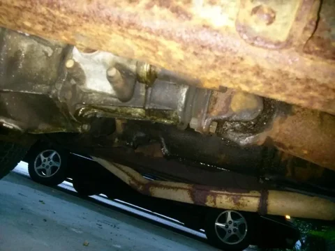

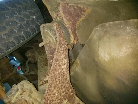

So, thanks you guys, a ton. I've started on my list but I feel like I need a more experienced mechanic to give me an opinion regarding what might be wrong that I can't determine. I posted some photos above and I don't really know what might be making the rear differential look like its leaking out of some bolt, but there's no fluid on the ground. Should I take it to someone for a comprehensive list or hope for the best? We have a very expensive restoration place in Hampton Roads, but I don't know what he would do for me.
These are not overly complicated vehicles. In fact they're pretty simple. Any mechanic worth his salt should be able to tell you everything you need to know/fix/repair. Honestly, I'd just post pictures up here and see what people think. Pictures speak volumes as to the issues to be addressed.
The differential "leaking" from a bolt sounds like a bad seal. It may just be slight "seepage" that isn't leaking enough to give you a noticeable puddle on the floor. My Front differential does this. Just check the diff fluid and make sure it isn't dry.

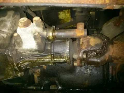

These are particular parts which I'm concerned about leaks or seal failures. I don't know what looks right, since I know there will be leaks.
I always classify loss of fluid by the amount loss. A leak can look bad because it collects in an area and dust settles there and makes it look worse. A leak that drips and marks a spot on the floor is of more importance to me. If it leaks while it is sitting still, you can only guess what it is doing while it's riding around.

There appears to be some serious FJ cancer there!

However the point of those pictures was to diagnose what was wrong in them. Can anyone help me out?
Hey jamba - based on the shape of the moisture spot on your differential, it almost looks like the crush-washer "seal" behind the fill plug has failed. Easily fixed with a new crush washer.
Not entirely sure where the other leaks are coming from - looks like you might have one at the 2WD-4WD shift shaft and another from the nose cone or the shift pod. The transfercase has a ton of seals - both rubber and paper gaskets. It's a bit of a bear to get down and reseal but, aside from being labor intensive, it's not terribly expensive to reseal. I think Kurt @ cruiser outfitters sold me a reseal kit for something like $20...
If you do drop it, obviously check the gear teeth for wear and make sure none of the bearings are wining, binding, or rattling badly. Last thing you want is to drop the case, reseal, put it back in, an have a bearing go bad a month later!

Also, how do I know if my frame is too rusty or unstable to put a suspension lift on? I only plan on going with 2.5 inch and 31 inch tires but I can't tell if that would stress the hangers too much or not.
