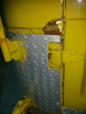

I have also been wondering...I want to take the top off for the summer, but where the rest ambulance doors are screwed to the tub, its very rusty... it won't support a CCOT or other tailgate I don't think. What are your thoughts? Thanks again all on helping me start the journey.
is it stupid rusty where the tailgate would bolt? or is the whole corner rusted out? if so, you'll want even that cheesy tailgate in place to help keep the body in place.

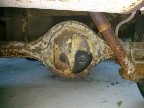

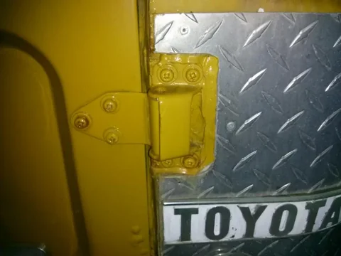

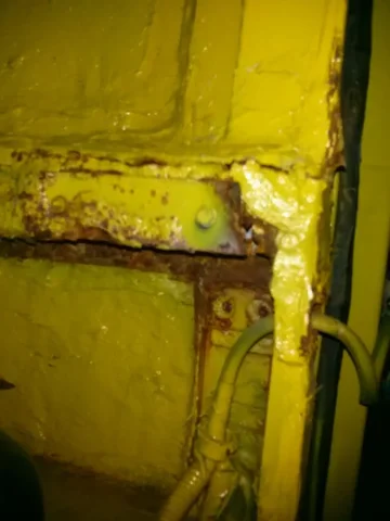

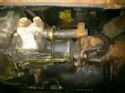

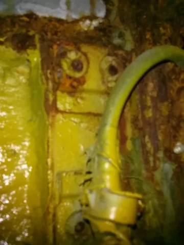

So the first four are where the doors attach. They appear to be very rusted or bondo-ed. And the last two are the rear differential and the transfer case...does this look abnormal?
I think I'm going to have trouble sleeping tonight with those images in my head.
This rig is the perfect candidate for an Aqualu tub. You will LOVE the results. How does the frame look?
yes, just don't run a tailgate :hillbilly:
