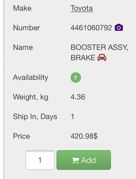

Not saying that you're wrong, but I would like to see that.
80 Series OEM Brake Booster Assembly
Cheers
I've only seen rebuilt OE brake boosters for $420-ish. Brake Booster, 93-98 FZJ80
If that is for a new OE part, it's a good price. Wish we could see the actual site...

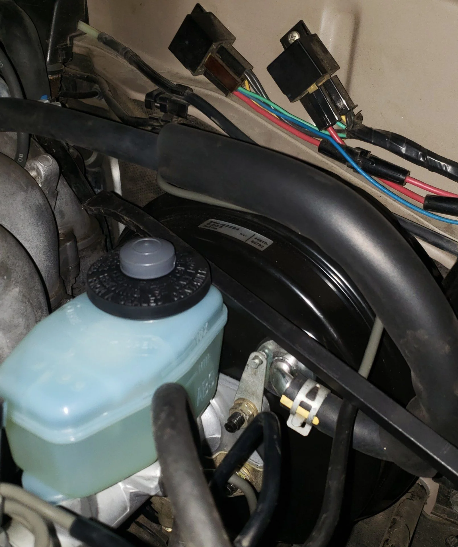

Installed my Seiken yesterday along with Aisin MC. Significantly better braking! View attachment 2334080
Thank you, yes you will be very happy. Japanese quality unsurpassed. I have sold countless of these over the roughly 3 years I have carried them, people really like them and they work very well.
