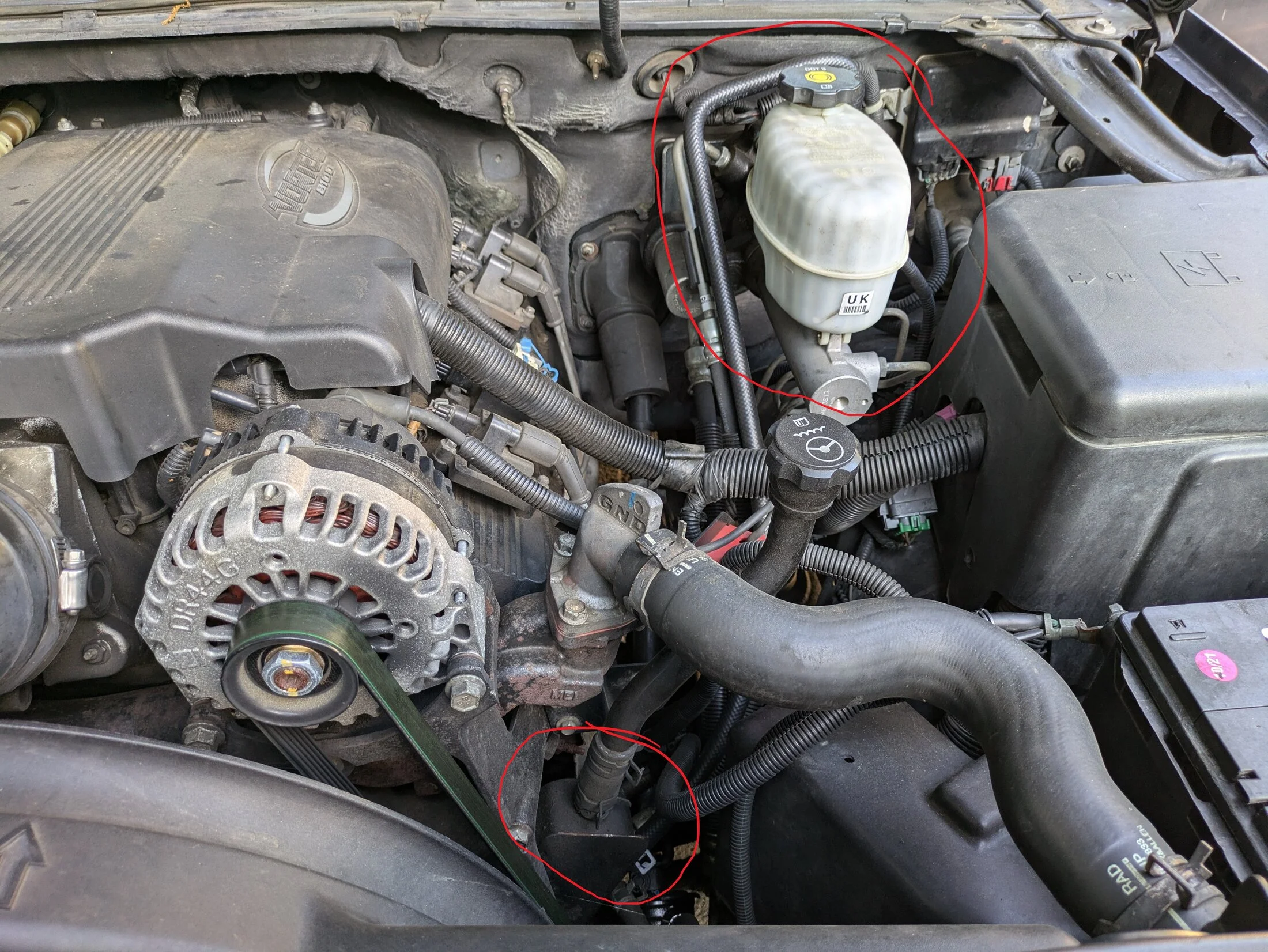

This is on my 2003 Suburban. The hydroboost is much higher than the pump and reservoir.

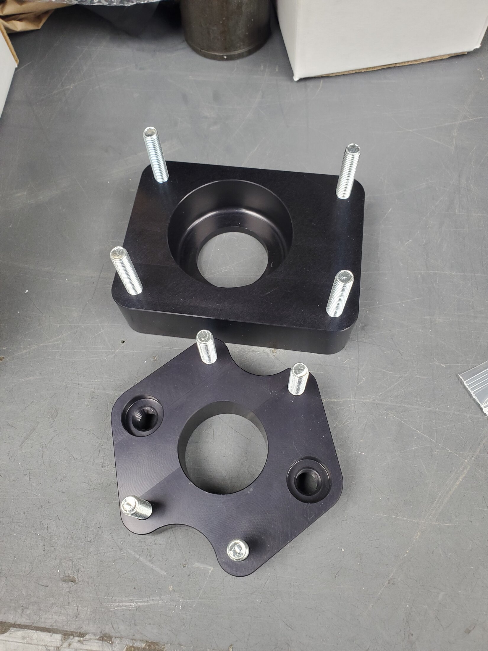

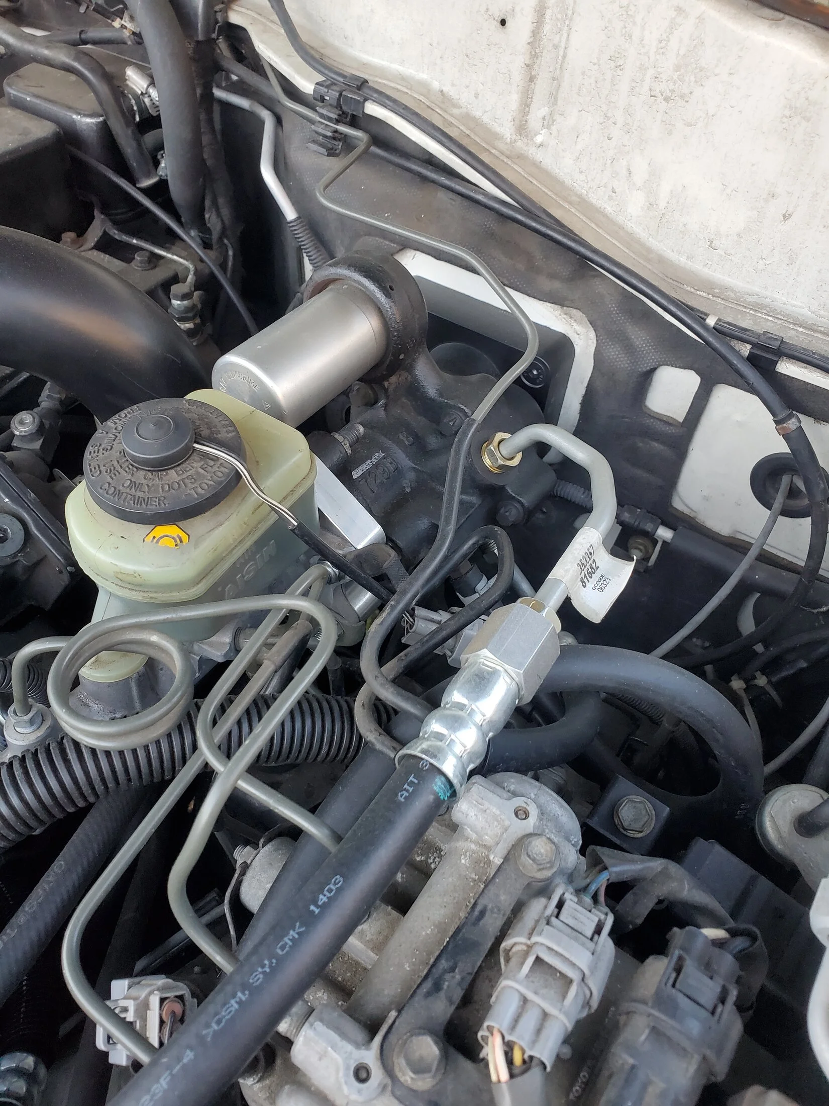

Here's the setup in my driver.
Here's the firewall and master adapter. I don't have a good picture of the pedal bushing, sorry.
Wow, gorgeous adapters. Does the Super Duty booster not have the little anti-rotation tab?

It has the tab. It uses a stainless ball bearing instead of the tab.
