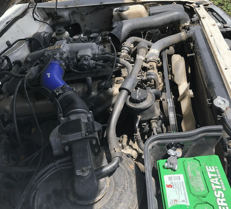

Hows everyone doing today?
Anyone know where i can buy a new (not refurbished/rebuilt) radiator?
i got a 91 fj80 jdm btw
thanks

my bad thought i had auto in there. also its gas NOT diesel (not sure if that matters)
Yeah its an automatic does anyone make a real good after market one?
if not does the secondary heat exchanger take up a lot of space or will it fit nicely?
is there any other options i have besides getting a manual one and installing secondary exchanger?
if im doing engine swap does that chance what kind of radiator ?

So what truck do you actually have? What is its designation? FJ80? Carbureted or fuel injected? 3F or 3F-E?
If you have the gasser engine, and you have either of the engines above, then there are no radiators available from Toyota anymore.
You would need to get a comparable radiator for a US-spec FJ80 from any source you can find at this point.

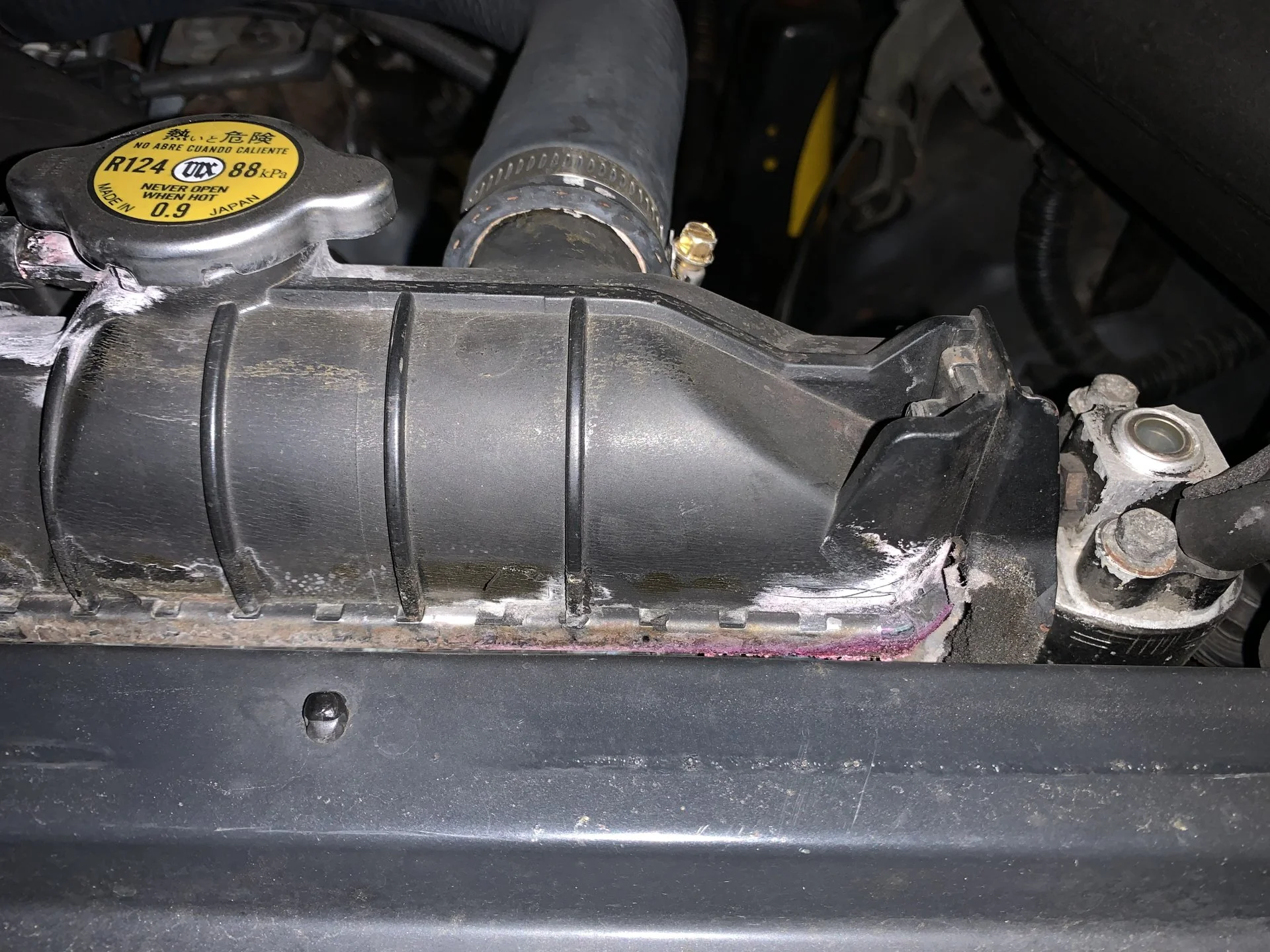

FYI, here is the radiator that was in my 91.

Also, if you have the original brass radiator I would definitely consider finding a radiator repair shop that can just rebuild it. Old school brass radiators can almost always be rebuilt and brought back to new condition.

thanks man sorry again, found a good company that makes them PRC but I cleaned out my heater control valve, replaced air intake hoses, flushed block and radiator, replaced thermostat, did the test on rad cap to check for leaking oil so head gaskets good. over heating seems to have stopped for now.
