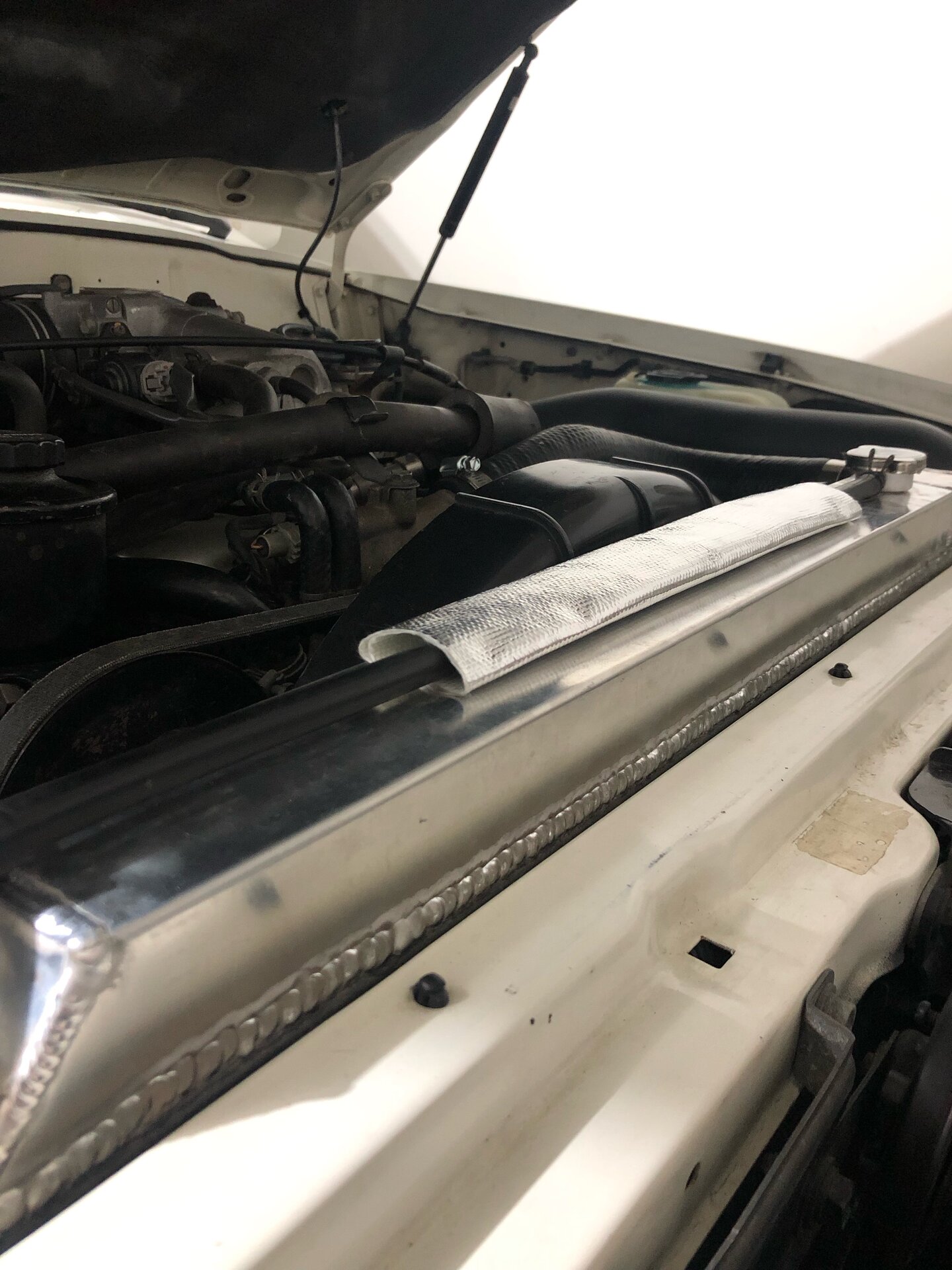

I went with the Liland Aluminum… taking out the OEM Rad is a bish of a job btw.
