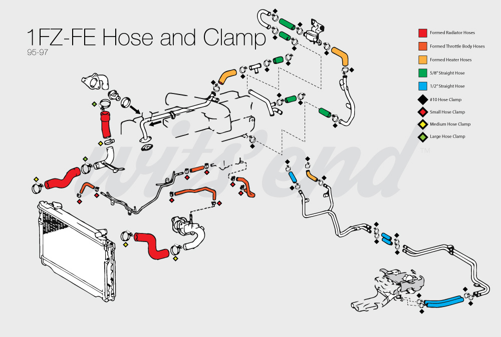

Big radiator hoses
Little coolant hoses
^ water bypass is in there, includes clamps
PHH hose w/ clamps
His diagrams & explanations on the product pages may also be helpful
Not sure on clamps for the big hoses, but there’s some good info in this thread:

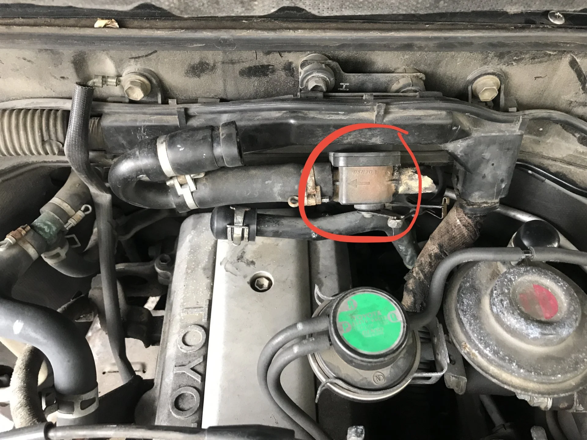

Re: visual inspections, I would take a look at your heater control valve now to see if it needs replacing. Usually they start to look like this (not my picture)
