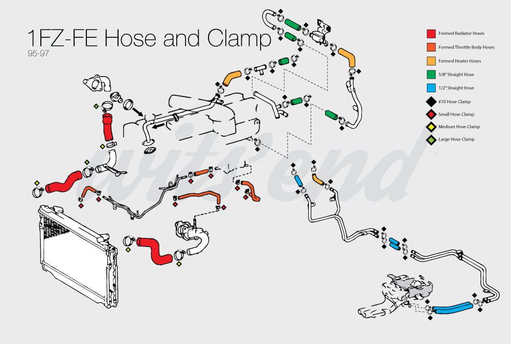

Before I post I did some digging around on google and used the search button, and just wanna double check before I place my order.
I'm looking to replace all the hoses & clamps on my 80 as it is pretty old at this point.
1. 80 Series 1FZ Curved Heater Hose Kit - https://absolute-wits-end.com/80-series-1fz-curved-heater-hose-kit/
2. 1FZ-FE Engine Little Hose Kit - https://absolute-wits-end.com/1fz-fe-engine-little-hose-kit/
3. 1FZ-FE Radiator Hose Kit - https://absolute-wits-end.com/1fz-fe-radiator-hose-kit/
I think those 3 hose kits should cover the majority of the hoses, and I am thinking of replacing the 5/8 & 1/2 straight hoses w/ Gates Green Stripe.
As for clamps How much better are those constant torque clamps for the price? I'd love to grab the best but would like to somewhat stay within a budget...
If I remove the clamps in about a year would I need to change the OEM clamps again? What about the constant torque ones linked below?
1. 1FZ-FE Constant-Torque Radiator Hose Clamp Replacement Kit - https://absolute-wits-end.com/1fz-fe-constant-torque-radiator-hose-clamp-replacement-kit/
I still have some more digging to do on the PHH, but looks like Witt's End has some kits that seem pretty straightforward but if anyone wants to stop by and give some advice or tips let me know!
Thanks

The constant torque clamps are not needed (none used by toyota when your truck left the factory) @NLXTACY also stocks the original spring clamps which work a treat.

Ditto. Wits end hose kits are spot on! I def need to get the spring clamps from @NLXTACY , just haven't gotten around to it yet. :)

Breeze constant torque are on National backorder. I sometimes get 5% of what I order weeks after the order. Just FYI. Otherwise I have everything else.
Darn, do you think I could reuse the OEM clamps (New OEMs) after about 2 years?
Also is there a special tool i should use when putting the clamps on or off?
Certainly you can reuse them!
All I use are simple slip joint pliers
