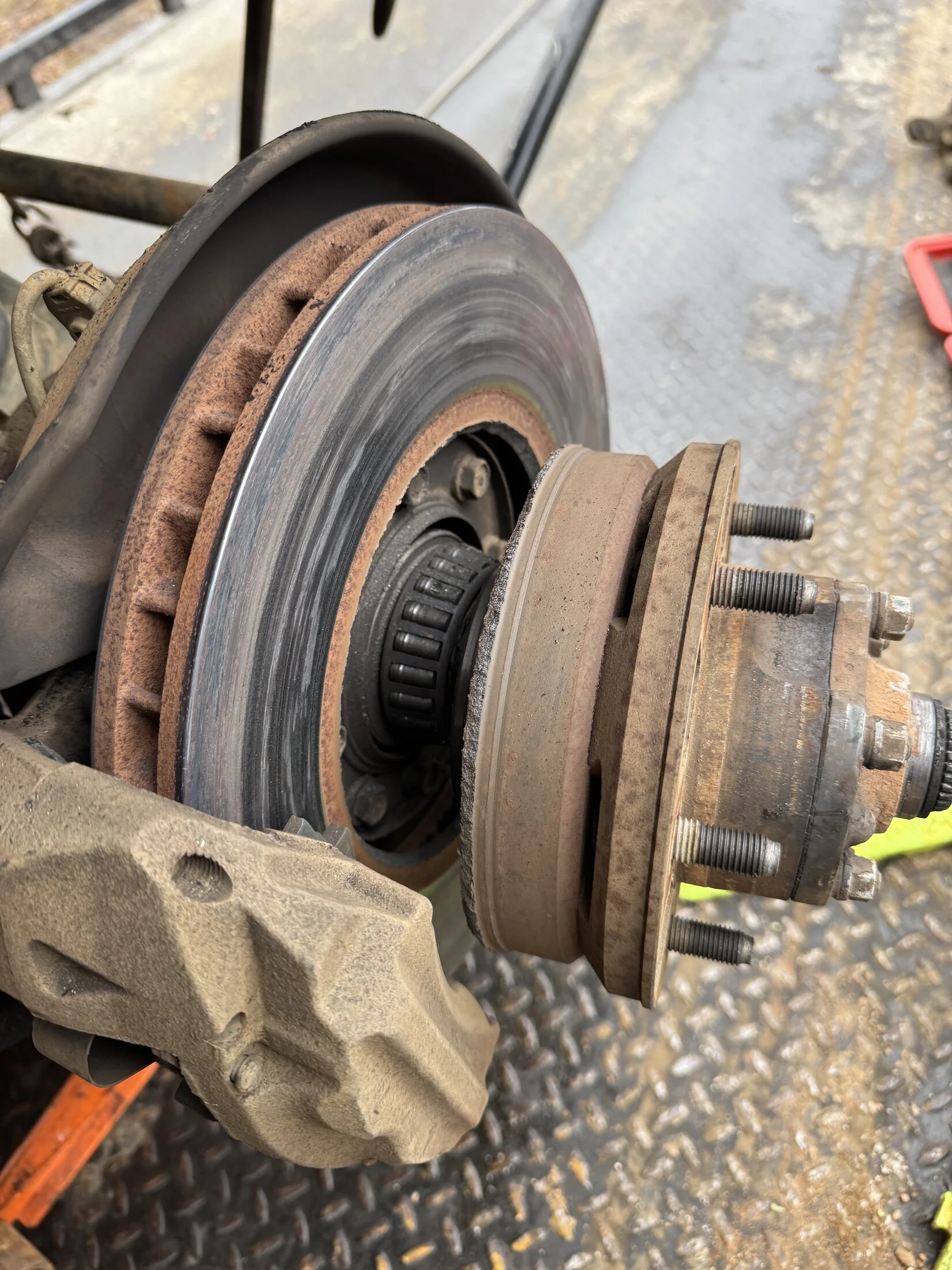

As the title states - was ~10 mi from camp last night when my ABS light went on and started losing brake pressure, stopped to see my front rotor was smoking and outside pad was askew and pressing against it. Took the wheel off, straightened out the pads and attempted to limp on into camp. Didn’t think to check the wheel for play or suspect a bad bearing…
Made it about half way before the rotor gave out (it was red hot) - see pics for carnage.
Question: I know I need to replace the front axel hub assembly, rotor, pads, bearings, seals, etc…. I haven’t torn it down yet but should I be worried about the spline shaft as well from the super heating? Anything else to fret about??

You may have trashed the spindle.
Very likely. You may have damaged the outside surface where the bearing seats and you may very well have damaged the inside of the spindle and the birfield. The is a good chance that the weight of the rig was resting on the outer stub of the birfield via the spindle with massive friction and heat and gouging and melting of metal ensuing. Seen bearing failure like this a couple of times that required replacing rotor, pads, bearings, spindle and birfield. And of course inner axle seal.
The hub itself should be okay.

That looks like quite an accomplishment!
The hub and flange are still buttoned up, but the inner bearing is fully exposed!

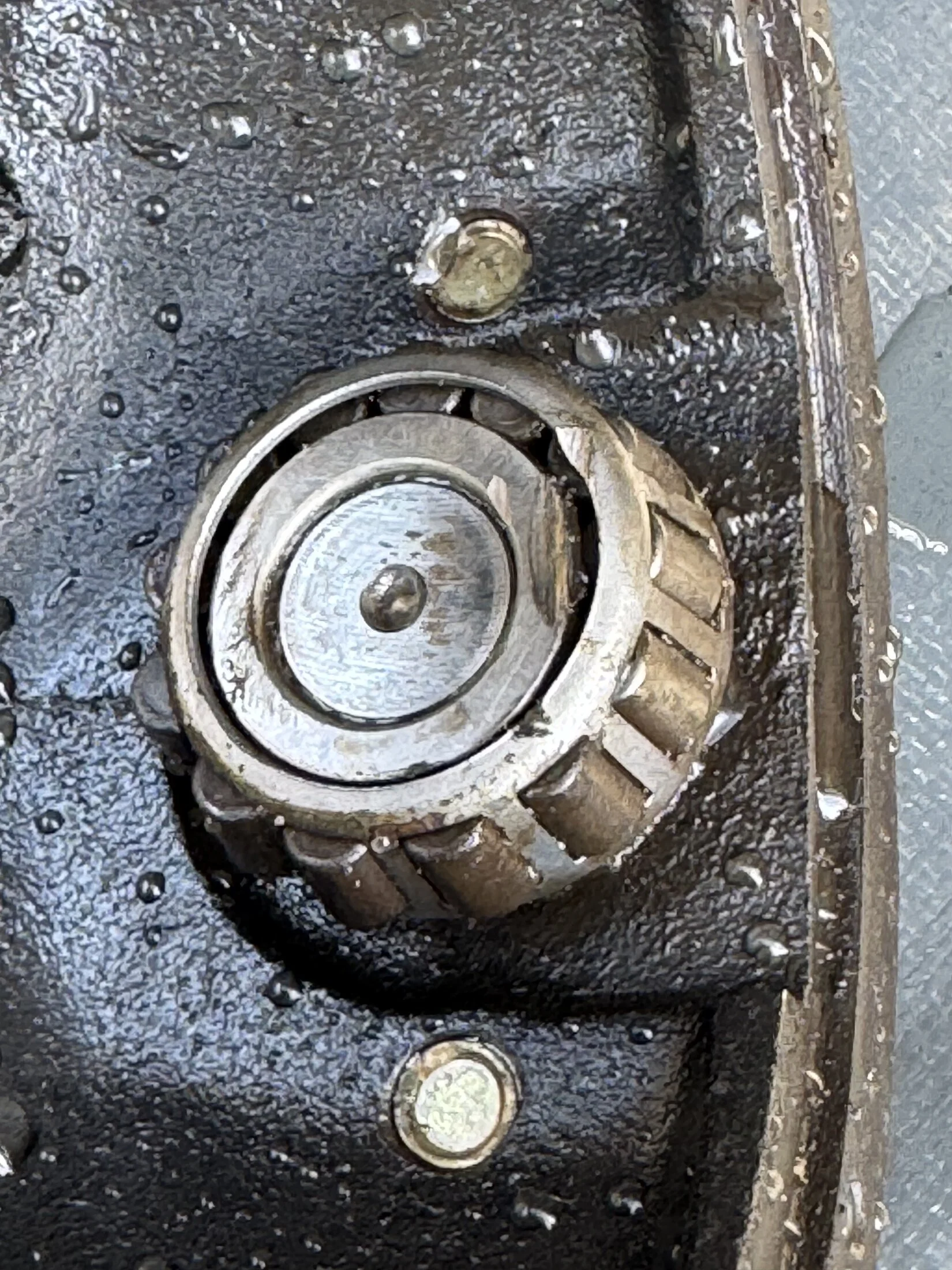

Show us pics of what you find when you take it apart.
I'm gonna guess a bearing siezed and spun the thrust washer and 54mm nuts off the spindle. Spindke is likely chewed!

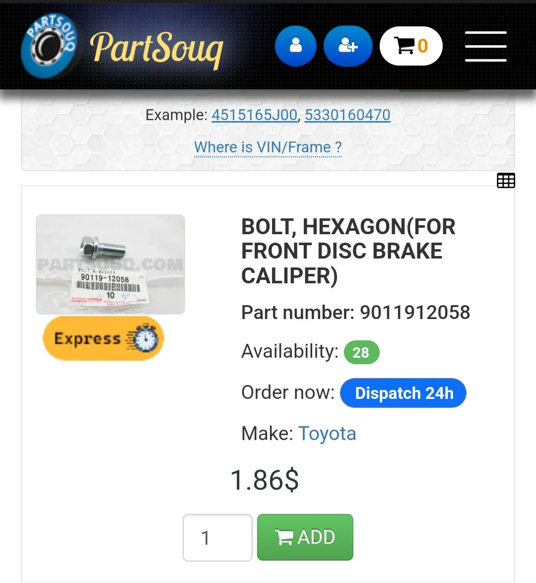

what is the part number for the bolts that secure the Axel Hub to Disk? Going to be a PITA to separate now that the hub has broken off the main disk and figure I should just buy new hardware throughout incase the heat / stress did damage - I've got like 40 parts in my bin at Olathe Toyota, but couldn't track down these bolts despite some a fairly exhaustive searching... thanks in advance
If you don't locate them by tomorrow morning, consider giving the parts department at Olathe Toyota a call. I've found them super helpful in the past when I can't locate a part online. Unlike many of the dealers that also sell online, they are happy to help and always have a positive attitude.

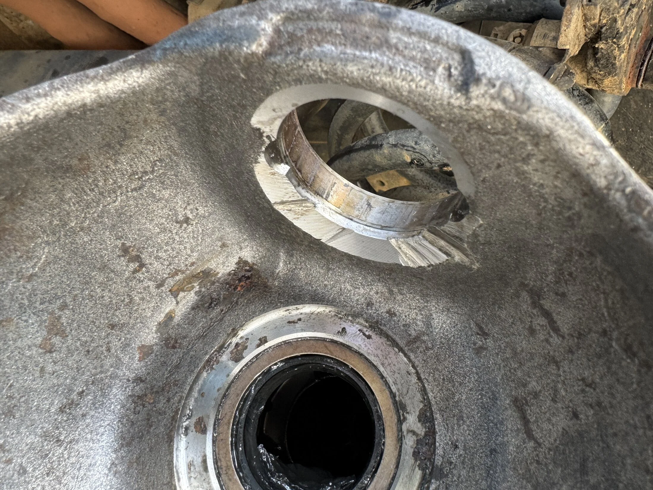

What parts needed replacing?
How do the spindle tubes look? Spindle bushing trashed?
Got more photos?
