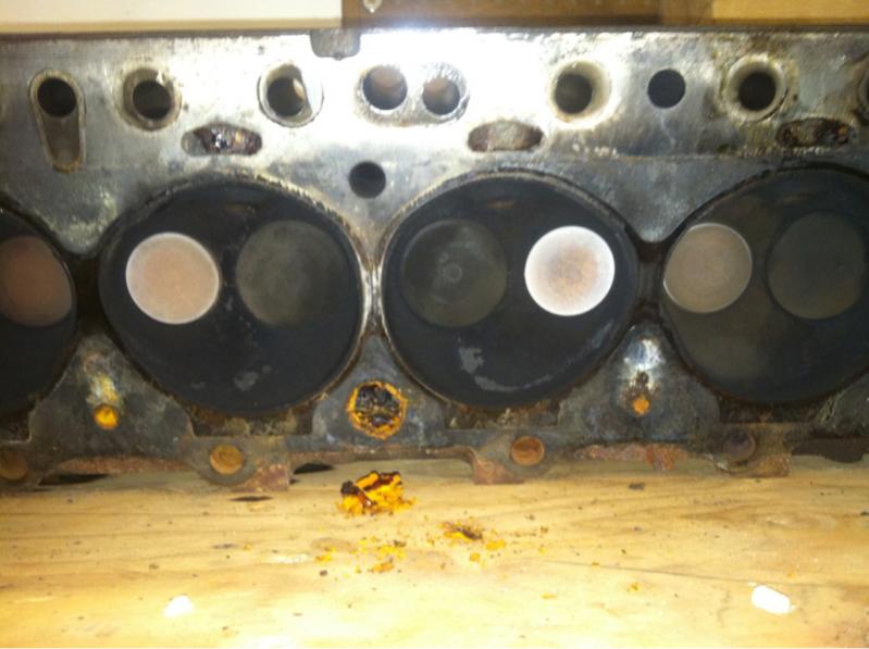

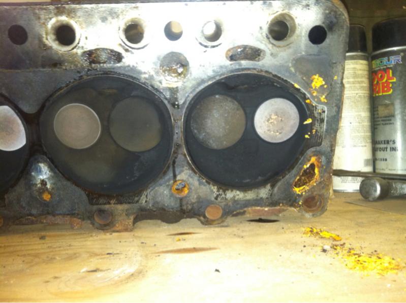

Are or are not doing valve job? #6 looks crusty

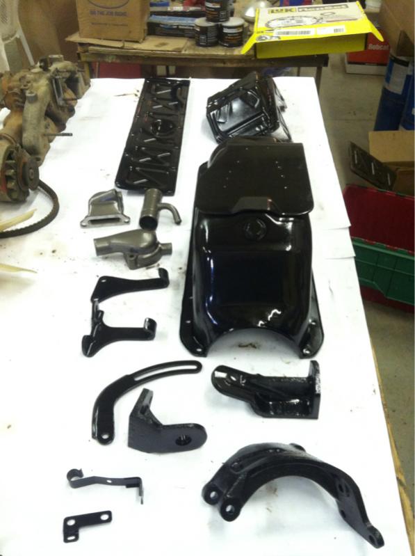

One setback, severity as of yet not determined. I spent the day today with a friend blasting, cleaning, and painting engine components. I also powder coated a couple of parts - my first attempt at that. I was surprised how easy it was. Granted, I did only a couple of small parts, but it is a straightforward process. I also was fortunate enough to have a friend volunteer to run my oil pan, side cover, and clutch dust shield through his caustic tank. Made cleanup a snap.

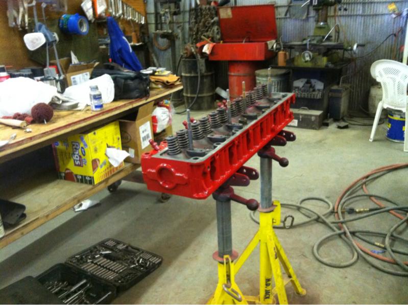

I also picked up the head after having the valves ground, new seals installed, and getting it surfaced. They ended up taking about 0.020 off to get everything smoothed up. That'll be the last part that needs painted before I can begin reassembling the engine.
Sent from my iPad using IH8MUD
Beautiful. Great progress. Keep the pictures coming...
A little more painting today. Finally finished up the head.
