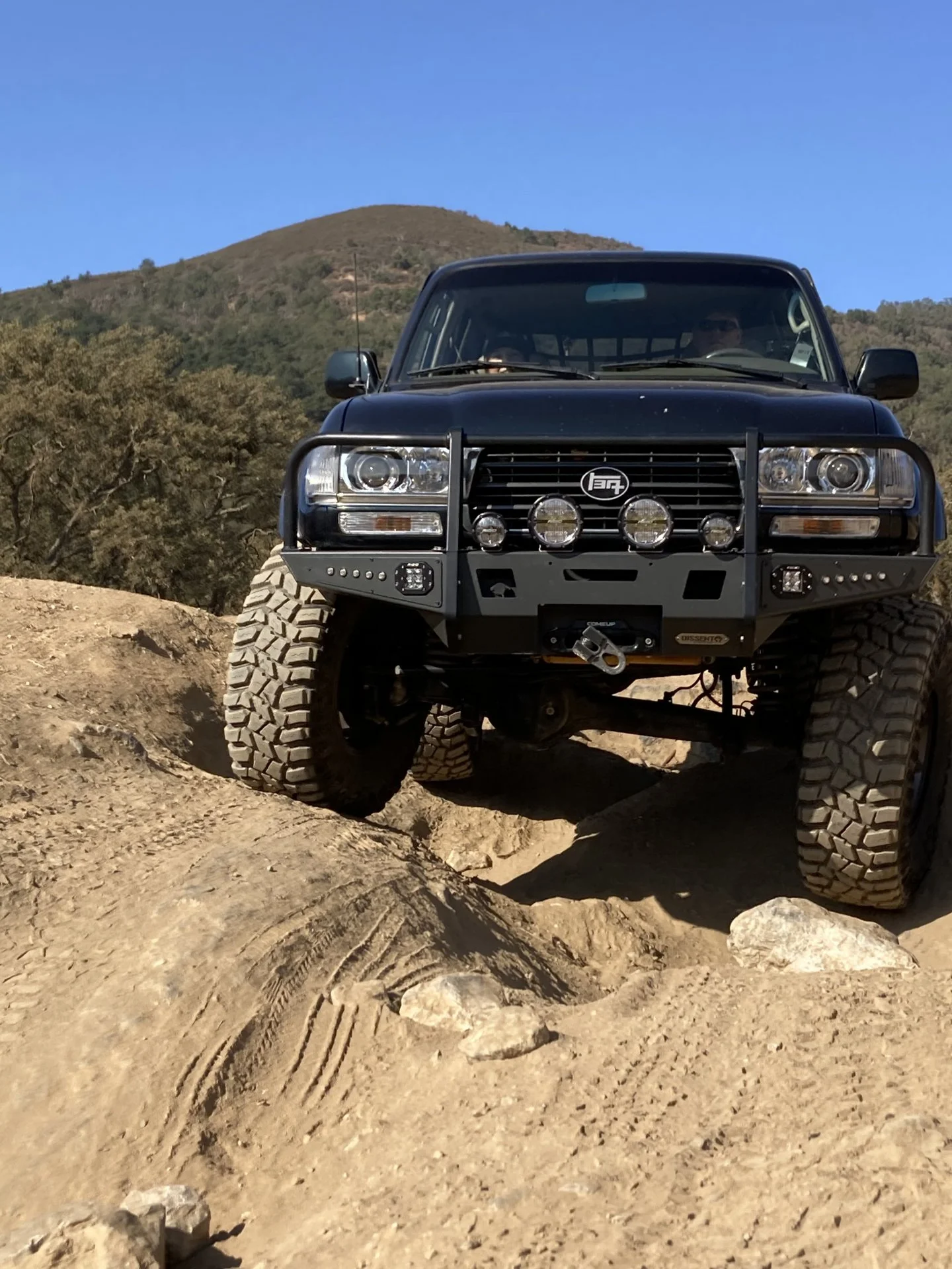

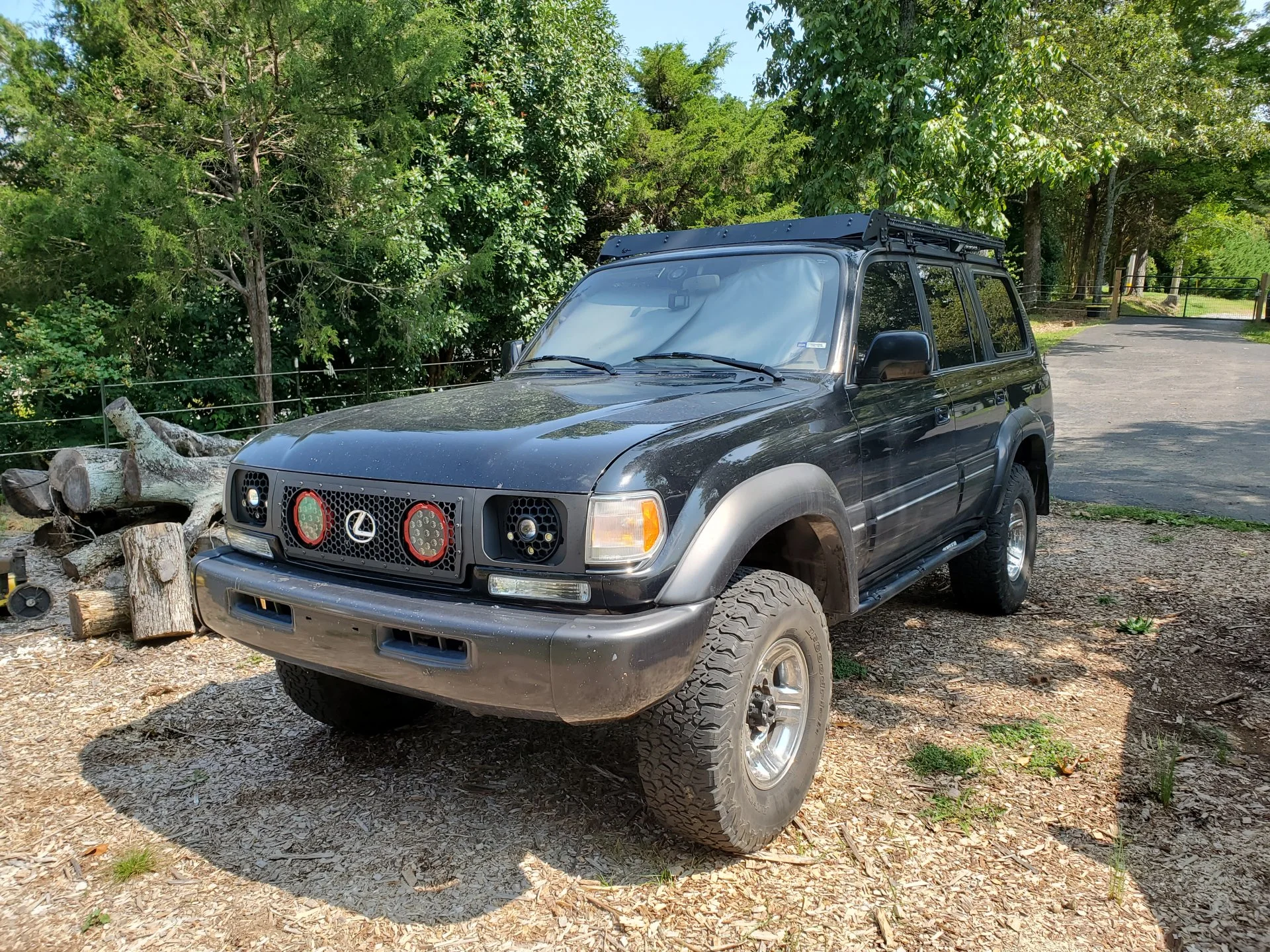

I went with @kelly saad's replacement grill solution and some 7" HID projector housings from Dapper Lighting. Added some LED aux offroad lights in the grille.
