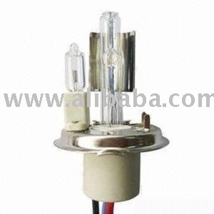

Wow, I'm impressed, talk about a mickey mouse deal (see the photo below). So you are using an HID capsule which has the wrong focal point and length for the H4 fixture, and then have a "hi beam" that is so far outside the focal point of the reflector it might as well be located in the parking lamp fixuture (see the below photos of an H4 lamp and the HID crap rebase).
If you are serious about getting real, usable light out of your FJ, you will throw that conversion out and go to the Osram Hyper H4 70/65 or 85/85 lamps (the larger may require a relay upgrade). Susquehanna MotorSports - Auto Performance Product
For reference here are the outputs:
Standard H4- 1650/1000 lumens
Hyper 70/65- 2000/1350 lumens
Hyper 85/80- 2400/1750 lumens
For comparison a 6000k HID fixture is putting out 2800 lumens.
With the correct focal points and higher color renditioning of the hyper H4 bulbs, you will put out far more light on the road than the rebased HID kit you are using. You will also not blind other drivers. It is a win win.
I spent alot of time trying out different headlight bulbs and setups over the years and these are by far the best I have use. I spent alot more time adjusting them around to give optimal light output on the road and minimum glare to on coming traffic. Blinding other driver sometimes cant be helped? For example a lifted truck verse low sports car, its going to bright them no matter what you have. Like I said before, I use to get flashed in my FJ along with other trucks I had with OEM setups. It just happens sometimes.
Honestly cars with OEM HID setups like BMWs and S2000s look bright to me sometimes......actually most headlights are bright if you stare at them. When dealing with lights like that I just look to the lane marker on the right side....its not hard.

There is no way to adjust the HID swap you have to prevent excessive glare, the lights are throwing out a ton of light way above their designed cutoff because you have moved the focal point so far the reflector and lens can no longer focus the light. I would love to see a wall shot of your lights. See below what a proper retrofit looks like compared to what yours looks like.
