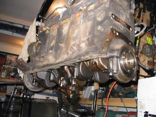

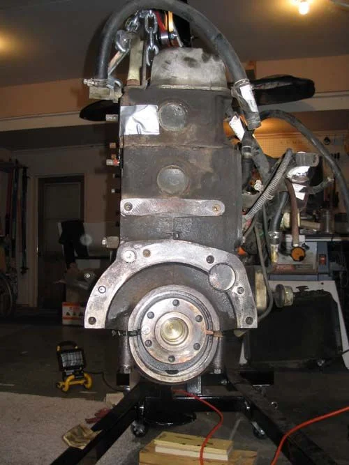

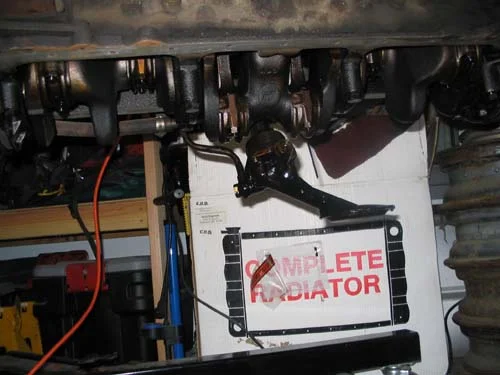

Thought I would share a couple pics of the fun. Mostly boring pics of the exposed 2F guts...

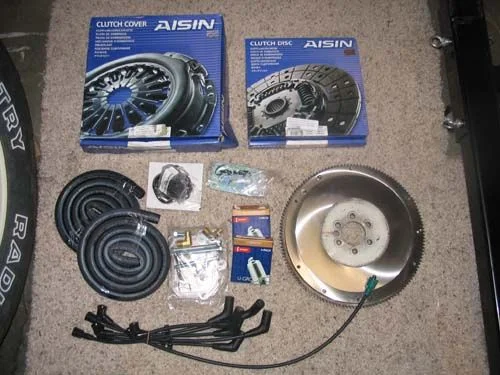

Also, seperated the '81 intake and brought it to the Napa machine shop for them to clean up and inspect it for me. It should be done next week. Here is a pic of the rest of the new goodies, including the resurfaced flywheel the machine shop cleaned up for me. It's been bitter cold lately and I haven't been motivated to wrench in my barely insulated/non-heated garage. Hope to get something done soon...

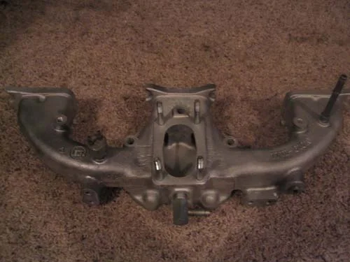

Here are a couple pics of my intake manifold after I picked it up from the machine shop. It was warped so I had it resurfaced and cleaned up as well.

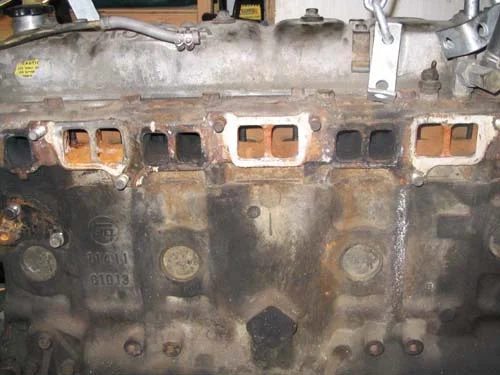

So the donor block is quite a bit more rusty than the original and I noticed a bunch of rust and carbon deposits where the intake and headers mate to the head. Should I be alarmed? What do you folks think I should do about it? If anything? Slap it back together? Or?
