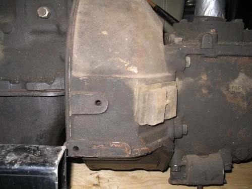

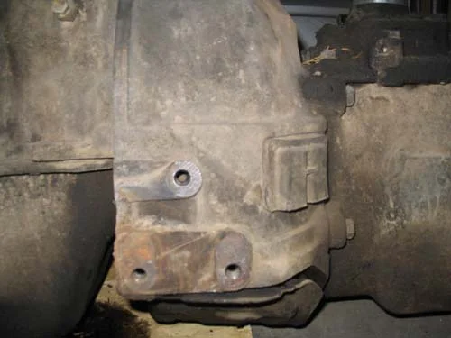

Had some time this weekend to work on the pig as well as had help from a couple friends. So we hooked up the donor engine and tried to squeeze it in. It was a bit premature however, I had not had a chance to swap any parts from the old engine yet and had not figured out all the differences in these two setups. So it was a bit of trial and error. We eventually tried a few times to wedge the new setup in but I was not totally aware how many little things I needed to address first. So the donor setup sits on the floor again.

The rear engine mounts on the orig. '77 FJ55 engine have three mounting points per mount and side but the newer, '81 FJ40 engine only has two but also incorporated a crossmember. I wasn't planning on using the crossmember and was wondering if I should just drill, and then 'tap and die' the new holes (one on either side of the bellhousing) or if I should go through the trouble of swapping bellhousings? Seems like a pain to swap out bellhousings unless folks think I shouldn't mess with drilling the newer housing.
Also, which transmission and transfercase setup do ya'all suggest? The newer '81 or the older '77 or a mix 'n match? I also realize if I use the newer transfercase I lose the drum mounted emergency brake. Can the drum mount be swapped to the newer '81 transfercase? Or am I stuck with getting a disc brake conversion, line lock, or rear disc brake/emergency brake combo? Just trying to 'wrap' my brains around all the options in order to make a good decision. Thanks for any advice.
Oh, and I guess I will probably have to shorten my rear driveshaft also. Was hoping to get this done by Christmas as a gift to myself but I'm losing faith.

I know this probably isn't too much help, but since you asked.
Personally I would use the '77 for the bellhousing, trans and t/c. My vote is to keep stuff simple. Then you aren't in too deep with mods and you can sell that nice split case.
Put it this way, we could have that engine back in your wagon within two days if you keep the origional parts. Also, you will get a good look at the clutch on both trans and choose the best one.
Dave
Dave
Your'e probably right Dave.
K.I.S.S. Keep it simple stoopid!
I guess I was hoping to use the best of all parts but it seems to mean more headaches also but, if I can figure it all out I could be up and driving soon. Hmmm, mabe I should toss that newer 4 spd and split case in the trail pig...

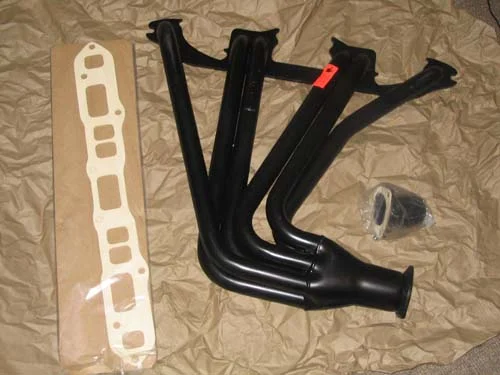

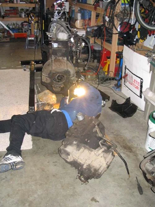

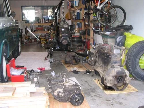

So, worked on both engines today and had some help. I have decided to swap everthing behind the engine, bellhousings/trans/tranny, etc. As mentioned, this should solve my driveshaft length issues, emergency brake issues, and any other problems.
So, onward! Got a couple pics to share. One of the header, one of the chaos in mid tear down, and one of my buddy Dave 'gittin it'.
