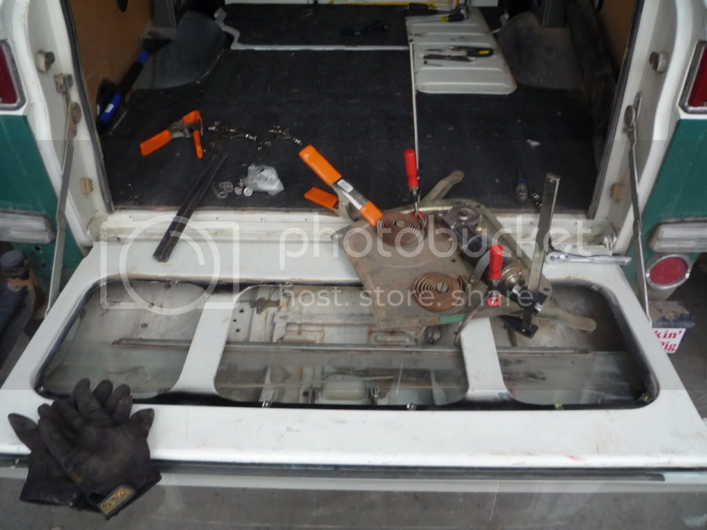

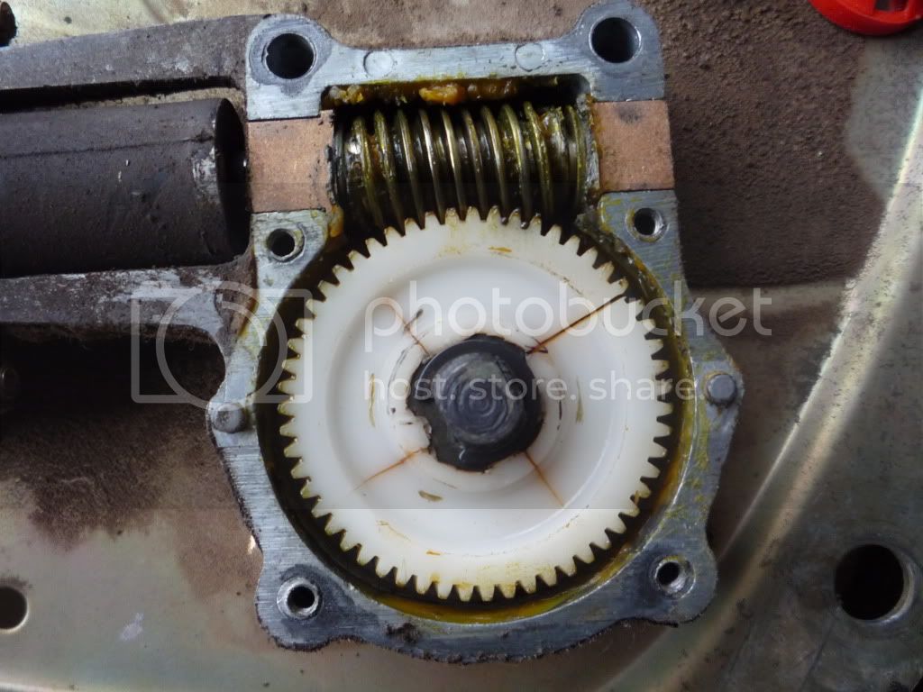

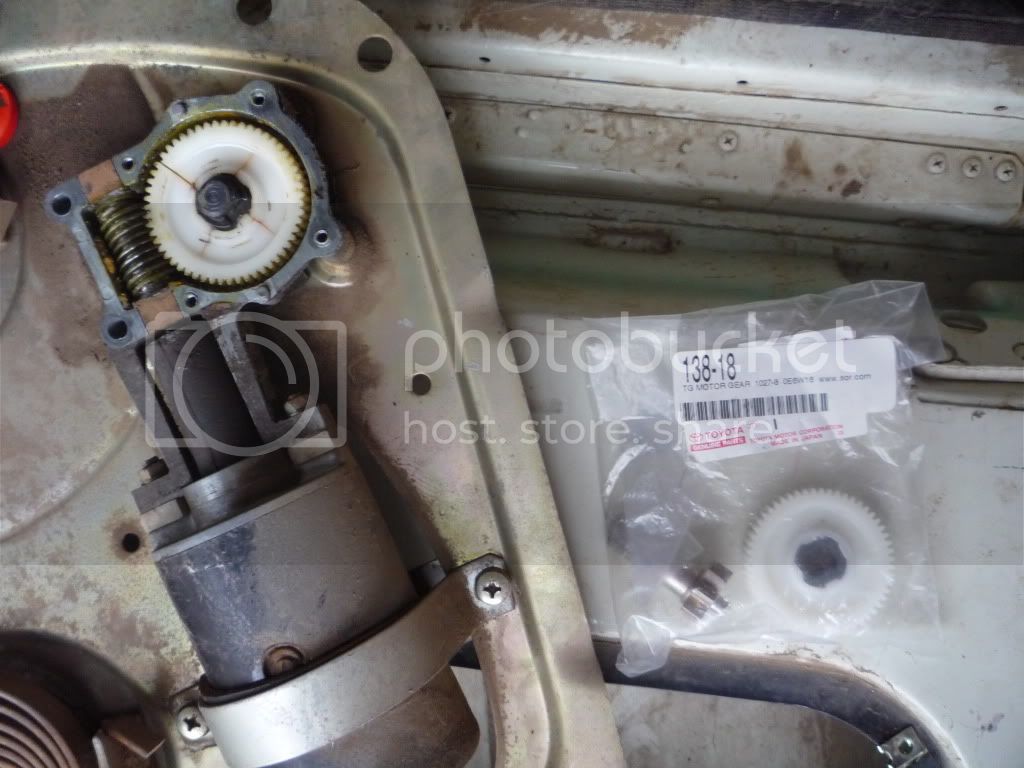

Can't remember if I mentioned before... the tailgate window decided to crap-out a couple days before McGrew this past July and has been stuck in the up position ever since. With the help of Gary's article in Toyota Trails I dug up from my stash, I was able to swap out the infamous plastic gear that typically breaks in everyone's tailgate. I had performed this task many moons ago on my Trail Pig when it crapped out, so I figured I could handle this too. I assumed it was mechanical and not electrical. Well I sorta guessed and lucked out. I'm not too bright when it comes to electrical. Sure enough, the plastic gear was split in half and about to grenade... :)
Anyhoo, its all buttoned up and works great now!

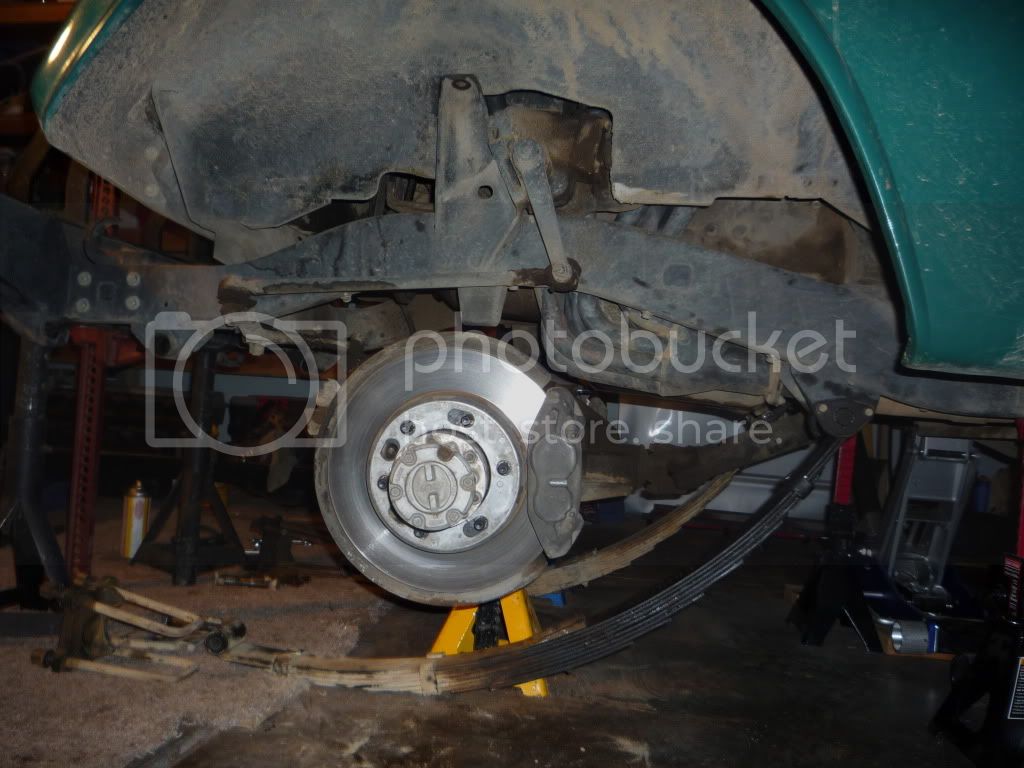

I disassembled the rear end on the Princess Pig and have PB Blasted everything for tomorrow's onslaught!
Saggy srings and old shocks are stripped form the rear end...
4" Extended SS braided brake lines will be installed tomorrow...
No air tools. It has not been bad at all actually. No real rust at all under this pig. High desert score! Everything has come off, thus far, quite easily. Let's hope that's the case tomorrow. :)

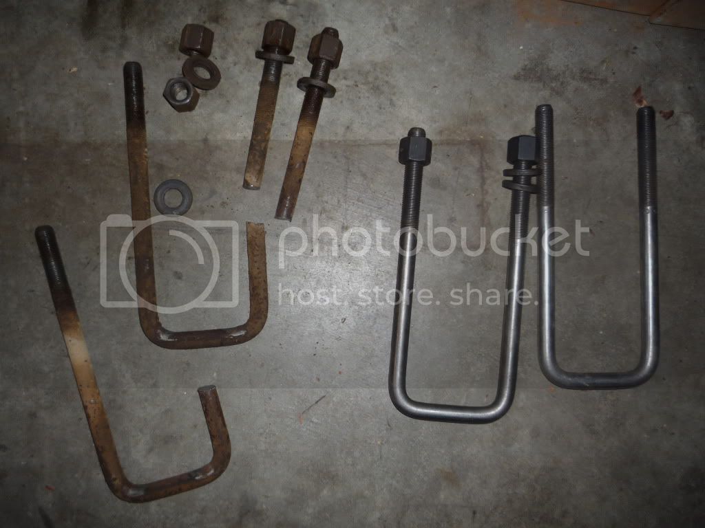

Wasn't too bad, just slow. One of the hurdles we had to deal with, a pair of U-bolts on the rear of my Trail Pig that would not budge. I actually had a spare so we sawzalled the old ones off after trying forever to free them.

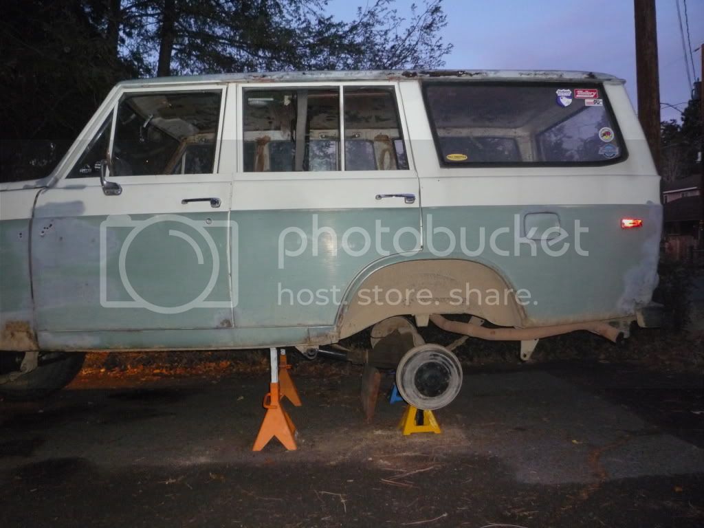

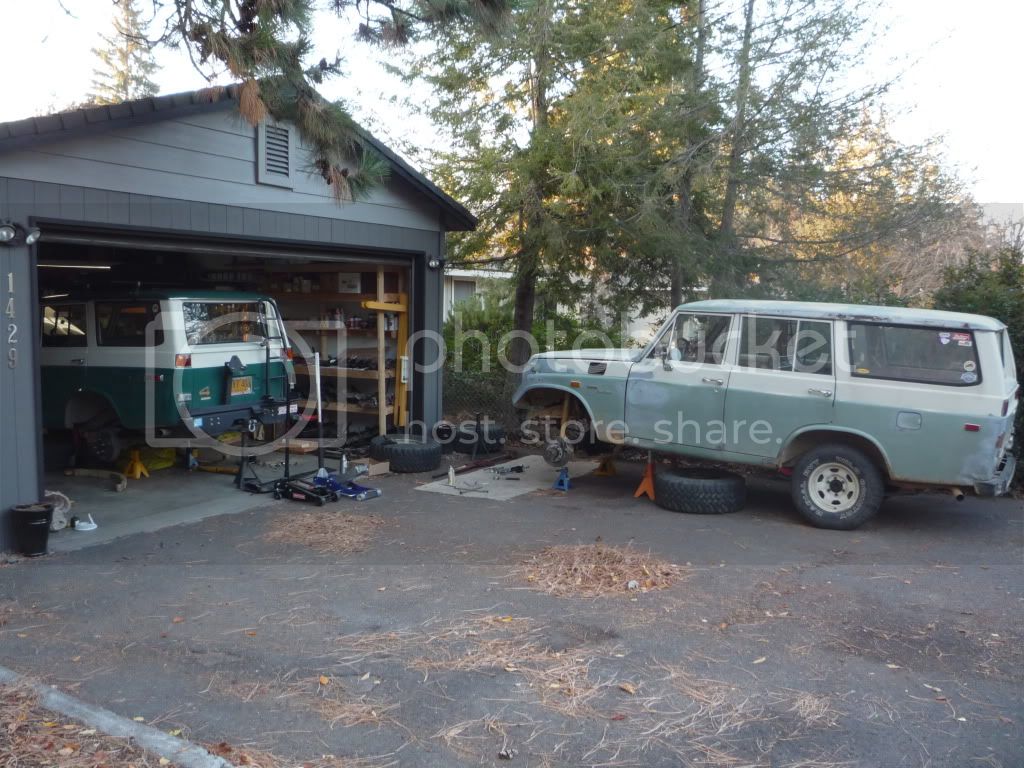

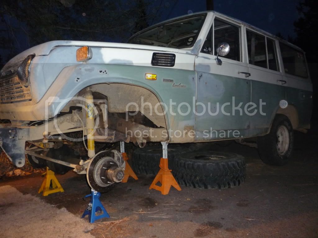

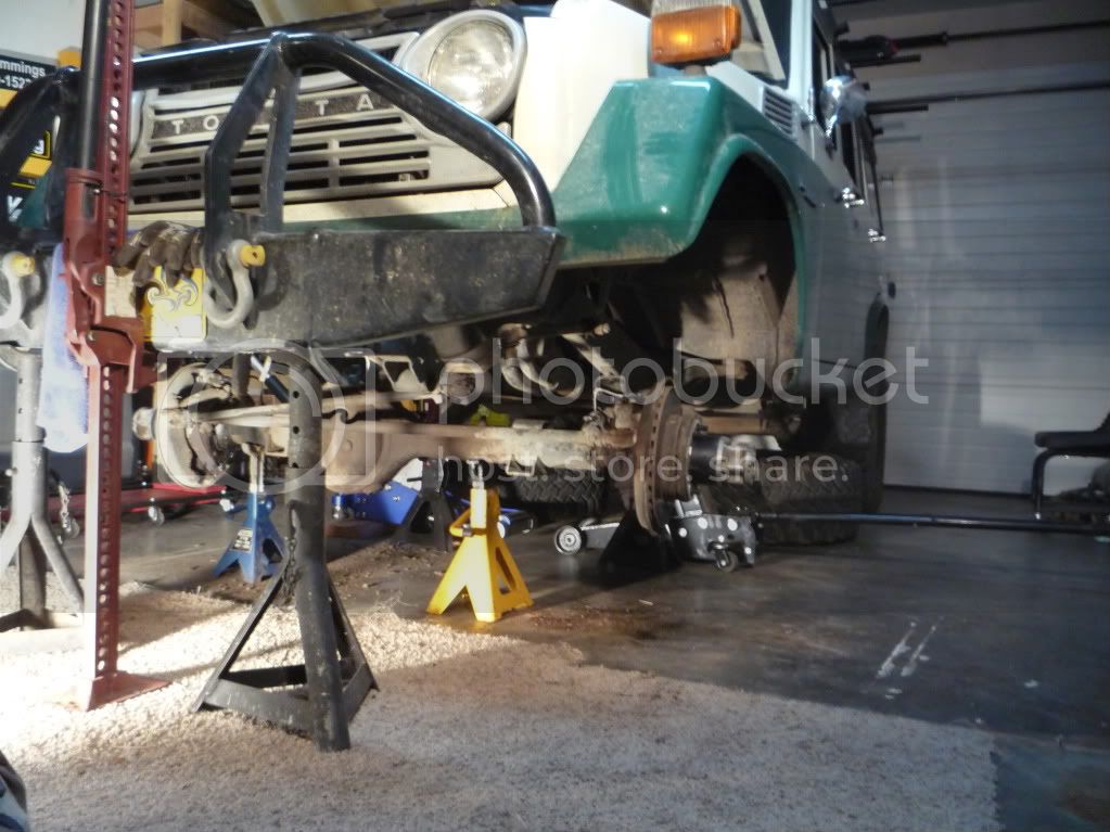

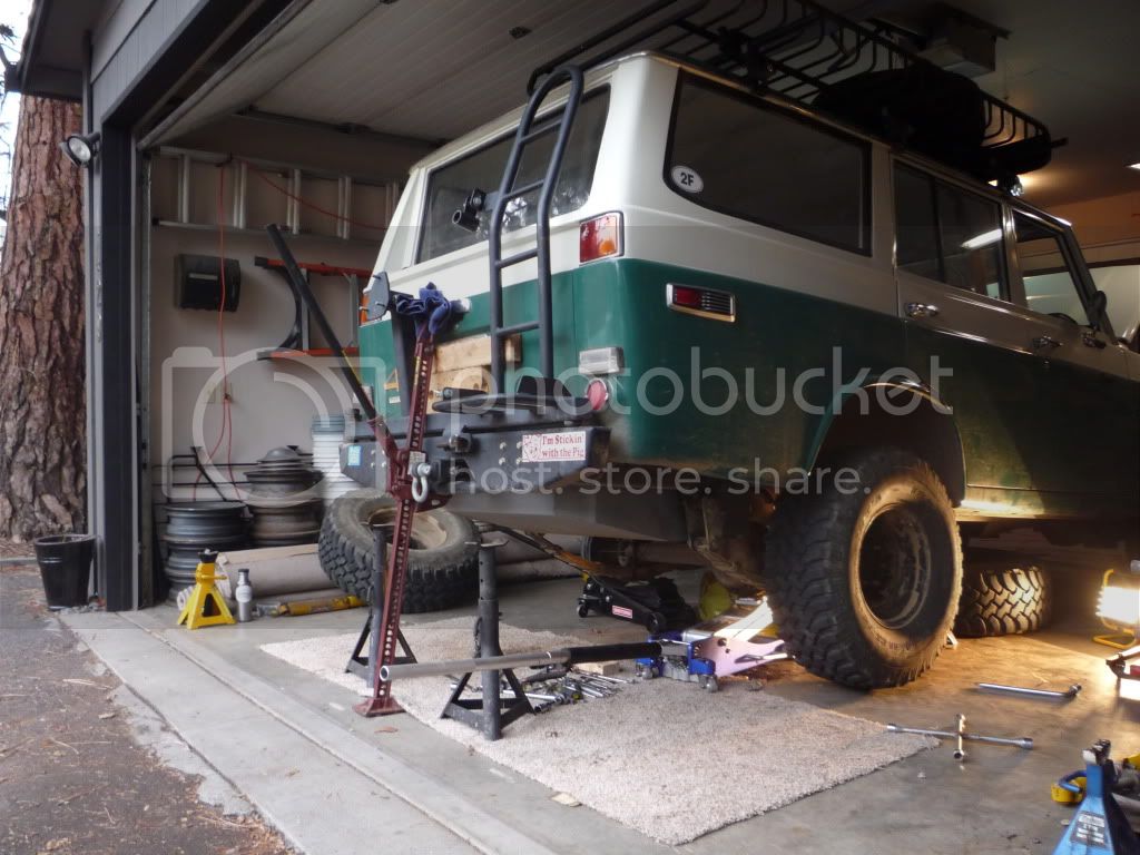

sorry if i sound like a sook but! shouldnt you be supporting the back of the pig?? those front axle stands look aweful far up the chassis there (acting like a fulcrum), i know most of the weight IS in the front of it. but id hate to see her turn into a see-saw....
You are probably right. Looks scary doesn't it! I usually have the tire/rims under the rig while I'm working on it but removed them overnight so they would not get stolen. Once I climb underneath again I'll toss the big 'ol tires underneath for a back up. I would like to have another jackstand under the rear bumper, but I ran out of 'em... I should probably at least toss a high-lift under the rear bumper.
Good point, and I don't want to get crushed. I'll toss something else under the back end. :)

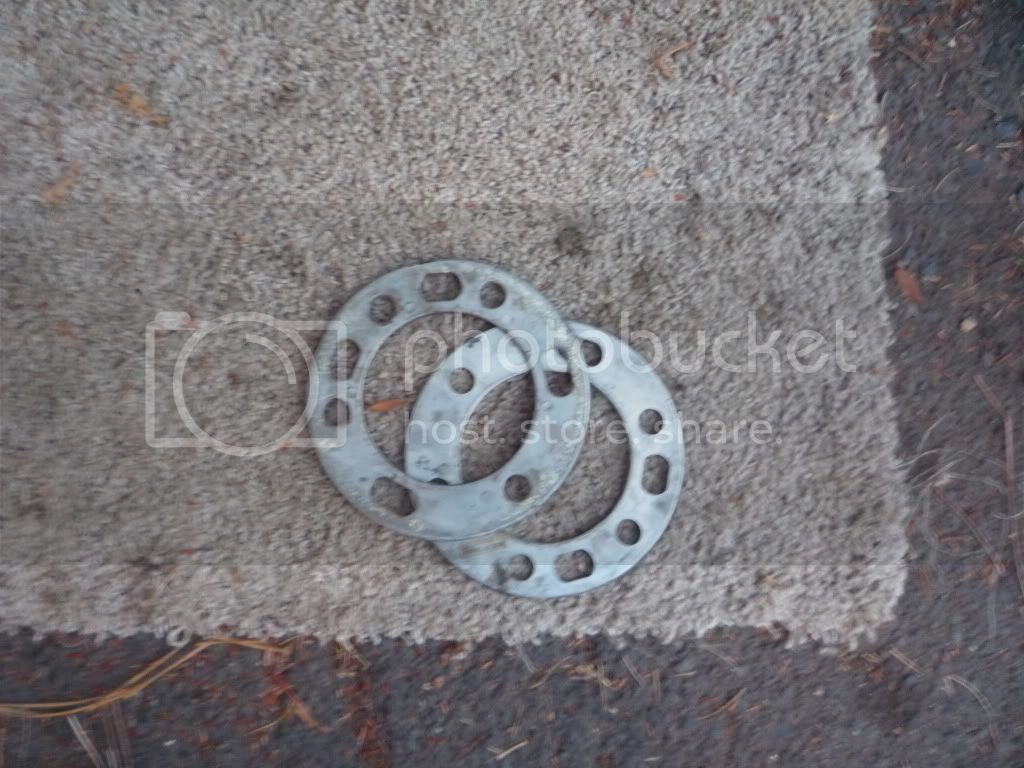

Interesting development. I paid a shop to originally install the 4" lift, OME shocks and stabilizer, and the u-bolt flip kit on my Trail Pig while they performed some other work years ago. When I pulled the two front tires off the Trail Pig today, I noticed someone had installed some 1/4 spacers behind the rims sometime in the past. I assume they were needed for clearance of the aftermarket front disc brakes and rims. Never knew they were there. I assume I will probably need them when I install the bigger tires and lift on the Princess Pig. I'll double check...
a big ol' stack o' tyres should do the trick! work safe :bounce:
(damn, workplace health and safety is infecting my personal life too! :flipoff2:)

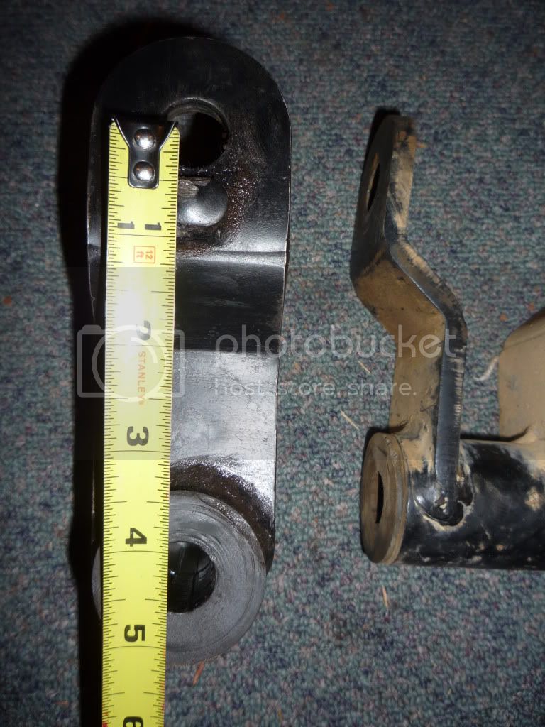

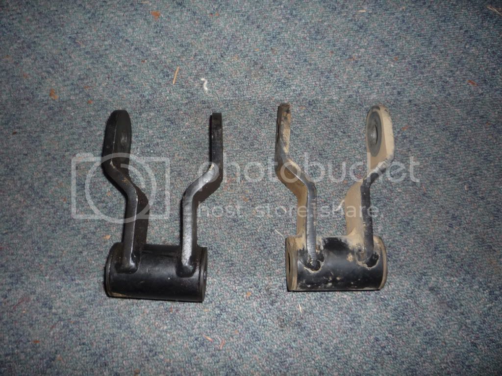

Here is a pic of the front shackles that were used with the shackle reversal on the Trail Pig that will not work when the springs are installed in the stock configuration.
I was hoping to find a pair of shackles online that would match my anti-inversion shackles used on the rear springs of this lift, but I can not find anyone that makes them. As in this pic here...

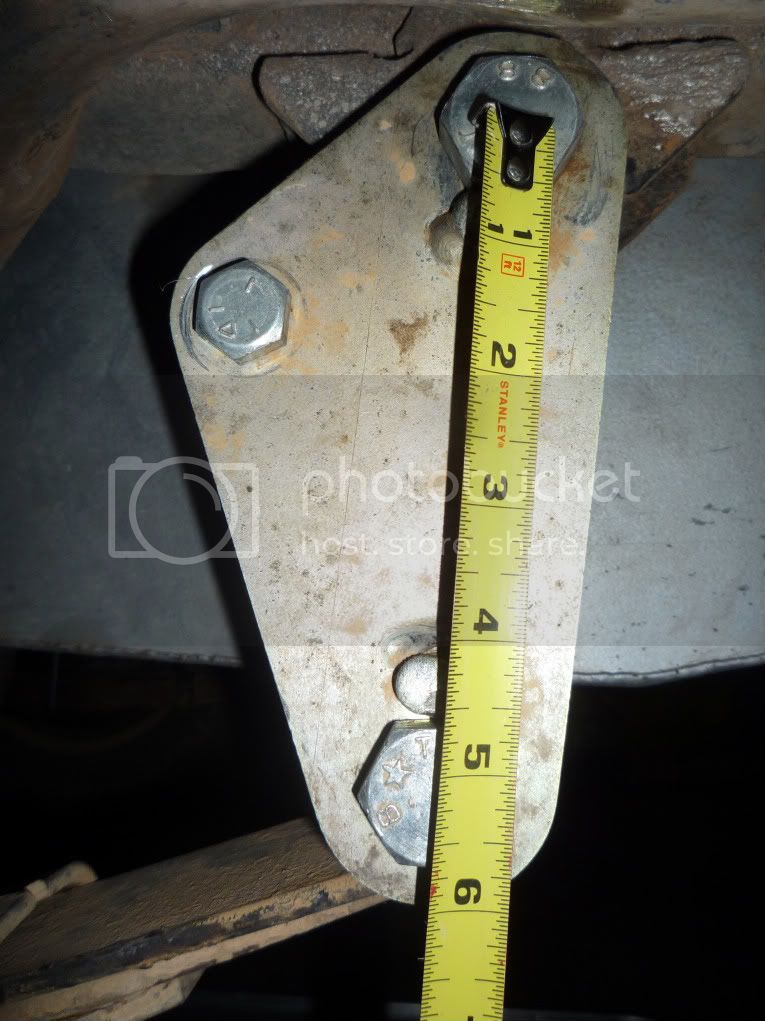

Here is a pic of the shackles I removed again along with a measurement. The tri-shackles (rear) are about 5 1/4" pin to pin and these (front) shackles are about 4 1/4". I think the front shackle reversal raises the front end about 1"- 1 1/2" so it would make sense that these shackles were slightly shorter, I think. I plan to make or buy some shackles that are the same length as the ones on the rear= 5 1/4" pin to pin.
