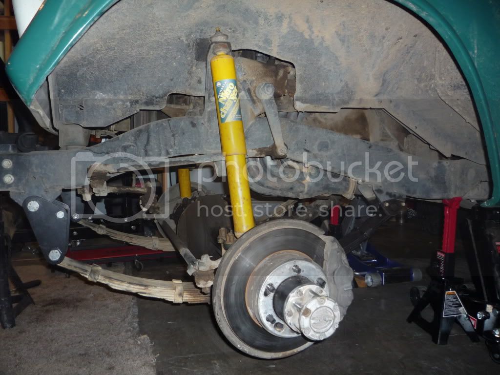

Got a little more done on the swap today. I was finally able to remove the last stubborn shock on the front end of the Princess. I also removed the two front shocks from the Trail Pig. I ended up installing the relocated rear shock mounts and then installed the rear shocks on the Princess Pig. I loosened all the nuts on both front driveshafts in order to swap the long travel front drivesahft into the Princess Pig. I am still not sure if I will be able to reuse the rear driveshaft as is. Still trying to figure that out...
Also installed the front springs after I spent the day prepping/painting the new shackles.

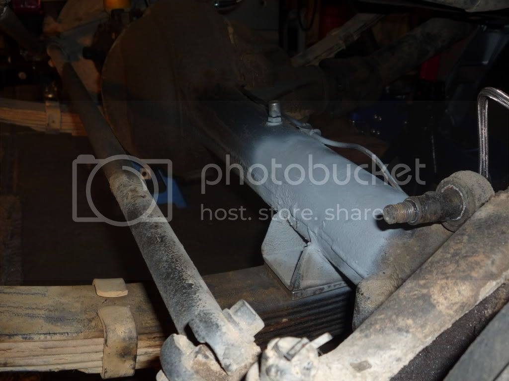

Last pic of the day. I was about to finish the u-bolt flip on the driverside front spring, but realized the top half of the perch on the axle had to go! I get to grind it off tomorrow. Yay.
The flip kit won't work with this in the way...
The pictured welded piece is not part of the spring perch.
It is a bumpstop extension that is tacked onto FJ55 frt axles.
Thanks for the clarification Jim! I appreciate it. Obviously, there is no worry if I remove it then, correct? The other rig had it removed as well. I will double-check bump stops after the lift is all set up and ready to flex. Cheers. :)
