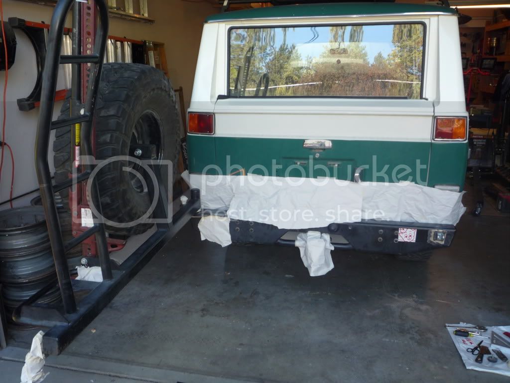

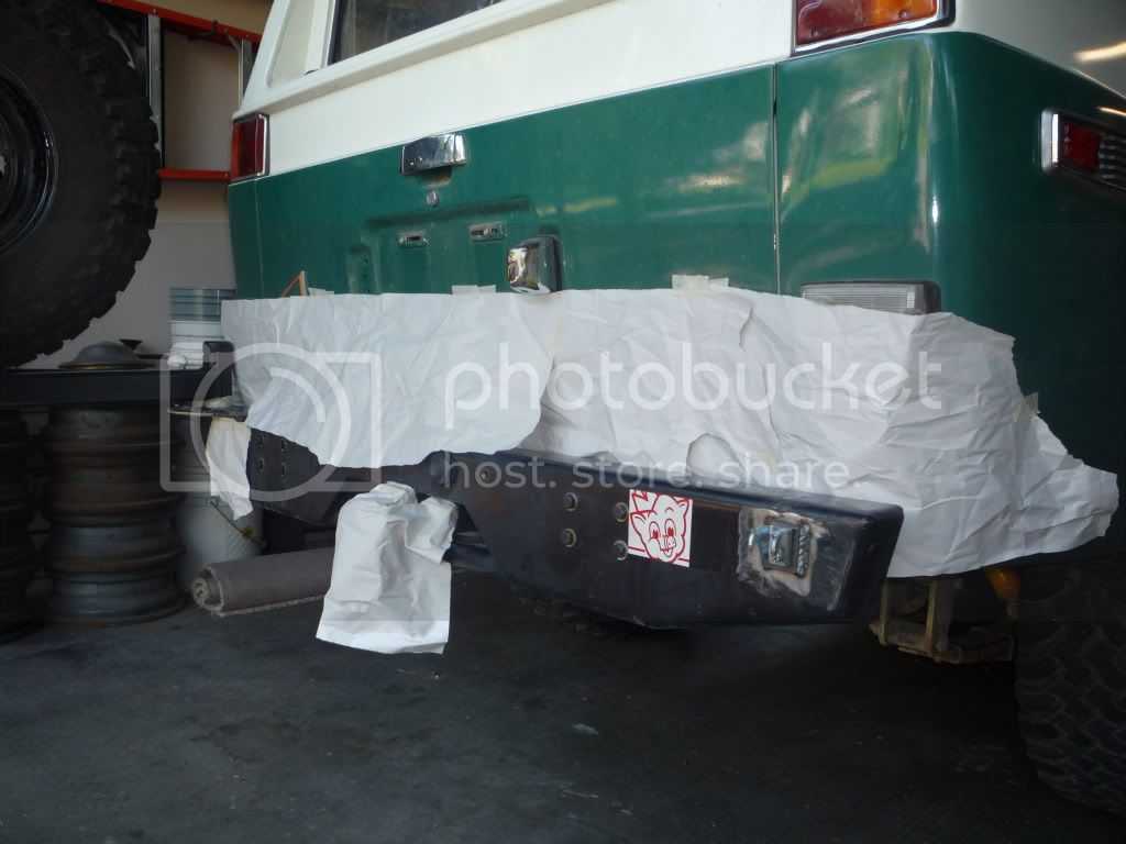

Finally finishing up the rear end/bumper. Installed right side rear reflector and license light. :) The left side reflector and light interferes with the bumper/spindle, unfortunately. Need to deal with that. :( Bought a spare and fit the Hi-Lift. Mocked it all up for the first time today. Plan to have a bracket fabbed/welded onto the tire carrier that holds a license plate bracket and light... soon.

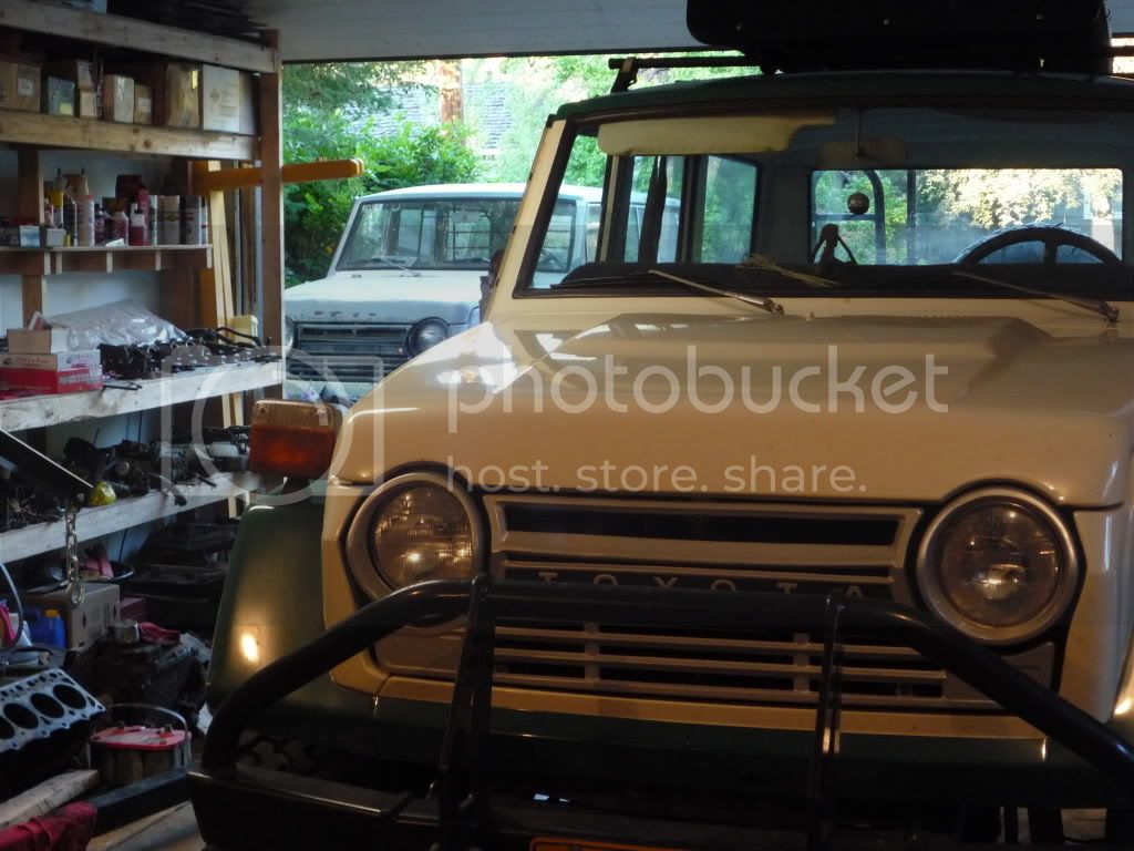

Pic of both pigs. Trail Pig is now a garage pig. I barely start it up anymore. I just don't seem to have the time to build both of 'em...

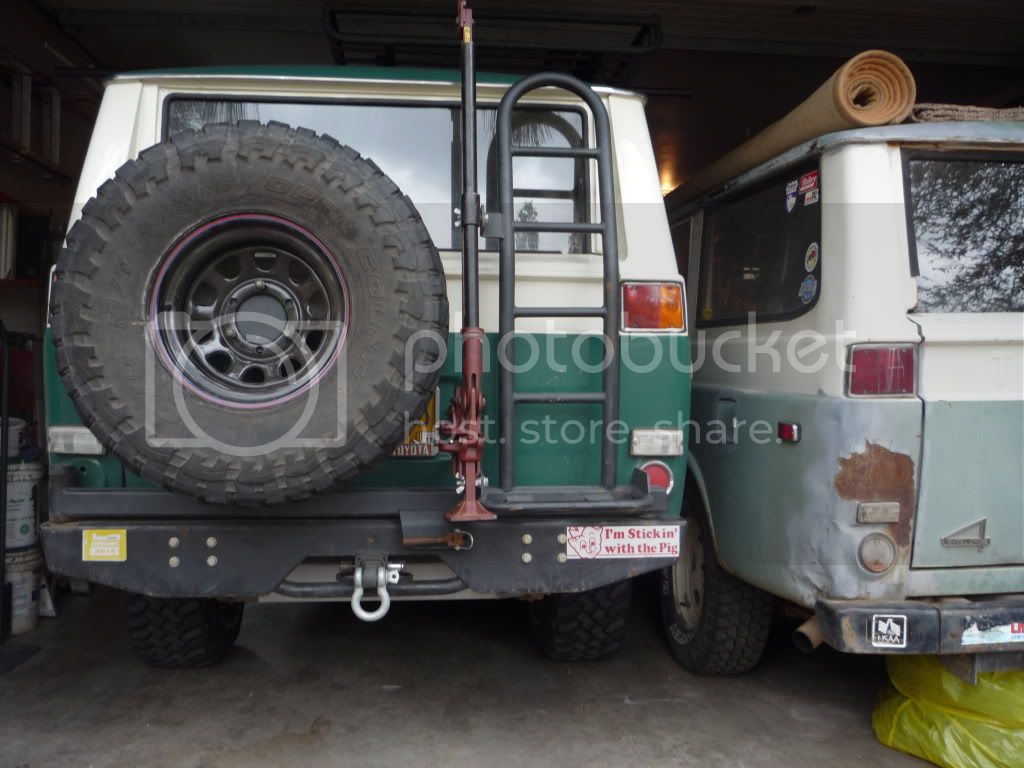

Also asked Graeme to build a bracket to mount the relocated license plate holder. It has a pull pin so its easily removable, , has a threaded stud to stop it from rattling, and has access for a lock to protect it and the spare. Still need to wire in the lights...
Rearend shot. :mrgreen:
Oh yeah, and the ARB compressor bracket/inner fender mount. Need to install and wire it...
Graeme also tack welded spacers on the inside of my bumper to give me 3/8" more room to mount both of my lower reflectors. Finishes off the rear nicely. He also welded in the studs for my rear lower shock mounts. I relocated the rear shocks higher and out of harms way because they used to hang down below the axle. However, they were double-nutted on and came loose often. Ever since I installed the lift, I have been wanting to get this one. Nothing like McGrew to get me to finally get stuff done on the pig.

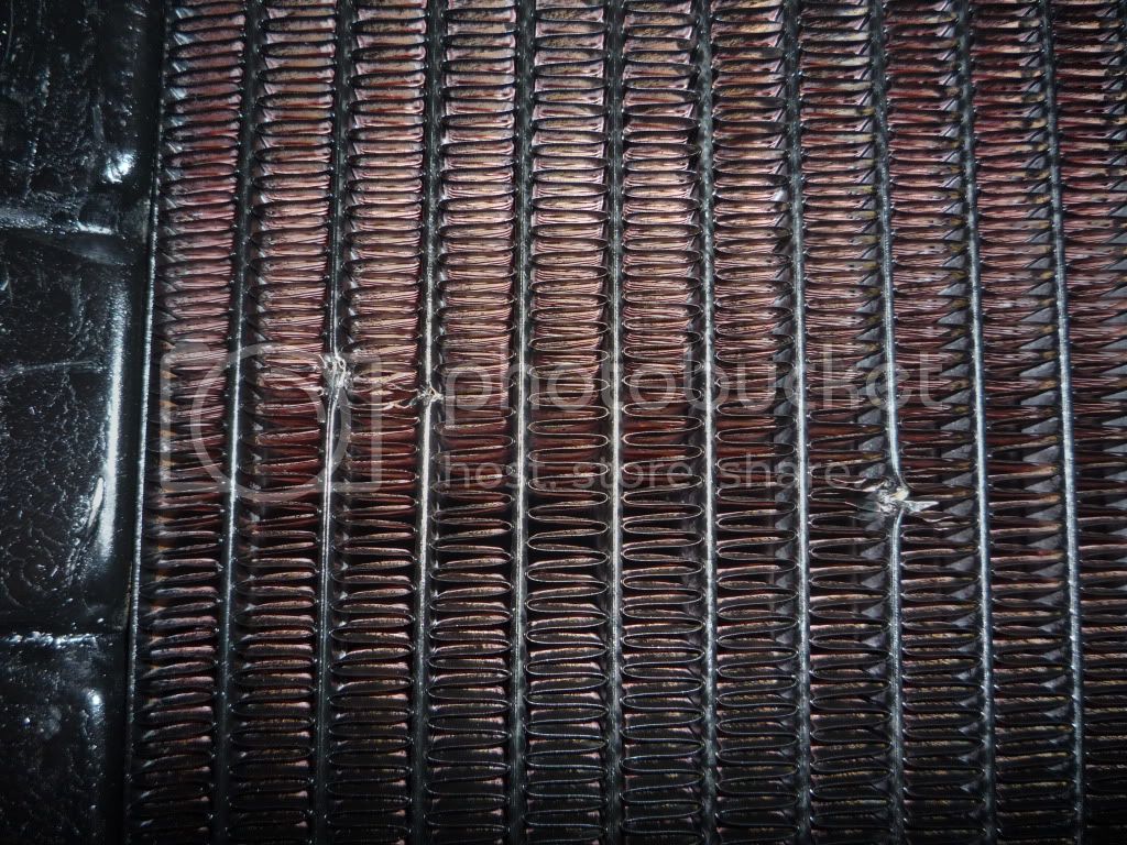

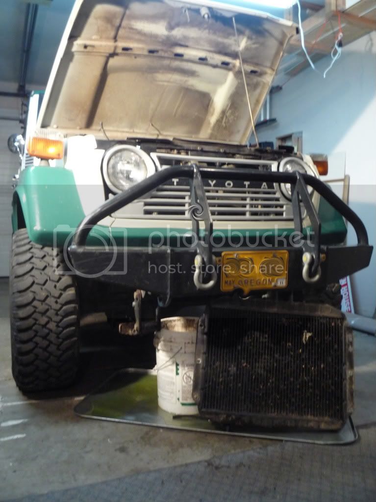

Drove the pig Sunday morning before McGrew for a shake down run, and it started to spew coolant. I stopped a couple times on my way out of town while driving up to the Edison trail system. I noticed the leak and assumed a hose or something simple had come loose. Things looked tight and it seemed to stop leaking when I was stopped. I was a little baffled...
We finally figured the radiator must have a leak in it. Anyhoo, things progressed throughout the day and the truck ran well, but a little hot. I dragged my radiator into the shop and the guy looked at it and said he was unable to save it, but he could re-core it. The header plate had burst at the seam and was un-repairable. So, I had to wait on the radiator to get finished so I could put the pig back together by the McGrewTrail Run.
Check out the beautiful butterfly and other interesting critters.
For those of you wondering, I did get my radiator fixed before McGrew.
I picked it up the first time the day before I was going to McGrew. I grabbed the radiator after work and finally got around to installing it later that night. It was late and I was having trouble installing the radiator. It did not want to fit, the bolt holes no longer lined up. So I decided to go ahead and take the drill to it to make the holes larger. Well, I let the drill skip across the new radiator and it nicked/damaged the new core. It was about midnight and I was freaking out. Finally went to bed.
Called the guy at the radiator shop as soon as they opened the next morning. He said to bring it right in. They fixed it for free and got it done quickly. I was stoked. I picked up the radiator the morning I was planning to head down for McGrew at about 10:00 AM. The radiator turned out great after the repair. I finally installed it and everything went smoothly.

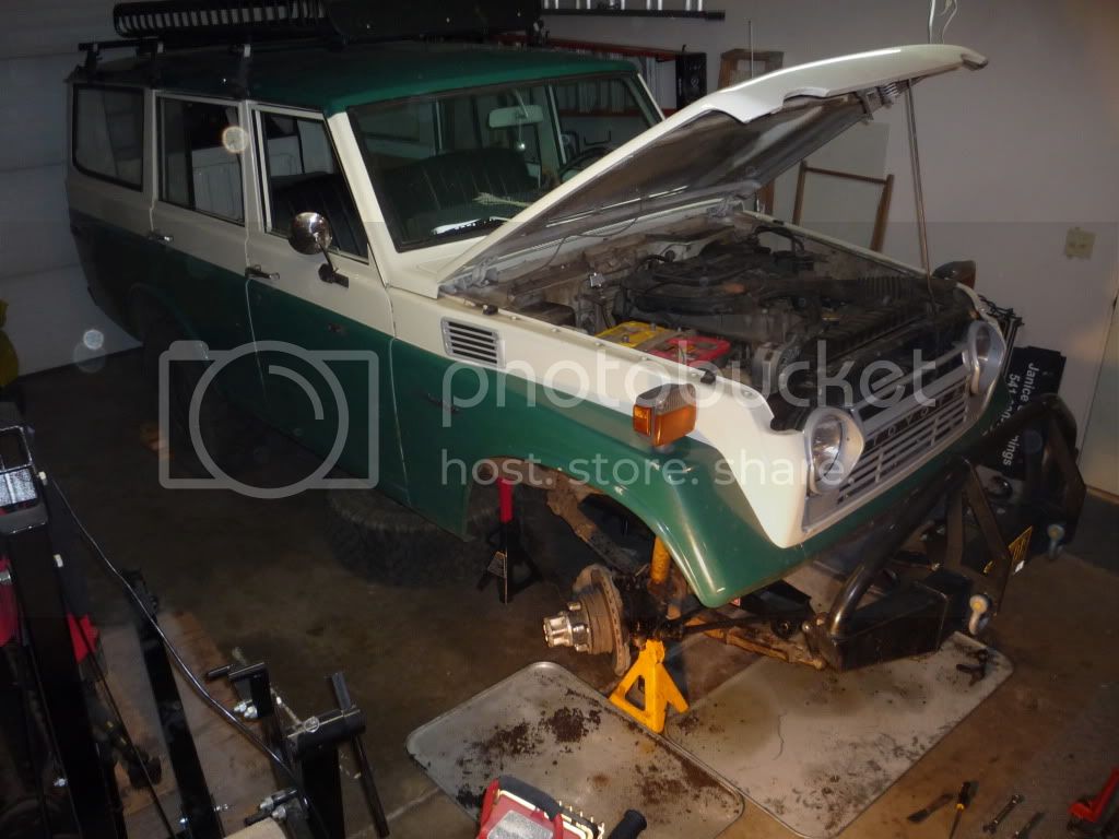

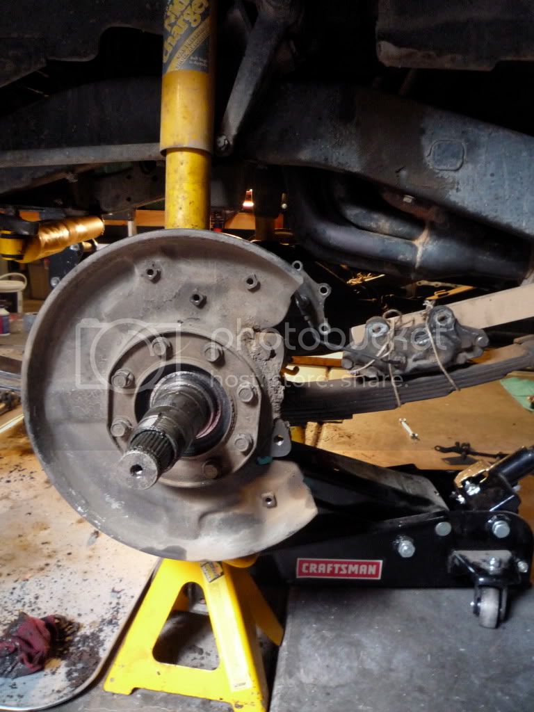

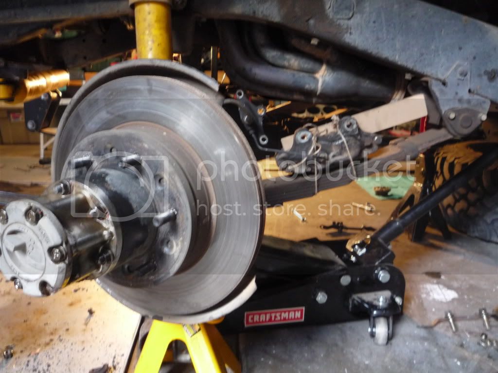

The Pig drove real well on the McGrew. The highway miles were not as bad as I had feared either. It really did quite well. However, I have been putting off some maintenance for a while. I have now gathered the parts/supplies needed to rebuild the steering, front brakes, front axle, and now the clutch master/slave cylinders.
My rig blew the slave cylinder the other day on the way home from work and I fortunately, literally coasted into the driveway after I was unable to put the truck in any gear. I have read that many folks recommend swapping both the clutch master and slave cylinders at the same time. So I'm doing that and upgrading to a SS braided line between 'em.

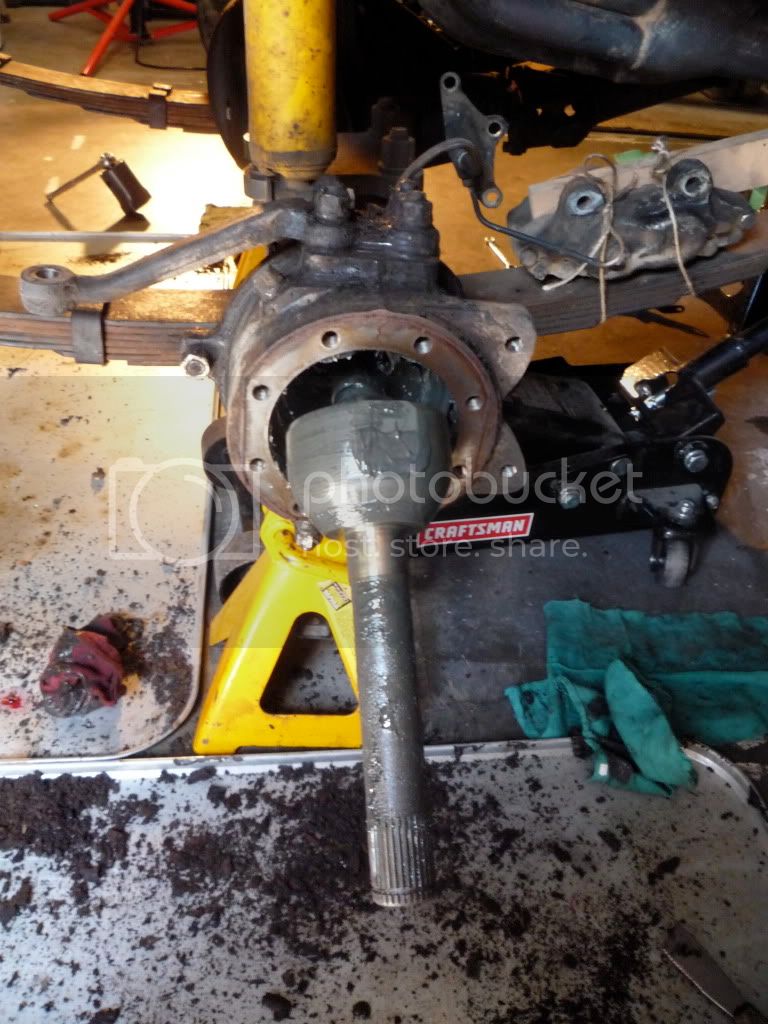

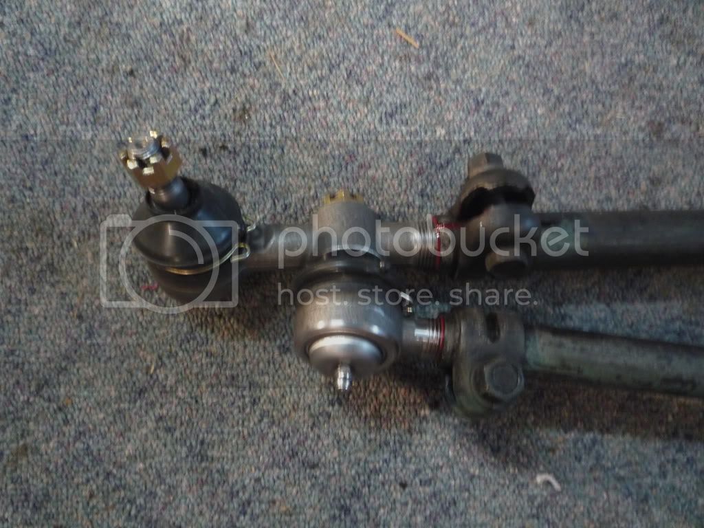

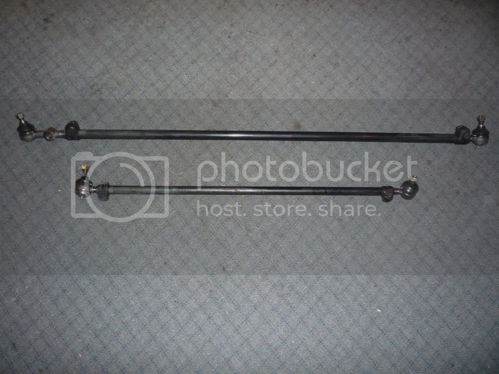

I am also replacing all four TRE's, the draglink (with TRE's), and rebuilding the center arm. I am rebuilding the entire front axle with new bearings (wheel and knuckle), seals, gaskets, etc.
I also have new pads and an install kit for the front brakes.
Still taking stuff apart! thumbup
