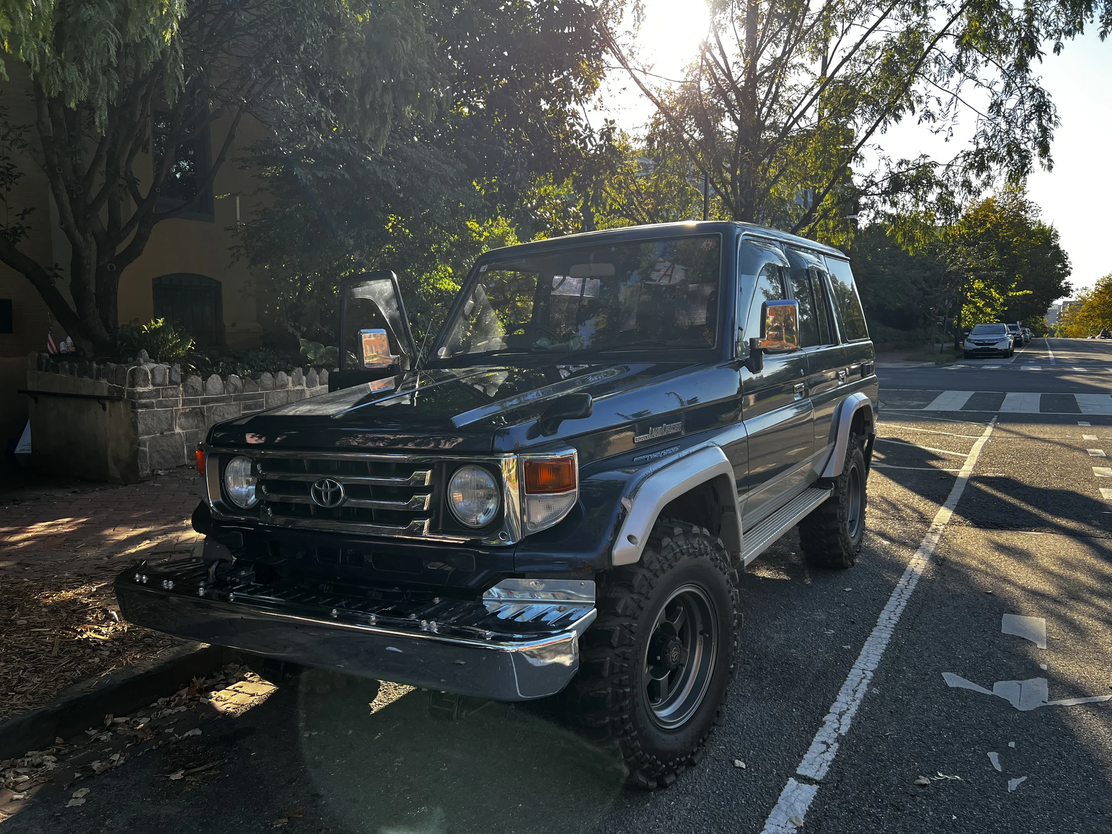

I just recently purchased a ‘95 HZJ77 and am absolutely over the moon. I try to keep normal maintenance items/wear items stocked up in my garage for all of my vehicles. I was planning to pick up engine air filters, oil filters, and fuel filters. Should I stock anything else? Also, feel free to share and wisdom on the platform as I’m here to learn! It’s my first diesel and first import.
Pic of the HZJ (in need of lots of body work love haha):

Thank you so much for the recommendations! Fortunately this cruiser had a very extensive service performed prior to arriving in the US a few months ago (which was a large reason I jumped on this):

Among others, I have the Japanese Toyota dealership bill and need to find a good translation service to verify what other minor things were done. I’m starting my logbook this week to properly document what services were done and when so that I may perform each service at the right interval! I’m very OCD about my records so I’ll do my best to maintain this well!
Regarding the parts availability, I was reading about those hit with large unexpected import bills this year and was worried I wouldn’t be able to get affordable parts, but you’re right! Called up my local US Toyota dealer and they had filters, o rings, even trim pieces and exterior valence parts! Partsouq was incredibly helpful with identifying what I needed to then go to the dealer to request them. Very happy with that!
Right now I’m just struggling to find where I can get new body panels in the US. I called Cruiser Outfitters based on the glowing reviews I found but they sadly told me that they don’t do body panels due to the space they take up and logistics in shipping.
I then found Land Cruiser Heaven in Maryland but couldn’t reach them yesterday (I’ll leave an email today if I don’t catch them on the phone again). Any recommendations on other places I should check out that can get body panels to me in the US?

Thank you for the cautionary statement; I did some digging and just went ahead and purchased a rocker panel to start from a different online retailer with good reviews. I haven’t welded in years so I’ll be in for a treat I’m sure. Every project needs a learning experience, I’ll be having plenty with this!

Incredibly helpful, thank you so much! I’ll reach out to my local dealer to see what they can get a hold of for me and will keep an eye out for 76 series panels while I look. I appreciate it!
I have gotten rust repair panels from an Australian outfit called Cruiser Utes and Parts. They have a crap ton of stuff for cruisers of all ages and will ship to the US at not-insane prices. Some new, some used take offs, but if you can't find it anywhere else it's a workable option. Beats looking through at the creek through a hole in the floor.
Thank you all! This is incredibly helpful, I appreciate all of the guidance. I will keep all of these places in mind as I move forward. I plan to do some frame cleanup soon and will start pulling interior pieces to see how much needs to be cut and replaced. It’s far better to have an OEM piece of shaped metal to work with to patch in rather than try to make my own, so I’ll be looking around at the options as I assess the extent of what I need!
