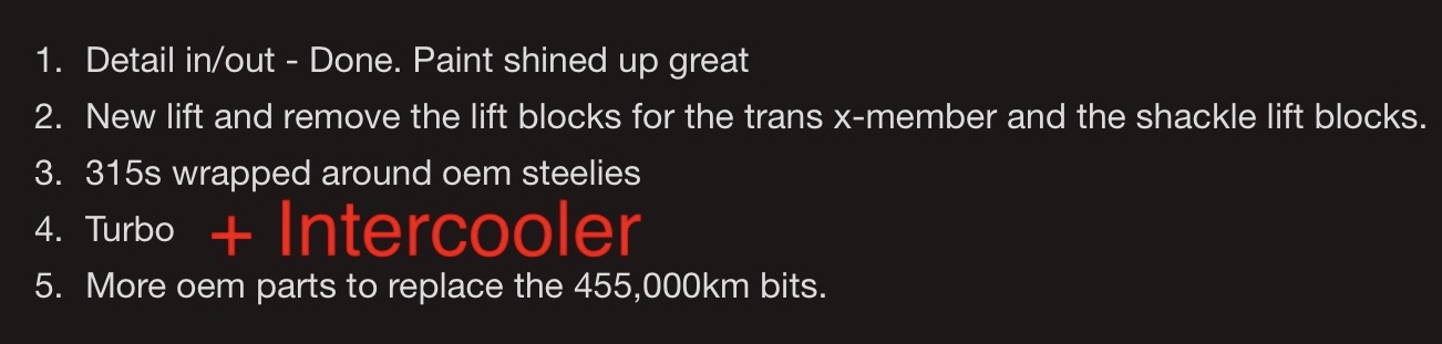

Like anything else I work on, I'm pretty bland. Lift, wheels and tires and some other misc bits. So once the weather cools down and the garage opens up it'll be getting...
  1. Detail in/out - Done. Paint shined up great
  2. New lift and remove the lift blocks for the trans x-member and the shackle lift blocks.
  3. 315s wrapped around oem steelies
  4. Turbo
  5. More oem parts to replace the 455,000km bits.

Haha yes - intercooler and 3" exhaust. Taking donations for that.

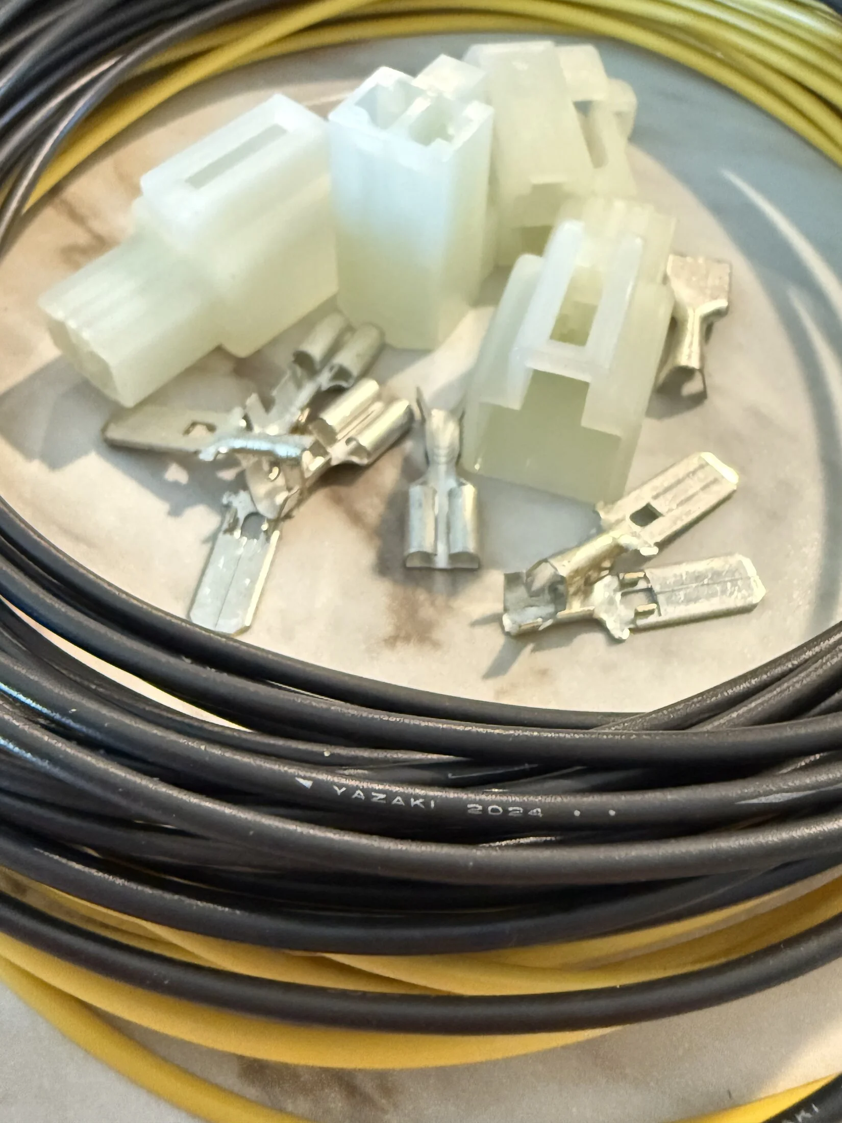

Also whipped up a fog lamp harness to use the OEM wiring....which for anyone curious, you must use the Prado wiring diagram for a HZJ77 as it doesn't match the 70/71/73/75 diagrams, its ever so slightly different. That said, easily made with some terminals and voila, works off the OEM switch. The terminals in the engine bay are also different and waiting for those to arrive, 90980-10256/55 are long gone so I had to give it a go from Yazaki.

More wiring bits arrived so I can build my fog harness in style. The -10256/-10255 male/female connectors are gone from Toyota but Yazaki still sells them so I was able to get these and about 200ft of spare Yazaki wire to whip it up this weekend.
OEM Toyota on the left and Yazaki on right - only difference is the locking insert, which looks cool but doesn’t do much as the housing uses tangs and the terminals are tang-less.
