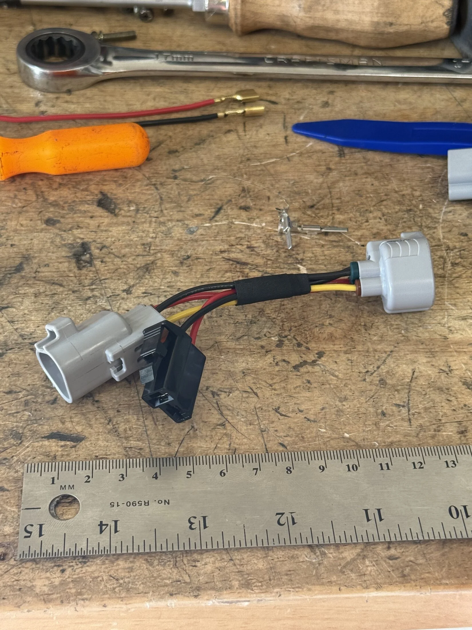

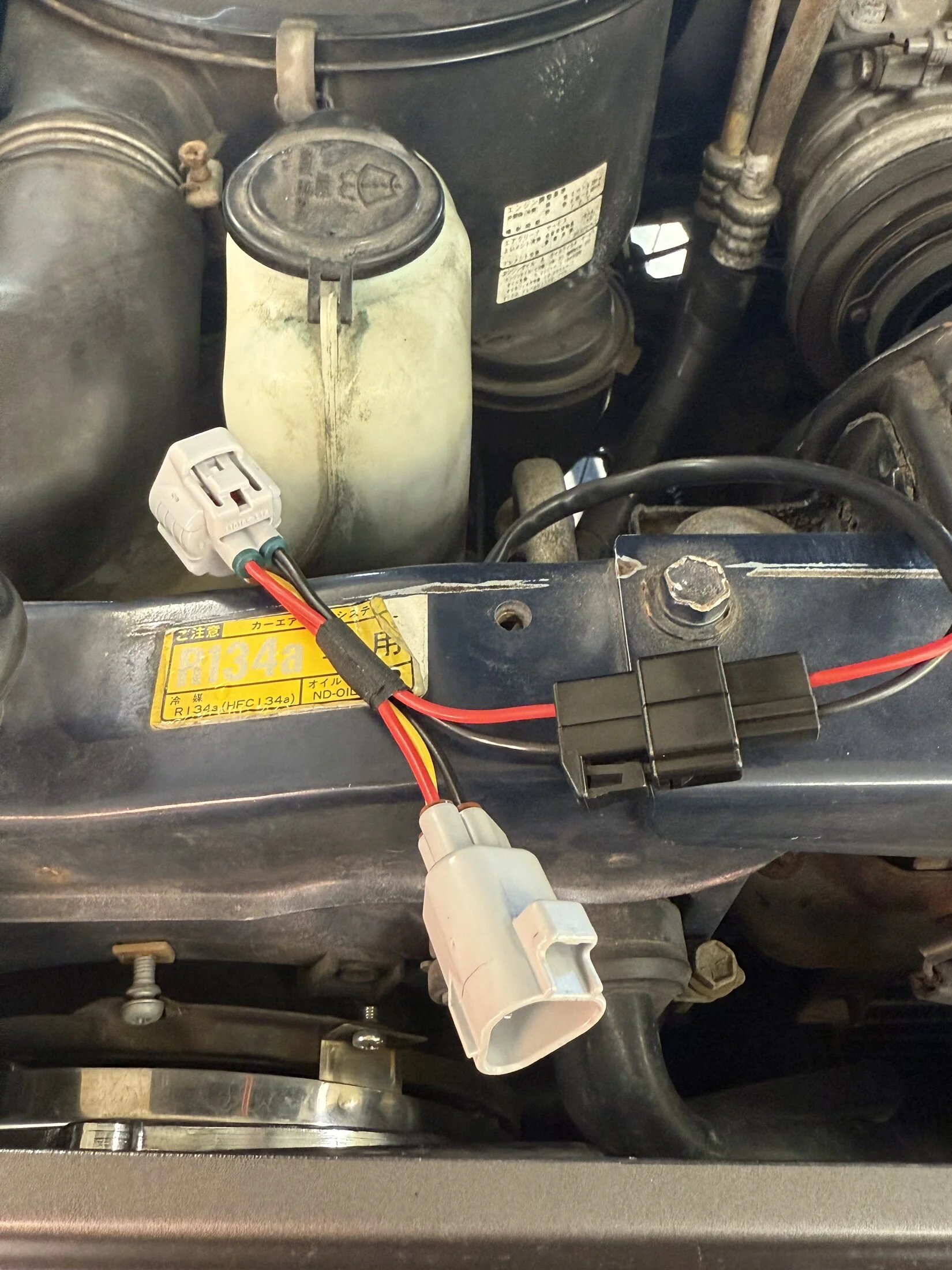

Turn signal harness adapters worked out great.
