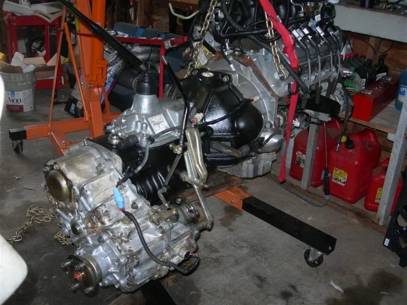

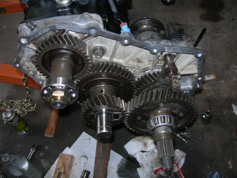

Here's the latest... got the transfer case rebuilt and on the trans. replaced all the bearings with a kit from MAF. I think it turned out nice, it took a few nights to get it all clean and put back together. I also ended up heli coiling most of the threads in the block... which meant taking everything off and putting it back on again. the 3/8" bolts take a lot of torque in that soft cast iron... I'd just go ahead and heli coil the threads in the block before putting the bellhousing on the next time.

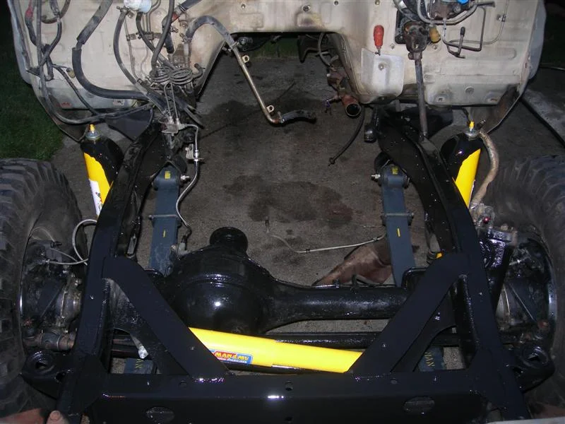

I just finished torching off the old mounts, grinding the welds down, and knocking the rust off of th efront end to get it ready for a good layer of Tennessee Chrome. Looks nice, and is ready for the test fit of the new motor and motor mounts tomorrow. I am excited about getting it in there finally. tomorrow is a big day :) :)

heres a shot of everything painted.. I went ahead and painted it before doing the mounts for the new motor because i didn't want it to rust more in between days. (been hot and rainy here finally) i'l just touch it up where i weld it tomorrow. Also is a shot of the transfer case. put sealant on all the bolt threads that break through the case into the oily parts and put silicone on the splines before bolting up the yokes to avoid any leaks there.

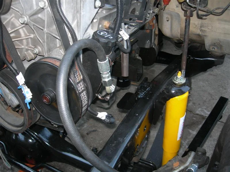

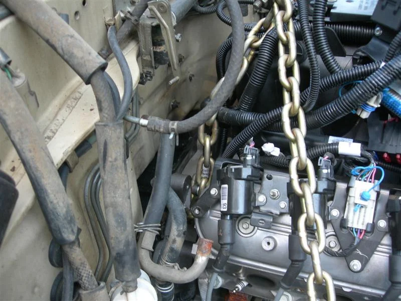

pulled the rearend out to get it to the rearend guy amd got the motor all bolted down. started to fit the left header and ran into the same problems as iantscared did and ended up having to readjust the left front header tube. also included a bunch of shot of engine placement for reference. I got it as high and to the lft as i could without hitting a bunch of stuff. basically cut 1 inch of the left mount and used the second hole. on the right mount i used the last hole and had to add about 1/2" of spacers to fill the gap. Don't laugh at my welds... it's been a while.

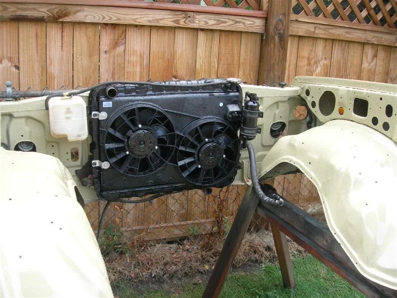

got a lot more done this weekend. Fornt and rear driveshafts back in, rebuilt diff in (thanks cameron for the gaskets), fuel pump mounted, throttle cable hooked up (used a lokar cable and the same help pack from automoan that iantscared did), and got the front end painted and back on.

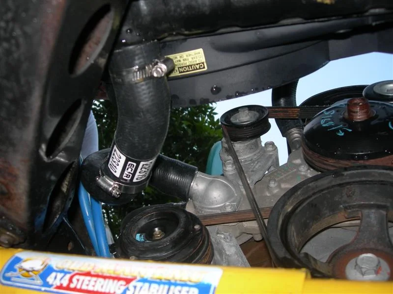

here are some pics... check out the radiator hoses. pretty cool, they fit. My brother spent a while at the parts store searching for the ones the would fit and look like stock.
Also, the radiator and contour fans mounted. another cruiser gets contour fans..

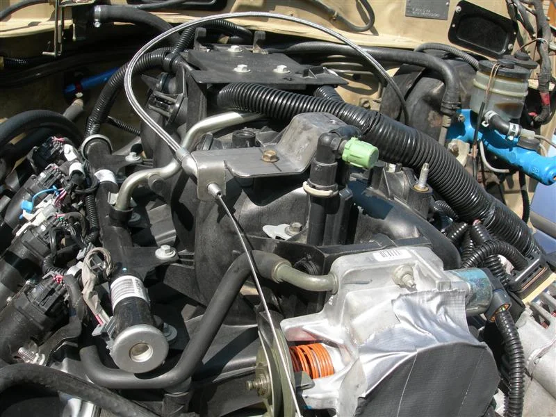

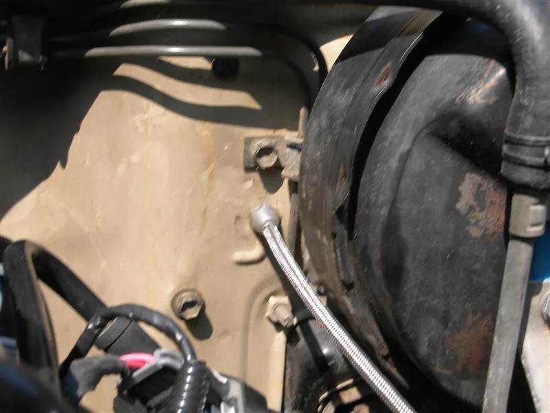

ALso a shot of the exit of the throttle cable int he firewall, and a bracket that i had to make since my motor was originally a drive by wire that i changed.

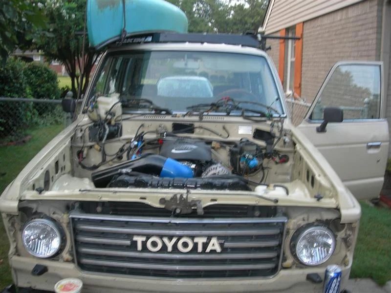

got it to turn over tonight before dinner. motor is going to sound great.
tomorrow it's off to go get a few more -6 An fittings so I can finish the fuel system and actually hear it run.
