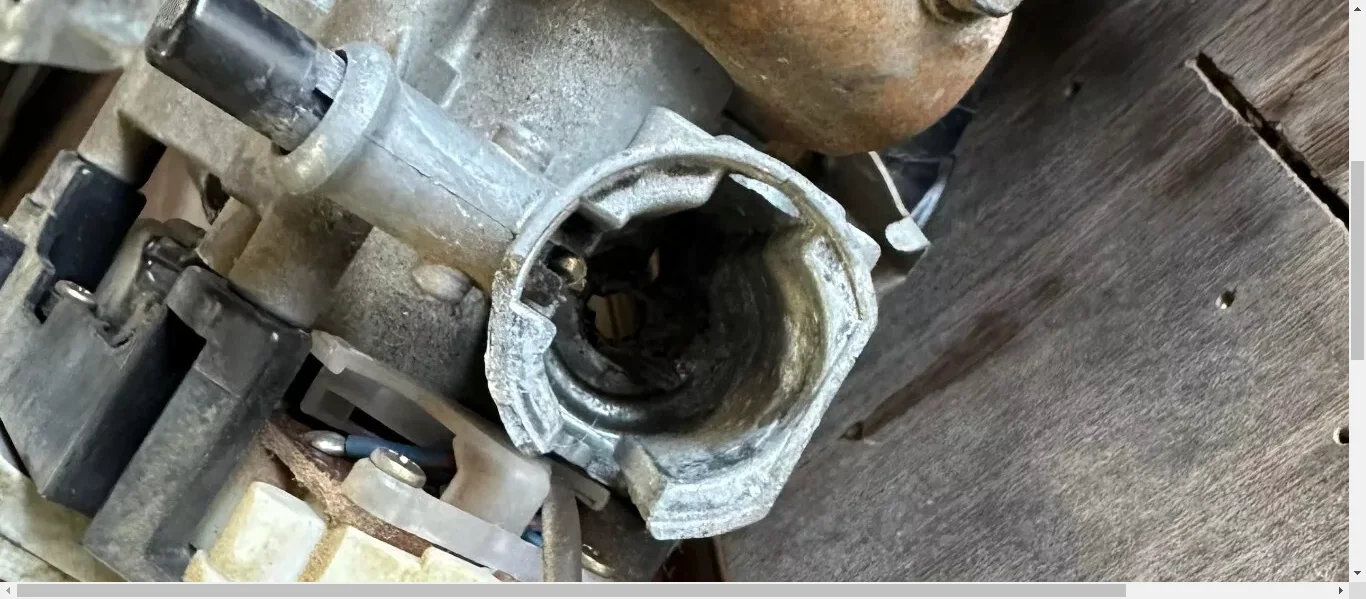

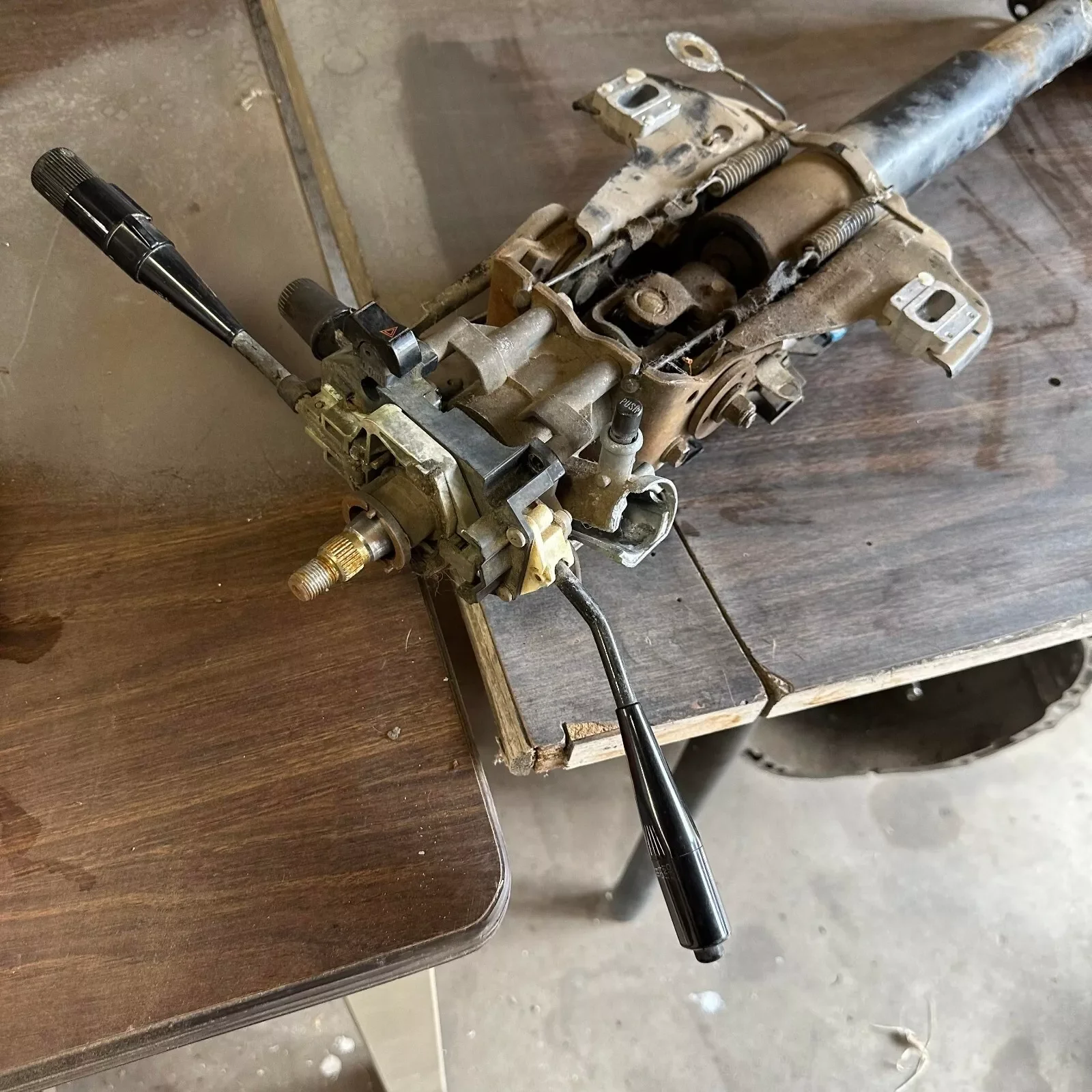

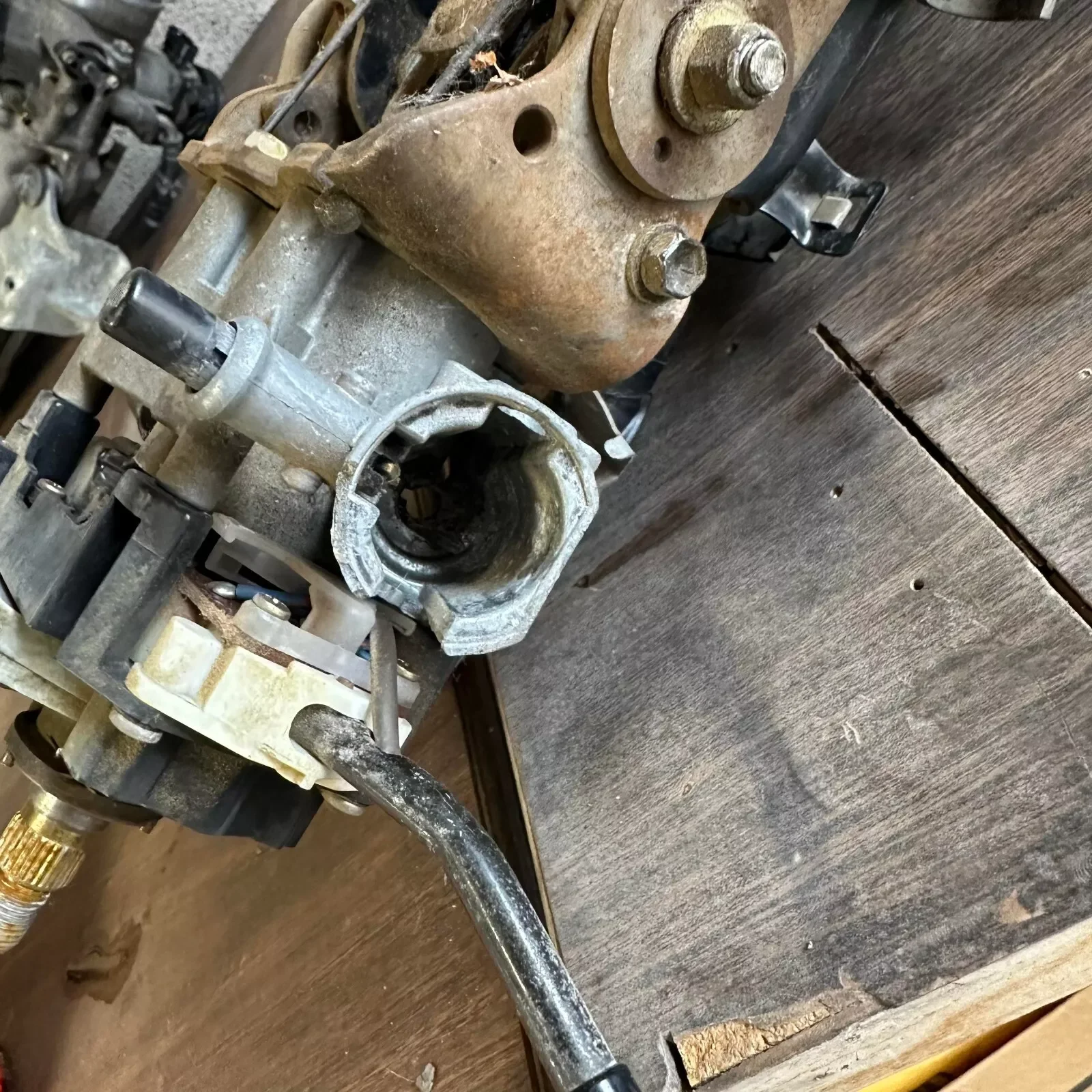

Have some issues with my steering column on my 60.. There is a 62 column for sale locally ... are they interchangable ??
To my understanding, the mechanicals are the same, however I believe the ignition switch and wiring harness is not the same.
Yes, they are interchangeable. My ‘85 Fj60 has a ‘88 FJ62 column in it and my Dad’s ‘86 Fj60 has a 62 column also.
Yes, the switches are different but they can be swapped between the columns.Aren’t the switches different?
